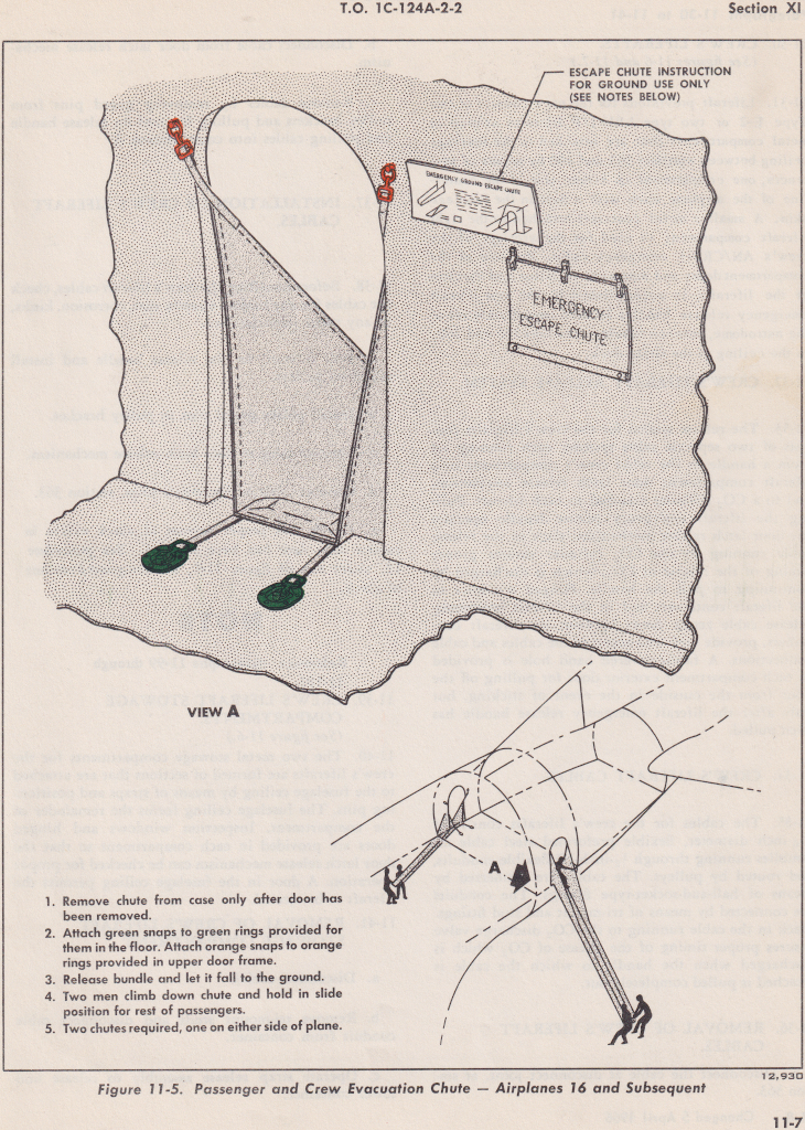

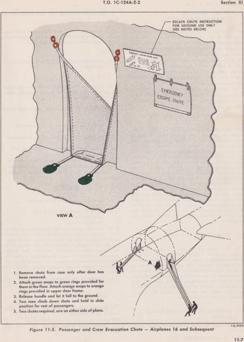

EDIT (26-03-02): The C-124 had fabric escape slides:
TO 1C-124A-2-2, 19 November 1969, Page 11-6 (Cropped, Reduced).png [ 1.34 MiB | Viewed 3347 times ]
TO 1C-124A-2-2, Unknown Date, Page 11-7 (Cropped, Reduced).png [ 1.44 MiB | Viewed 3347 times ]
(Source: Technical Manual, Maintenance Instructions: Ground Handling, Servicing, and Airframe Maintenance: USAF Series C-124A and C-124C Aircraft, Change 21, T.O. 1C-124A-2-2 (1972), 11-6-11-7.)
