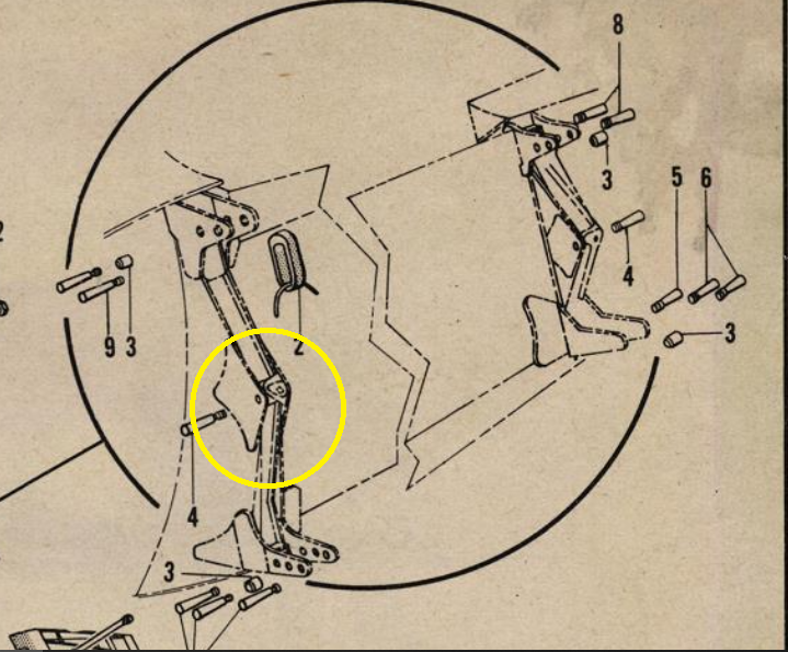

Matt, can you share what the damage was? There has been very little information.

there was a crack on a web gusset between the upper and lower spars at the wing butt. the drawing is the fuselage side, it is the opposite side that cracked. apparently it is a known issue and has been found on other 17s. This was unusual as Aluminum Overcast had never served as a fire bomber.
