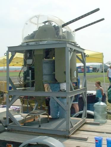

About a dozen or so years ago I restored much of a Martin 250 to display condition. Able to be cranked around by hand, I seem to recall two reasons why the owners didn't want it completely powered up:
a) They didn't want small fingers and such getting caught in any gears, and
b) The amplidynes only had a service life of around 20-25 hours.
Am I remembering those times correctly? The turret designers were doing some pioneering work with small amplidynes. Having them fry on a regular basis might be a real headache (and possible fire risk for a flyable aircraft?). Anybody familiar enough to comment further?

Mike: The turret I worked on was for the Wisconsin Wing of the CAF. It was to eventually get mounted in their Harpoon project, and for years was hauled around on a trailer as a display.
The amplidyne issue keeps floating around in my head. They are, of course, necessary in a flyable aircraft to compensate for the extra load everytime the gun barrels swing out into the slipstream. But on a ground display turret they really wouldn't be necessary, now would they?
Hmmm....
PostPosted: Tue Jun 27, 2006 8:53 pm
Posts: 484
to the best of my knowledge an amplidyne would be neccessary on an aircraft due to weight and practicality concerns. a huge battery bank would be needed to generate enough current to keep those turrets moving at top speed on demand. not to mention the power that the generators required to charge the batteries would rob from the engines at the most crucial of moments. for those laymen out there an amlidyne is basically a high output dc generator. they had a very high current multiplication ability and were usually driven by a smaller electric motor. i would imagine that they could have also been driven hydraulically as well. batteries would also wear out very quickly in a turret application. especially using 1940s battery technology. on the ground however i would think that a high output dc welding machine would probably do the job quite nicely. this could be powered by almost any type of prime mover or land power source. please correct me if im wrong but i think that this just about sums it up. cheers sim.
