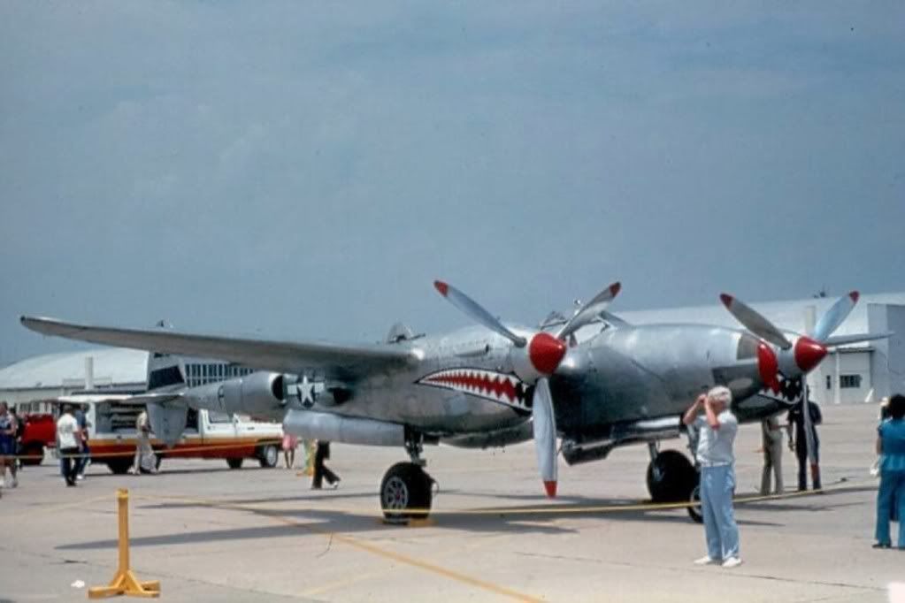

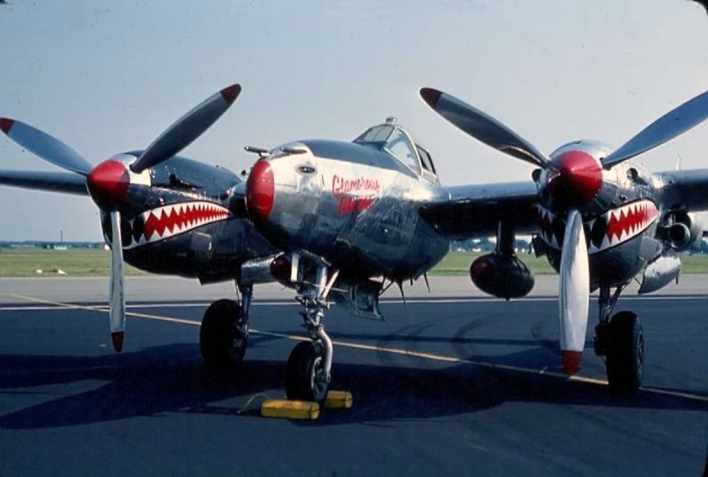

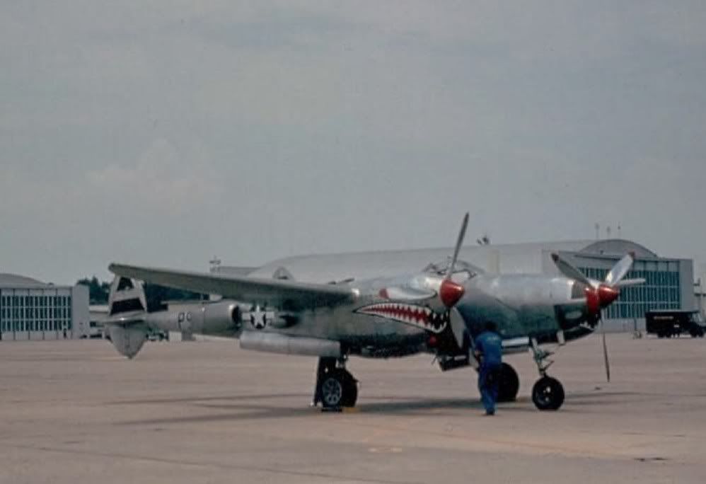

Posts: 528
Above are three photos of N3500 from my collection 1 & 2 at Eglin AFB, FL, 1978 by Bill Thomas. 3 at Langley AFB,
VA (one or two days before the crash) by Bob Burns.
