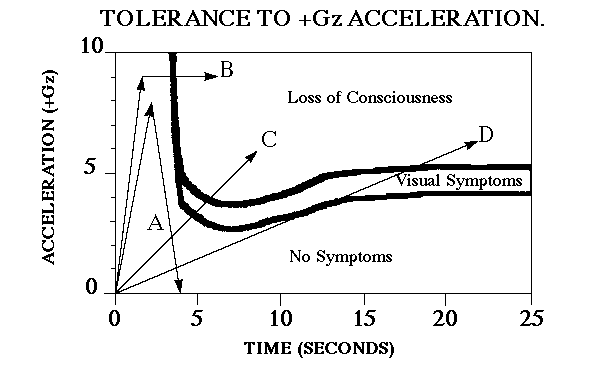

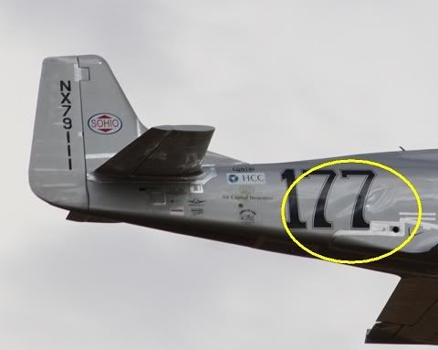

Sun Sep 18, 2011 2:16 am
I feel pretty sure that much beyond three or four seconds, the pilot was G-LOCd and probably out of control of the aircraft for the remainder of flight. There is a good picture of oil-canning of the rear fuselage prior to impact on another website also suggesting a very high G-load.
The accelleration to tin can the fuselage is very high. And, as we age, the time of useful consciousness prior to G-LOC may decrease normally. With the combined factors of rapid g onset rate, and immense stick pressures it is likely to me that no could have recovered the aircraft.
A terrible waste and I am filled with sadness for the dead and injured.

Sun Sep 18, 2011 8:55 am
snj5 wrote:Image
Amazing photo! Thanks for posting that.
You guys are the experts when it comes to working on and flying these things, but as somebody who spends my days literally analyzing the shapes and lines of these machines, specifically the Mustang, I "see" the entire tail section aft of the "oil-canned" area with a definite offset from the longitudinal "flow" of the forward section, and maybe even twisted a degree or two to the right. I'd love a wider shot to be more certain. May be an obvious "duh - you're not the only one who sees this" observation since the buckle is of course due to a significant bending or twisting force, but that's my first visual impression. Let me stare at it for five minutes and I'm sure I'll see it differently -
Wade
I've read in several places over the years that oil canning and a few popped rivets in the fuselage are common (that may be overstating things) in the highest power, highest performing racers. Putting 3,000 hp or more into an airframe designed for half that really wracks things. Add in the speeds, and the structure is pushed far harder than it ever was in service.
Anyone with first hand knowledge care to comment?
