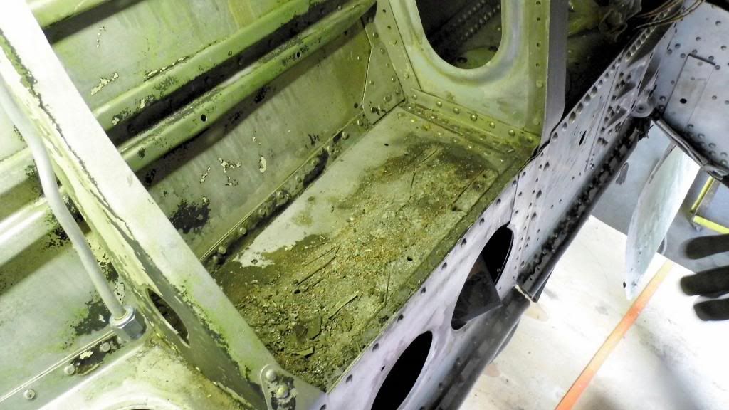

Well, the real JR also sent me some pics of the right wheel well today. He removed a mysterious air bottle from the inboard side of the well and found this under. I about had a cow.. and believe me, that is really hard to do! Looks like corrosion, huh?? Another dang problem for our metal benders. The other JR
PostPosted: Sun Mar 17, 2013 6:57 pm
Posts: 2563

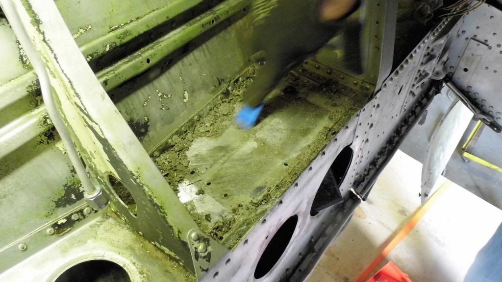

But then I got this picture... oh, what a relief it is.... It was just crud that had collected under that bottle. JR just scraped it off. No corrosion found. It will just clean up with some elbow work. Whewww. The other JR

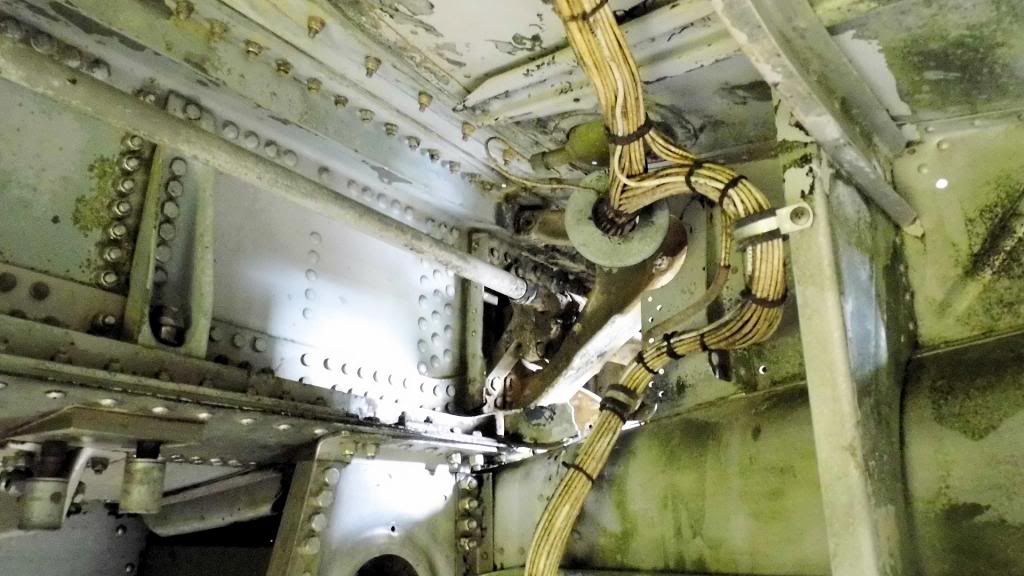

This was shot in the right wheel well and depicts the flap drive to the outboard segment behind the front wing spar. The electrically driven flap motor is in the bomb bay so this is the drive rod to that segment. Not often you can see it from this angle. When the extra 100 gal fuel tank was carried in the bomb bay, great care had to be taken that it was not overfilled. Fumes or spillage could be ignited by the actuation of the flap motor mounted on the spar. More than one aircraft was lost after rotation on take off and flap retraction when carrying an overfilled tank. If I recall correctly, it was supposed to only have 90 gallons in the forward BB tank. For long overwater ferry flights, there was another tank in the aft BB that could haul over 600 gallons. The main and aux wing tanks carried 800 gallons together. The tips added 163 each side plus 230 gal drop tanks could be carried on the inboard wing pylons. Lots of gas. Still looking for two drop tanks if anybody has a lead on some. Thanks, JR
