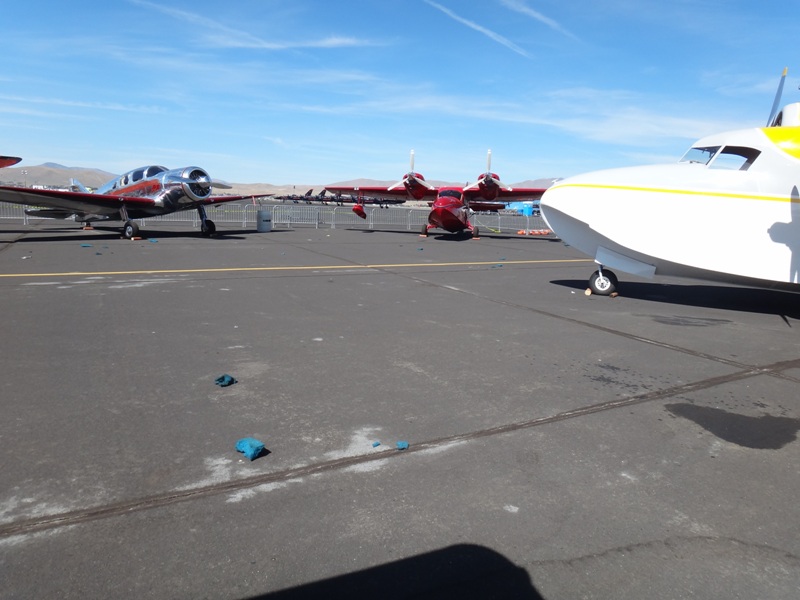

I beleive that the lack of fire was related to the explosion supressant foam that was in the fuel tanks. The foam remnants are all over the ramp and have been drifting down wind from the crash site. Here is a photo of the foam on the NAHI ramp:
Things could have been much much worse.
