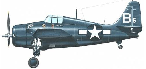

Warbirdnerd wrote:
the330thbg wrote:
How come you do not see many of the FM-2's around these days with the bomber window?
Thanks,
S.
That is an F4F. I don't think the FM-2s had that window...
Darn WWW is messing with me again! This is identified as an FM-2. :(
Thanks for the heads up! :supz:
S.

Didn't some of the later FM-2's have the window? I thought that I read somewhere that they did, but I could be mistaken because I can't remember what I did this morning. :drink3: :drink3: :drink3: :drink3: It has nothing to do with the smiles or alcohol

The prototype F4F-8 had them but they were done away with on the FM-2. There is just a dzus panel covering the hole.
