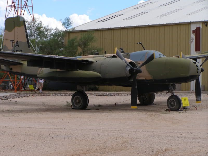

I was excited to see a photo of "B-26K" 43-22652 at the Travis AFB/Doolittle Aerospace Museum in CA, but then learned that it's an A-26C painted to represent a K model.
Other than Special K, there's a K at the NMUSAF, and one at Pima. Another was scrapped at Florence, SC years ago. Any other K-models still around??
Ken
64-17640 is at the South Dakota Air & Space Museum Ellsworth AFB, 64-17651 KAI Aerospace Museum in South Korea, 64-17653 Pima Air & Space Museum, 64-17666 Hurlburt, and 64-17676 NMUSAF

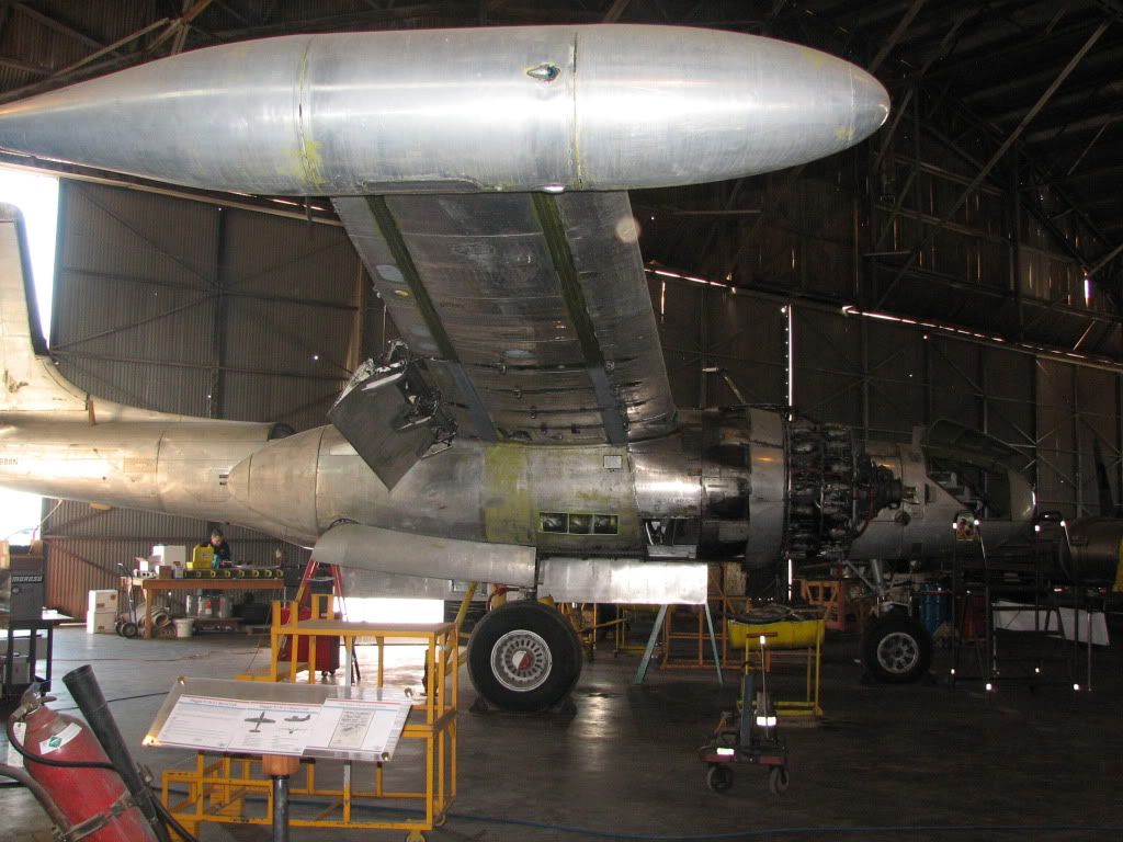

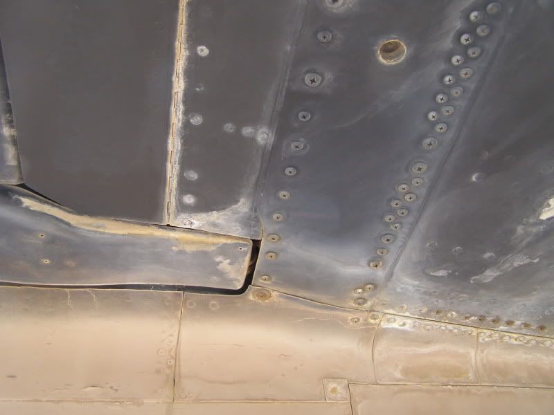

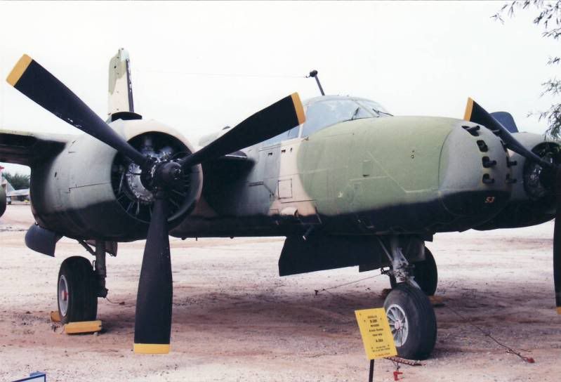

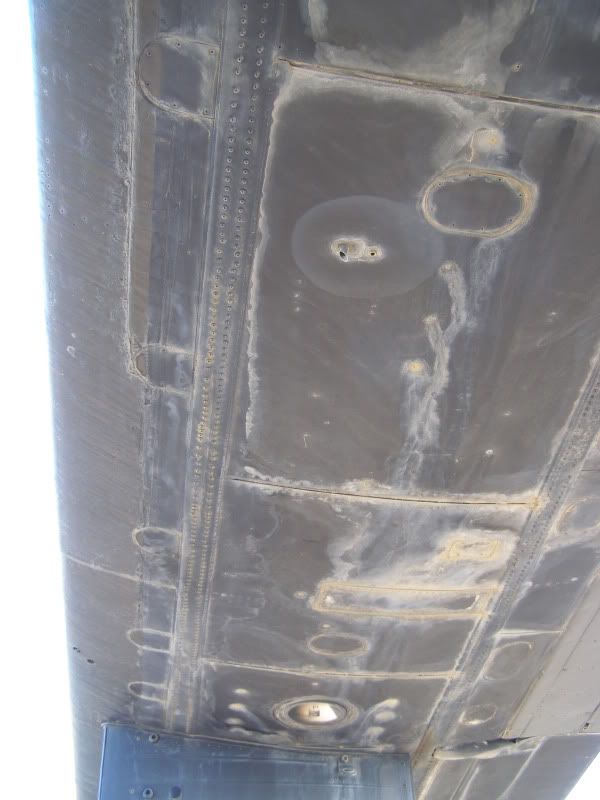

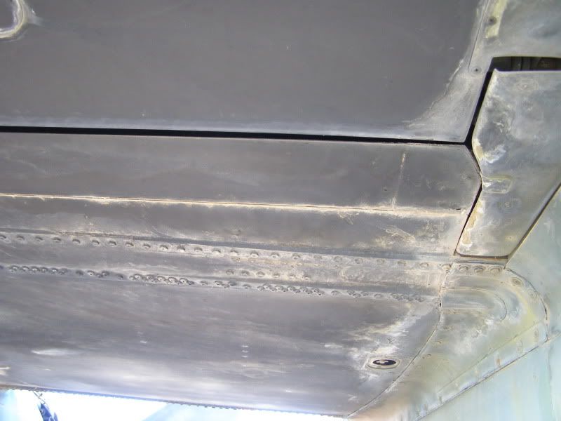

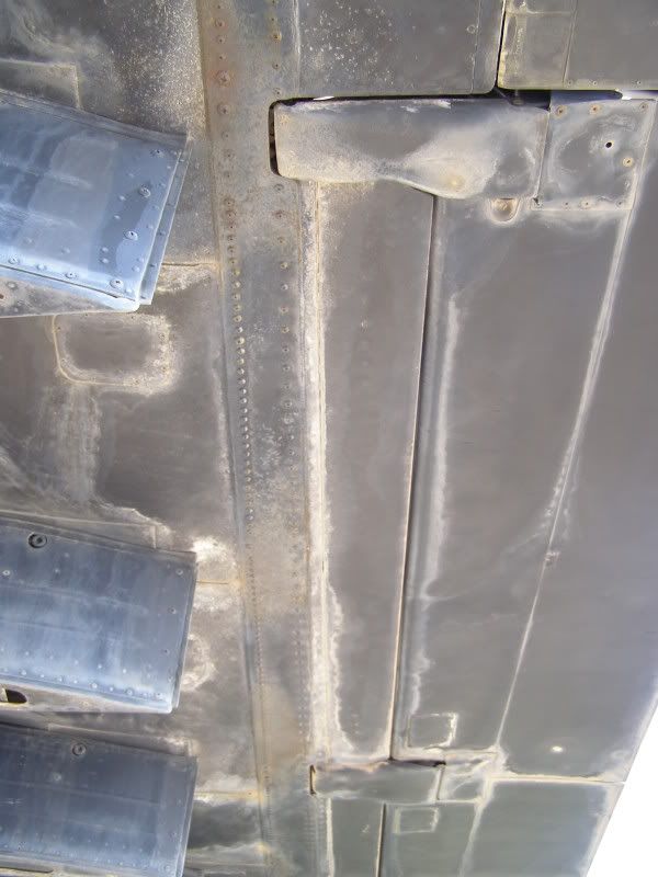

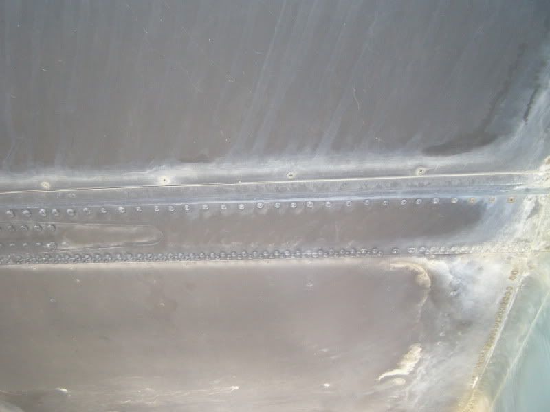

Here are a few pics of the Pima B26K. I found the beefed up lower spar interesting.

I was look at the spar straps on Special K a couple weeks ago. Pretty neat, I thought they must really mess up the airflow over the wing.
We got to thinking about it and realized that the K models eschewed the speed of the original Invaders for more load carrying ability. Even with the big props and more Hp, they were slower than the originals; lower geared to carry more load, so to say.

The wing on the K model was certainly no lightweight. When I went to Florence to retrieve some parts of 671 before it's final demise, there was a secton of the wing laying there cut from outboard of the nacelle to just beyond the last hard point. I'm guessing it was about 10-12ft. long. I wanted to turn it over to see if the landing light was still intact. Try as we might, my son and I couldn't budge the thing. I had no idea a section of wing would be that heavy. After looking at the small section of spar I got, I understood why. I have a piece of either the lower or upper spar, 15" long and it weighs 4 pounds.

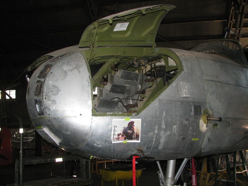

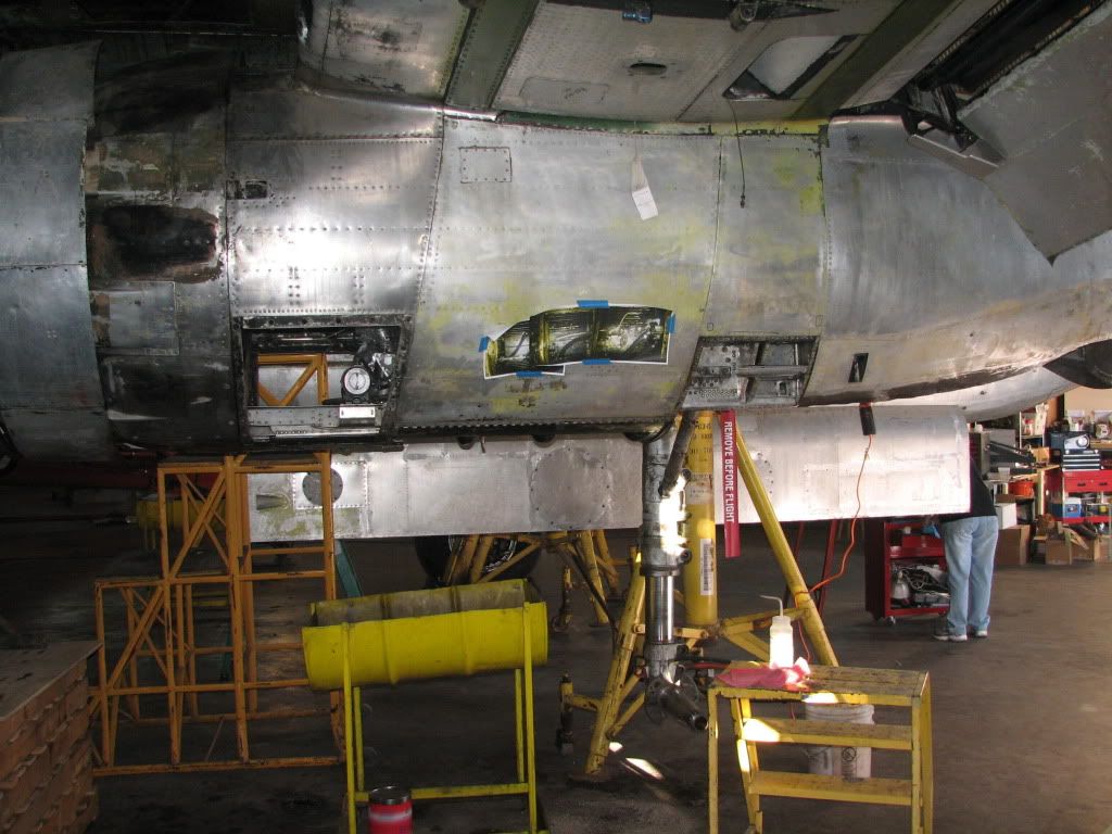

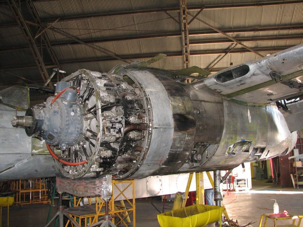

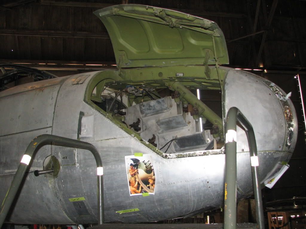

Here are some pics I took this weekend. The team is working on several areas, corrosion on the RH horizontal stab front spar, several areas of mower/ramp rash, the big area right now is repairs to the LH engine nacelle. The LH gear has collapsed twice in 679's lifetime and neither time were proper repairs made, so the team is doing it now.
Nose Gear Doors are ready once fabric is put over the lightning holes.
The nose gear has been competely rebuilt, both props have been overhauled as well as both carbs. The LH nacelle repair will require pulling the LH engine to fix damage to the firewall. The flight controls have also been recovered as well. The big issues are the nacelles and all the sheetmetal damage and poor repairs. We are also in need of some good electricians/avionics volunteers to try to sort out the electrical system and install some decent avionics. If anyone is interested call the number in the picture above.
