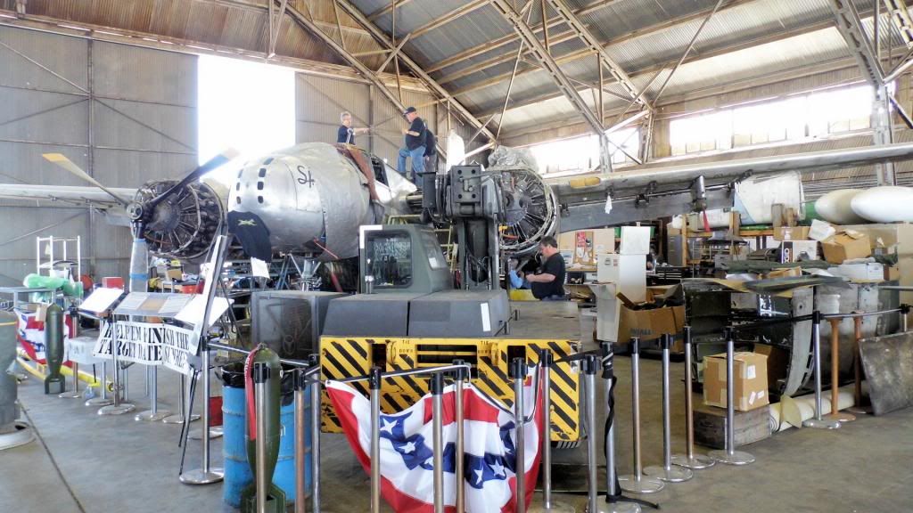

Ray, Miguel, Lou and JR are discussing the repair to one of the top fuselage skins that has been on hold for some time. Ray just about has the cockpit window frame ready to install so this is a good time to take care of it since it is just a few feet behind the cockpit. There are some corrosion issues just as there was in the window frame. As old as the airplane is, corrosion has not been as prevalent as might be expected. It must have been all that clean living up in Montana for all those years. :-) Oh, would like to give a shout out to Bill Bolton who was a mech at Lynch Air Tankers back in the day and got to work on K. It was good hearing from you, Bill. He now works for Boeing on the 787 program. He had the privilege of getting a heck of a ride in K with Denny Lynch after getting her back airworthy. We look forward to the day we fly again. Please notice that Ichabod Crane is now in place and we are just waiting on a spreader bar for the sling to pull the left engine. A big thanks goes out to Arnold and David A for getting Ichabod running again. The other JR

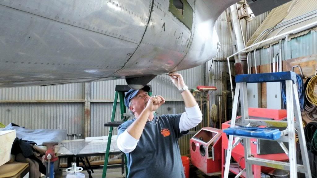

K got her tail cone installed today. We have two new guys working with us now. This is Jim S., who works at Southwest Airlines, making the final adjustments to the cone. Clay will make us another clear plastic cover for it when we are just about ready to fly. We don't want to run the risk of cracking it at this point. Anyway, welcome Jim to the Team. He worked with JR way back in the day on 727's and DC-8's and attended our A-26 ground school a few weeks ago. Welcome to the team! The other JR

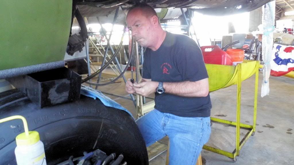

Another AF vet, Tim R, joined us today. He worked on F-111's first and then F-16's avionics for 24 years. He now works over at LM with the F-35 program. On his first day, he got to chase some fuel leaks along with Arnold. They removed the fuel selector valves where some of the leaks appear to be coming from. JR cleaned them good so we can open those up next Saturday and see about the O rings or other seals. Will have to replace one of the hoses so far. As JR said, it is far better to discover the leaks now instead of after the tanks are filled. Each main nacelle tank holds 300 gallons. The wing aux tank holds 100 gallons, but of course, if you looked closely at the new gauges, you would know that already! :-) Glad to have Tim on board. The other JR

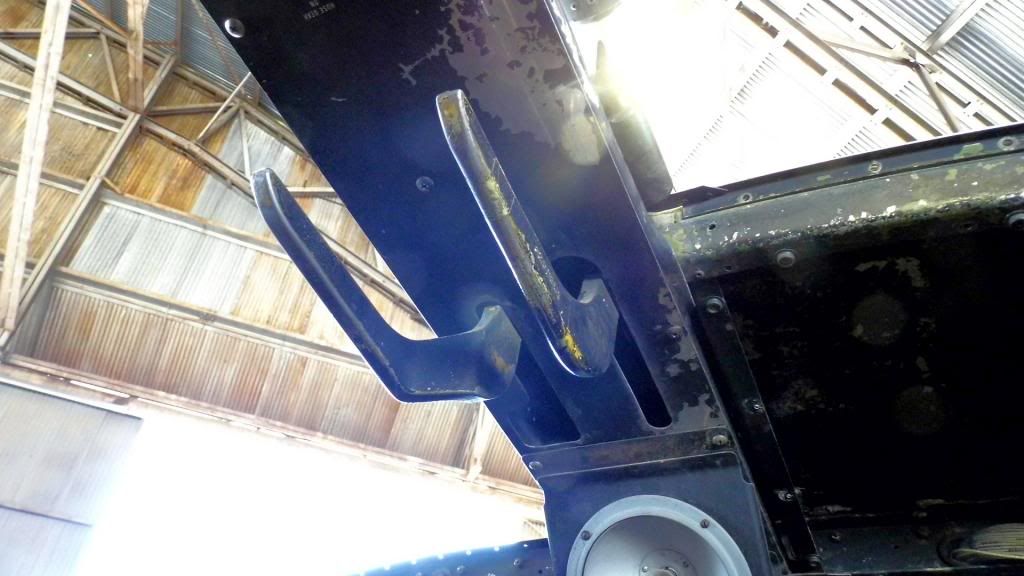

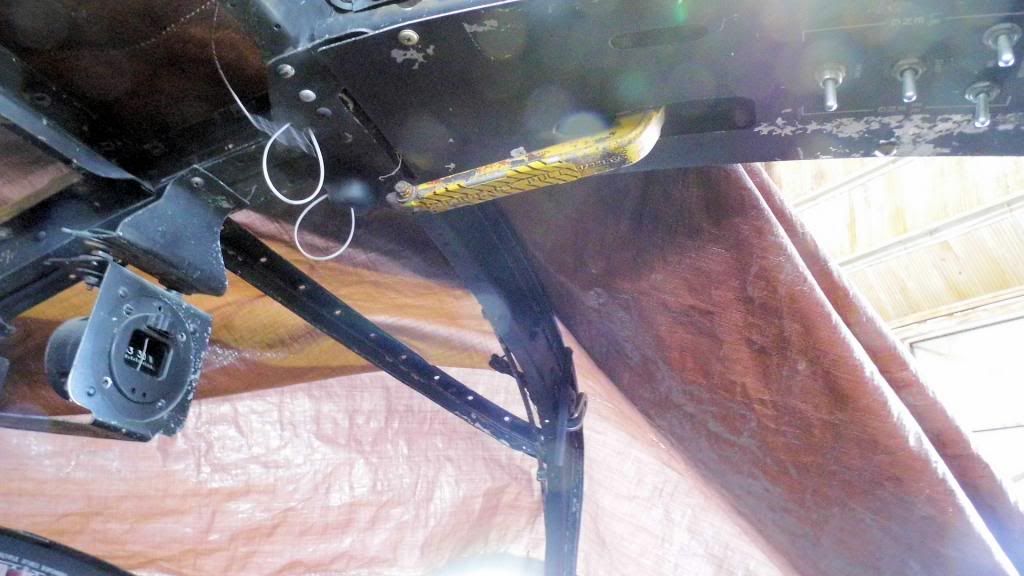

This is a shot of the external canopy release handle in the raised position. The two internal handles have also been pulled down. These release the dogs on the canopy locks there in the railings. When the CAF B model returns to the hangar from S Texas, I will go see if I can get some pics of the differences. JR

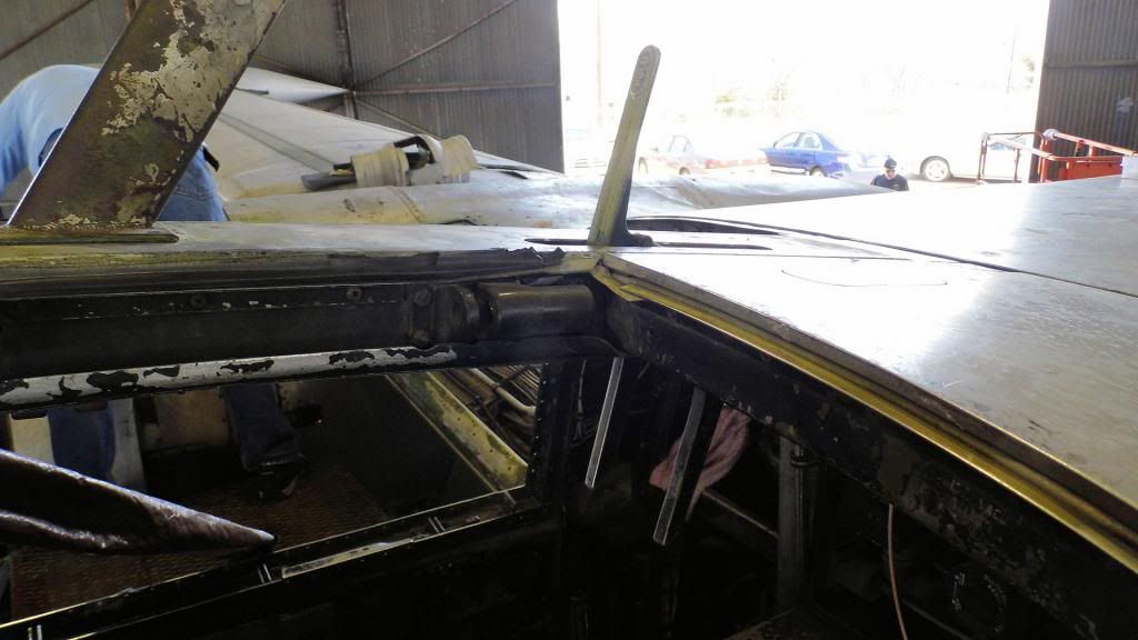

The forward section of the overhead contains the emergency jettison handle for both canopies. There is a warning in the pilot's manual to duck before pulling this handle as the canopies have a tendency to dip downward at the forward edge before being lifted by the windstream for bailout. The starter, primer, some lights and generator switches are up there as well. JR

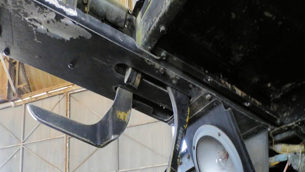

Aaron, here is another shot showing the handles split. The B model is still down in S Texas and not expected back for another week or so. As for glass, you might try a company in Ohio that makes plastic instead of plexi. They have forms for everything but the windshields themselves. Not sure what you need. Our old glass is spoken for already or I would offer some pieces of that. We had them signed by the Nimrods and have sold some to raise money for the restoration. They have become collectibles. JR
