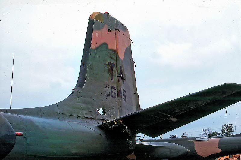

Sometimes when you poke the bear, it pokes back. Check out the battle damage this Nimrod brought back home. 37 mm anti aircraft had 7 round clips so there were would be 7 bright blobs rushing by you. When they were far apart, they were missing you good, but when they looked like they were coming right behind each other, they were too close. This pic provides a good explanation of how a few folks wound up with the nickname of "Magnet Ass", but we won't mention any names!!!

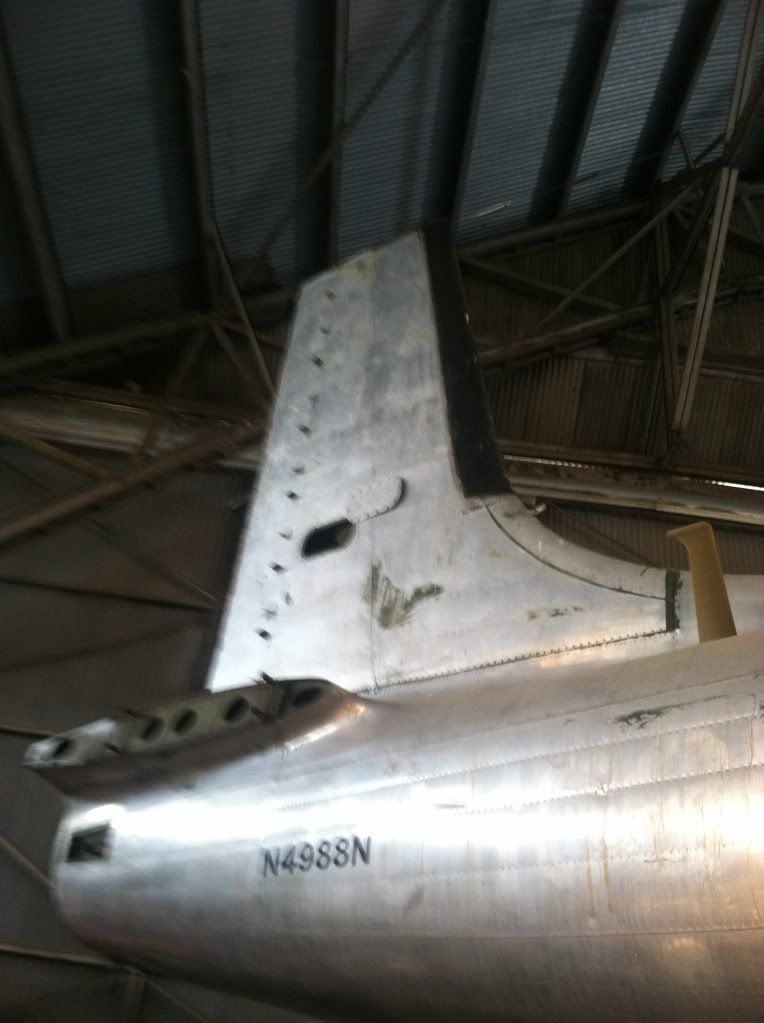

Hey, wanna see some nasty pictures? I got one of Kay going TOPLESS. Actually, I am trying to laugh because the boys found some bad news up there on the top of the vertical stabilizer today. That mean ol Mr. Corrosion showed up again on the aft spar of the vertical stab. That's the bad news. The good news is that JR thinks it may be repairable. Had to remove the vertical cap and then next weekend, remove the upper rudder hinge bracket to get at it front and back for a thorough inspection. This is somewhat disappointing because it will set us back some on the timeline. Not a showstopper though. There is no monetary reason this can't be fixed.... if I win the lottery. :-) Tearful in Texas, Jim R
PostPosted: Sat Jan 28, 2012 11:33 pm
Posts: 2563
David and Rand are looking at the corrosion on the aft spar. It is hoped that we can repair it in place rather than having to remove the vertical stab. That would be a monumental chore that we rather not tackle if we don't have to.

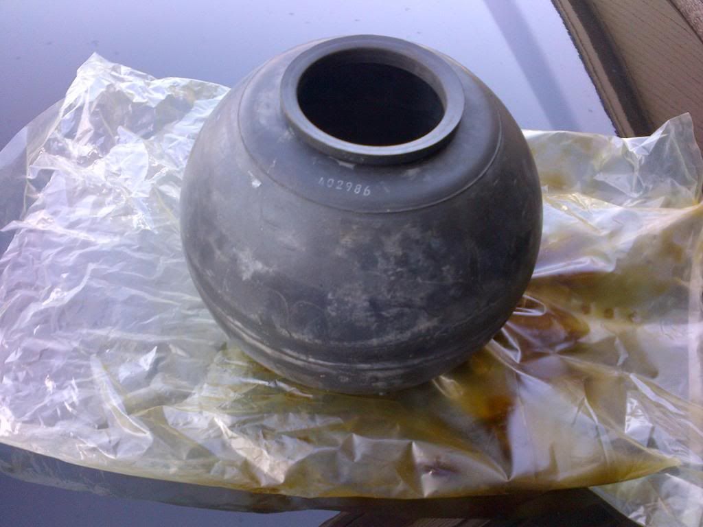

Lookee what JR found. He pulled another rabbit out of his hat. He was thrilled about it. So am I. Now if somebody would just tell me what it is. I just fly these things!!! This is the mystery question of the night! Bueller, Bueller, anyone, anyone?? Let's see how good yall really are. :-) Jim R
PostPosted: Sat Jan 28, 2012 11:45 pm
Posts: 2595
Location: Mississippi
its obviously a piece of pottery of some sort...glad I could help.
PostPosted: Sun Jan 29, 2012 12:22 am
Posts: 439
Location: Galena Park Texas
Is it some form of de-icer reservoir?
PostPosted: Sun Jan 29, 2012 12:44 am
Posts: 1487
I am thinking it's a hard to find serviceable diaphragm for a spherical accumulator used in the hydraulic system.
