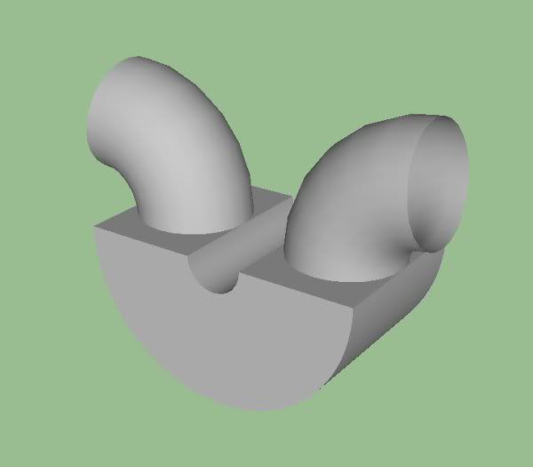

Here's a very poor sketch of what we have, some have casings around the lower (finned) section, some don't.
All the best,
Paul
Paul,
What diameter are the two tubes on that piece? I'm wondering if they could be part of the early style cockpit heating equipment.

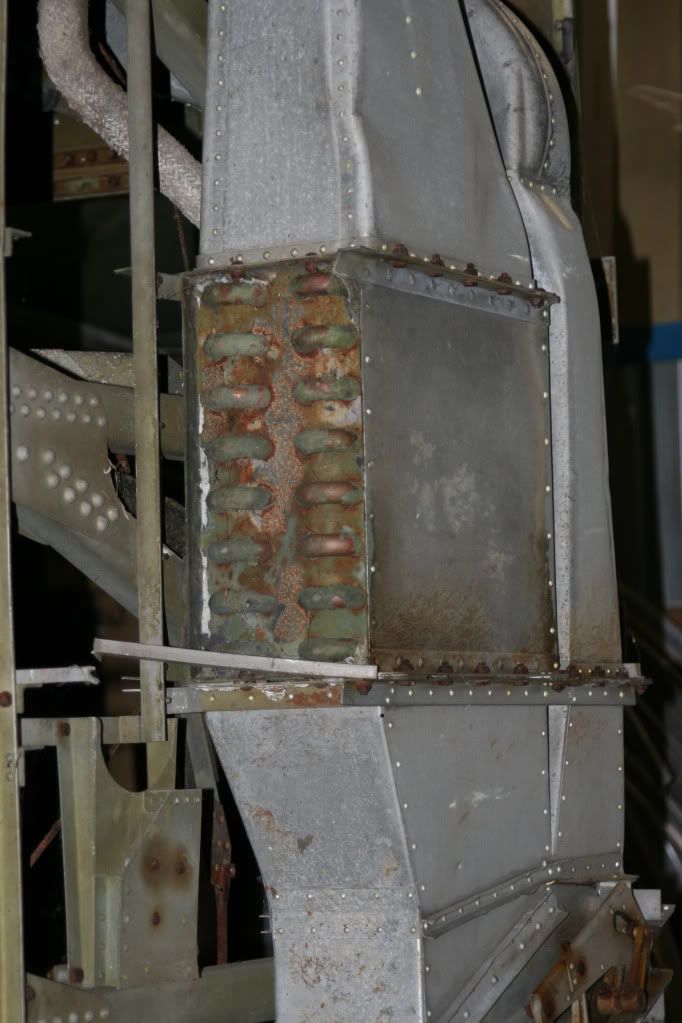

This is an early style fuselage heat exchanger. Looks nothing
like Paul's drawing.
-Bill

Thanks, Bill. I don't have a parts catalog up here so gave a wild guess. And thanks for the photo of the early heater system. Our airplane has the later style and we probably have enough parts in the warehouse to make it function if one wanted to.
As far as that component, I'm still stumped too.
I don't recall seeing anything exactly like that in Chuckie, and she still has turbos and intercoolers installed, nor do I recall seeing anything like it in TR.
Scott
Scott,
IIRC the tubes were about 4" dia., stainless steel.
Of those that still had casings around the finned C-section, the casing was green enamelled steel on the outside, black enamelled on the inside. (The same as the exhaust heatshields in the engine accessory section of the nacelles.)
Heavy lumps too, you wouldn't want to carry one too far on your own. :wink:
All the best,
Paul
