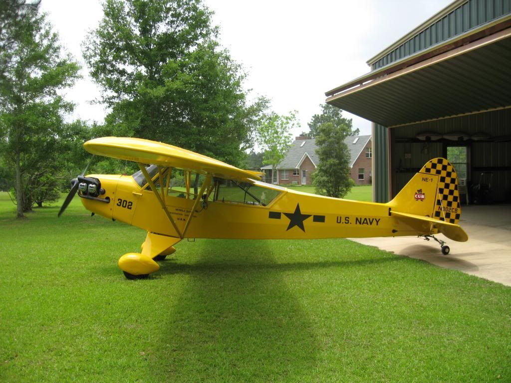

This one belongs to my neighbour.
Actually I have just purchased this aircraft from my neighbour.
