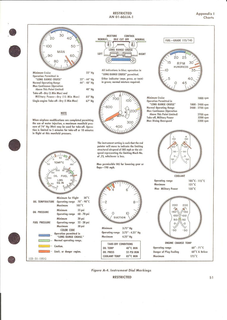

I'm posting one additional page from the manual here showing the limits on engines and flight instruments. If nothing else,this confirms an earlier question concerning the 505 mph VNE speed limit marked on the airspeed indicator. Also,someone mentioned not being able to see the entire pages posted from this manual. All that I can suggest is to either shrink the web page display to around 75%. if that's an option or to scroll right to see the rest of the page.The manual on the CD shows up initially as 204%, which is apparently the way that it was originally scanned by the vendor. However, I have to print the original pages and rescan them prior to uploading them to Photobucket, so I don't really understand why they show up in such a large format on WIX.
Anyway,here's the page:
