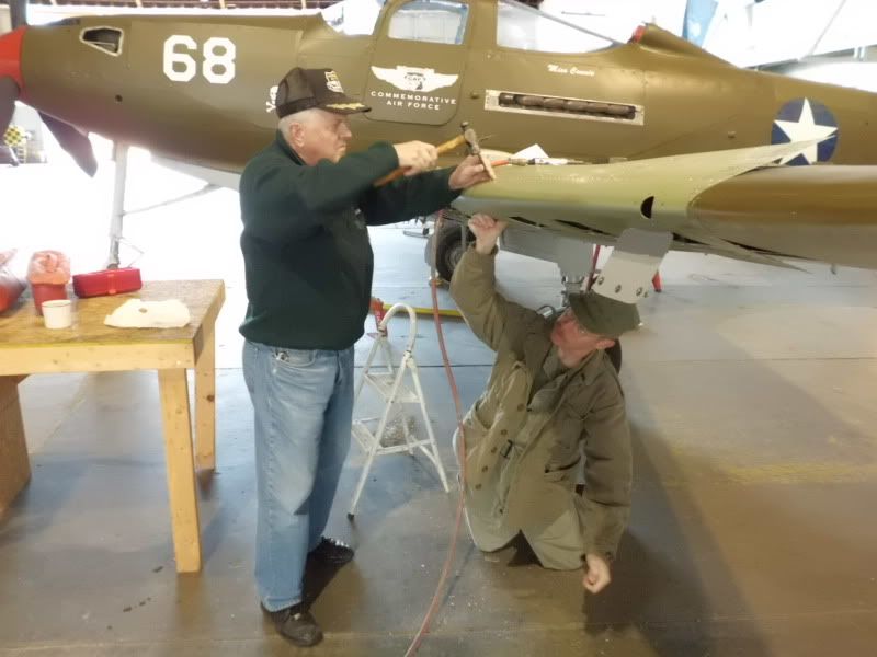

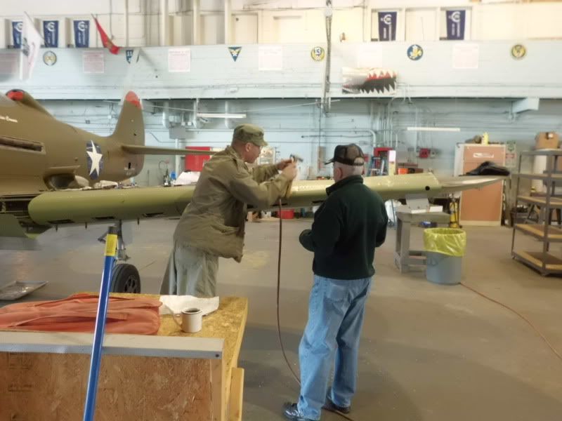

Work progressing on the P-39- Wing leading edge. Un-staged workers being warted by SPANNER
