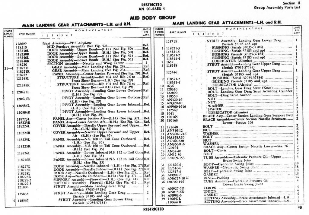

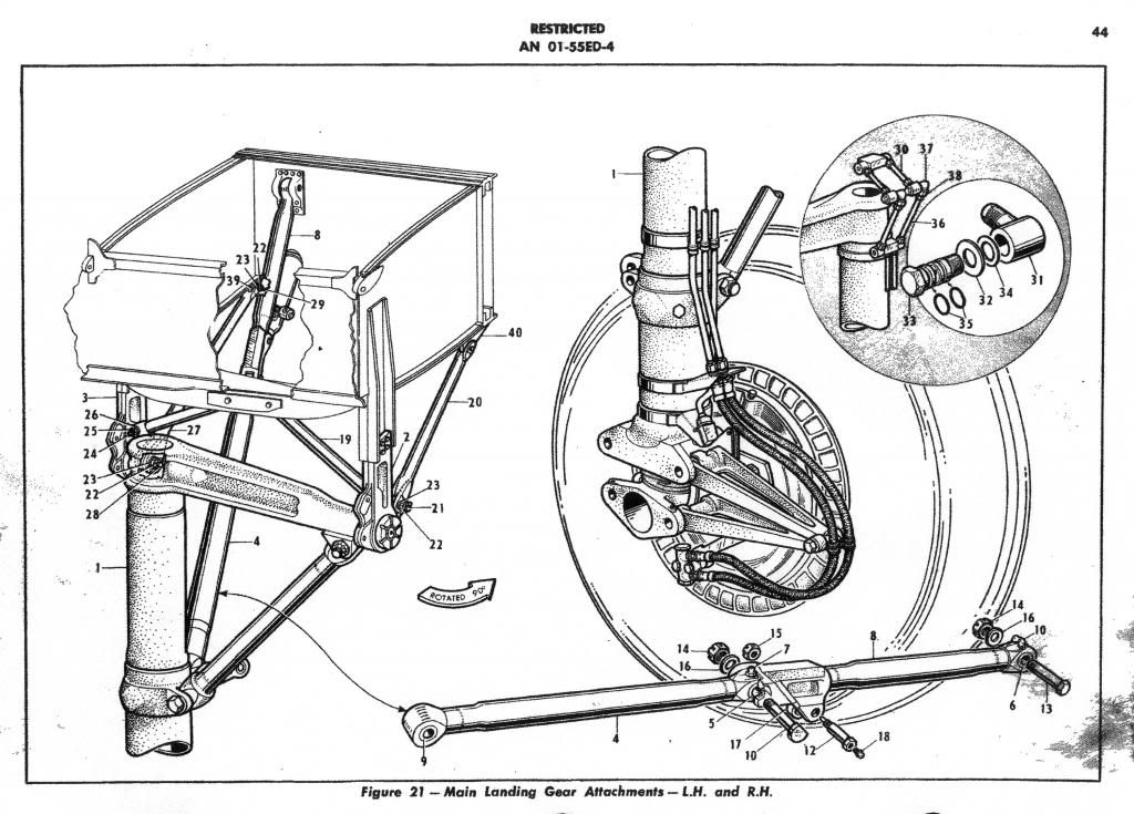

Gary:
What a mess! Poor Poon has seen better days that's for sure!
We have a PV-1 and are striving (against big odds) to make it airworthy. You can see it at www.rcafventura.ca if you already haven't seen it.
Anyway, back in 1961 an AD was issued concerning the Main Landing Gear Lower Drag Struts. They had been found understrength from manufacture. Explains why you see so many Ventura's on their belly pics!
The PV-2 struts were a recommended replacement. The part number is 125715 on the Poon. A hardness test on this strut will not be necessary according to the AD. The strut will weigh about 15.5 pounds.
We Rockwell tested our struts and they failed so we're not installing them! Been on the scrounge for PV-2 struts since.
We'd appreciate a set if they are there! I've got the PV-2 IPC on the laptop if you need a diagram.
Best Regards:
Tony Jarvis

Tony, please send the diagram. This Harpoon only has the stbd landing gear. As you can see, sitting on her belly, it's not at the best angle to see what all is in the wheel well. Hopefully I'll get a good view tomorrow.

Gary:
As requested! The part we need is #4 on this IPC scan. We could also use the attachment that #8 bolts into at the spar. No number in this scan but you can see it were #8 attaches to the spar web.
#4 is the most important however!
Thanks for your help and your generous offer to help anyone on WIX with parts. It takes a lot of effort and time and I am sure I speak for the entire group by saying we really appreciate it.
Tony
