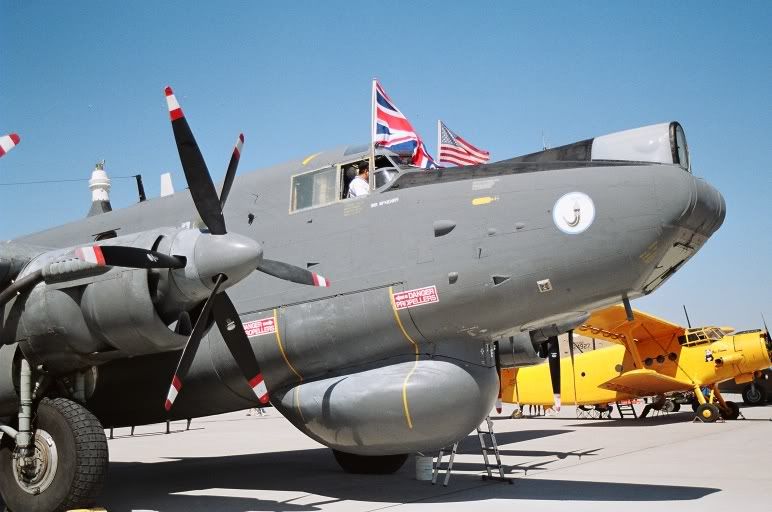

Here are the first few.

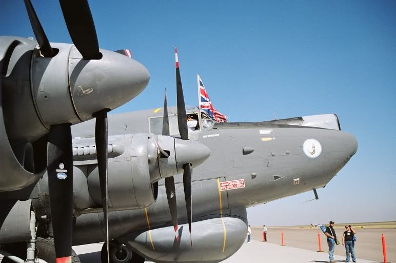

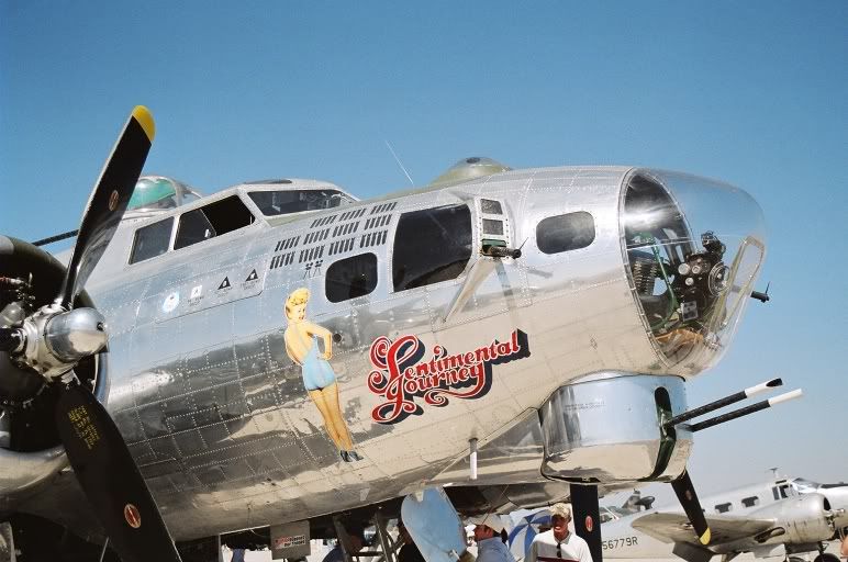

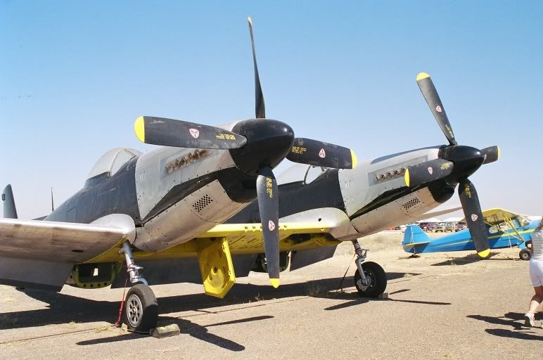

Nice shots. The Shackelton is looking good. The P-82 is looking better from what it looked like a few months ago. For some reason the propellers on the P-82 look odd in that picture. How was "Sentimental Journey" looking? Wasn't it about a month ago she got damaged from hail?
This is a shot of the Shackelton in Midland at Airsho 2000.

Sentimental looked great. If I didn't know it was hail damaged, I would have never noticed. There were a few obvious dents, but nothing bad at all. All of the busted glass was fixed, and the control surfaces had been re-covered. The P-82 props look weird because they were held on with 2X4s. If you look real close at the top blade on the left side fuse, you'll see the stick and the tape holding it together. The wing center section had some fresh looking work done, but I'm not sure by who. I don't think much, if anything has been done since the CAF got it back. Does anyone know if the USAFM is still trying to take it from the CAF?

Re: the P-82. There are on-going discussions. Nothing firm has been resolved. The airplane has been put back together primarily so we could move it around the hangar. Right about the prop blades...they are actually fiberglas replicas and the top left blade was broken at its base, hence the duct tape. Some fine work had been done to the airplane at Ezell's....We are hopeful for a mutually pleasing resolution to the whole issue.

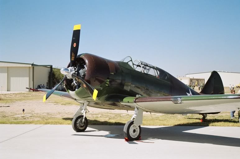

The CAF 109, did they decide to permanently ground that airplane? I have never seen "The Green Dragon" in person. How nice of a B-25 is it? The T-6/P-64 thing, wasn't that for sale a few months back?
