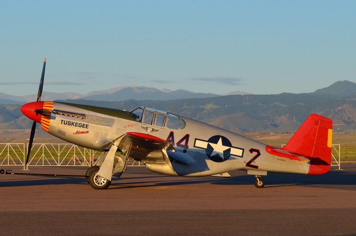

NTSB Probable Cause report is out as of 4/5/16:
http://www.ntsb.gov/_layouts/ntsb.aviat ... &pgsize=50
NTSB Identification: GAA16CA133
14 CFR Part 91: General Aviation
Accident occurred Wednesday, February 03, 2016 in Dallas, TX
Probable Cause Approval Date: 04/05/2016
Aircraft: NORTH AMERICAN P 51, registration: N61429
Injuries: 1 Minor.
NTSB investigators used data provided by various entities, including, but not limited to, the Federal Aviation Administration and/or the operator and did not travel in support of this investigation to prepare this aircraft accident report.
The pilot reported that he landed the airplane with the landing gear retracted, which resulted in substantial damage to the fuselage.
According to the pilot there were no preimpact mechanical failures or malfunctions with the airframe or engine that would have precluded normal operation.
The pilot further reported that this accident could have been prevented with a "higher degree" of diligence to checklists.
The National Transportation Safety Board determines the probable cause(s) of this accident as follows:
•The pilot's failure to extend the landing gear prior to landing, which resulted in substantial damage to the fuselage during landing.
