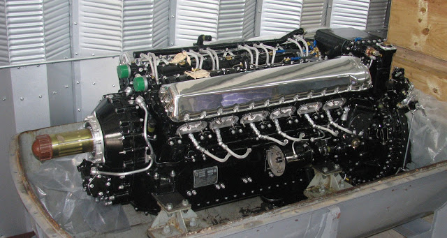

They were the most powerful Packard Merlin’s made in standard production, and the last of the line. The XP-82 has one each V-1650-23 right hand and -25 left hand engines that were rated by Packard identically to the “dash nine” Merlin that was in late Mustangs. That’s a beefy engine. The normal P-51D V-1650-7 was rated from the manufacturer at 1315hp at 3000 rpm, with a max horsepower of 1720hp at 3000 rpm. The dash 23 and 25 are normal rated at 1380hp at 3000 rpm, with maximum power being 2,280 hp at 3000 rpm, and same as the dash nine Merlin. What is neat, and a mystery to me is that the dash 25 has a reduction gear ratio of .478 to 1 while the dash 23 has a .480 to 1. It must all work out due to the additional reduction gear losses somehow....regardless, I imagine the new engines will be super strong, and have the benefit of many years of postwar engine development (Reno) ensuring their durability.
This is a picture of their engine from their site...
