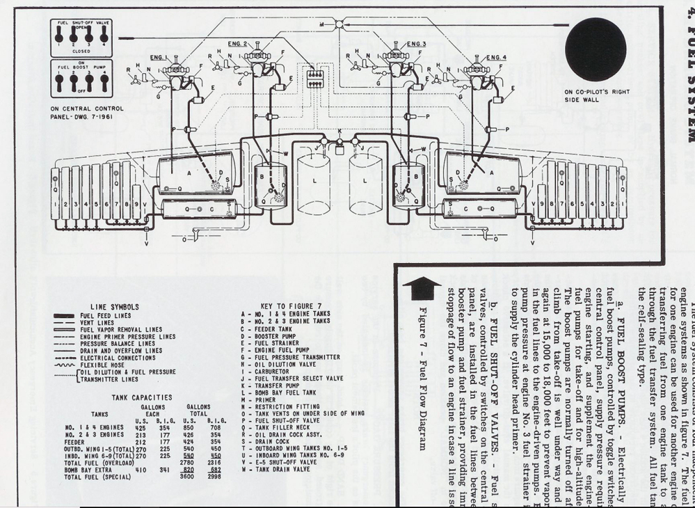

One other thing that is not mentioned and I am sure a lot of you already know this.
Since the NTSB / FAA found negligence and intentional bad maintenance - This will give the Insurance company an out, not to pay-out on this claim.
The interesting part of this report is it looks like the remains was moved relatively intact for the investigation.
Since it mentions only 4 x fuel tanks, presume they are talking about the A & B (L/R) tanks and that the feeder tank was removed
