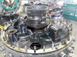

Lookee here... our right engine is being torn down, cleaned and readied for inspection. That is the crucial part where we get the news that XYZ parts will have to be replaced. Gulp! And some of these will involve tens of thousands of dollars no doubt. Waiting for the news is a lot like being in the last trimester of pregnancy, the coyote stage, where all you can do is wait by the den and howl at the moon. :-) She is in the delivery room now!!! JR

In case you have never looked inside a cuckoo clock, this is sorta what it looks like. So which part of our engine is this?? Who knew this stuff was in there?? It all looks necessary, but...... sheesh. Fun to watch though! :-)
pop2 JR

Location: Ft Worth
Thats the front support, gov drive gear on the right. Courtesy of the folks at 400 Main St, East Hartford.
