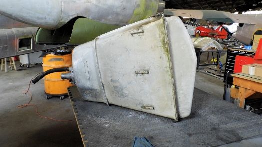

Got some picture capability back this morning so will space these out over the week. JR is cleaning up the right oil tank area. Later, Alex, one of our new guys, took over to finish it up. The oil tank had not been out probably since the Macon accident restoration. It is in decent shape from the first inspection but will need a good cleaning. Brian B will bring his power washer next Saturday to take care of the outside. Apparently, this tank does not have a separate section to warm up a smaller quantity of oil before opening up to the full tank circulation. The other tank is the same way so will have to check this out as most radials use the warm up scheme to expedite starting. Jim S is measuring and making templates for the air intakes on the oil cooler so that we can make some plugs to keep birds and debris out while parked on the ramp. Yes, we are thinking a little bit ahead, but getting the plugs made will take a little lead time. Just more light at the end of the tunnel..... :-) The Other JR

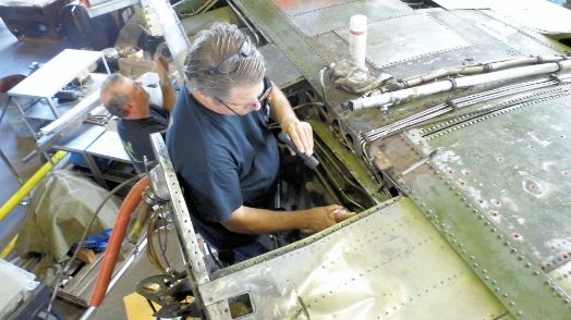

David B, Tim and Rand got the left side oil cooler hoses hooked up and that piece of the puzzle in place. We are having some plugs made that will keep the air intakes clean when not in action. We have resolved no more bird nests!! When David A is able to return, JR and David will finish up the right side. We send good wishes and get well soon to David A's mom.
The oil tank will be cleaned and a new hose put on here and there, but for the most part, should be ready to go back in soon. All the overhauled components have been delivered for the right engine so that it won't leave very many to re-install when it comes back. JR was talking about building a wooden cradle for the engine so that we can hook up the QEC and have everything ready to go in one swoop. It appears we have all the parts in place to hang the prop as well. Sure will be nice to have two props on again. Now I am anxious to go try those engines out!! But JR says it will be a at least a couple of months anyway before we are ready to pull it out of the hangar and start testing things. Lots of details left to do. Everybody wish us luck, huh?? The Other JR

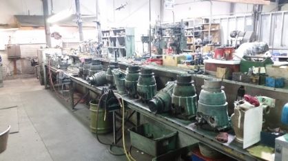

Meanwhile, back at the ranch in Idaho, work continues on our engine. Eighteen cylinders is an awful lot to keep up with on the bench. It is like a baseball team I reckon. Each waiting its turn at bat. Will it be a hit or a miss? We are anxiously awaiting the score. I am reminded of the song that goes something like.. "I fooled around and fell in love..." Oh, whatever possessed me to start loving round engines??? The sight of them starting up.. oil smoke, puking, barking.. finally catching some rhythm and then that sound... that sound of a hundred Harley's pulling up.... power personified. The finesse it takes to get one going, juggling mags, primer switches, mixtures, throttles ... feel like a one handed piano player... But Gawd, I love it!! I can almost hear the cha-chings on Mr. Anderson's cash register though. This one is going to be the mother of all overhauls, I'm afraid. :roll: JR

This is the aforementioned oil tank. When used to talking 6 to 10 quarts in small engines, this is normally serviced to 30 gallons. Instead of burning 1 or 2 quarts per hour, usually a 2800 can be expected to burn about 2 gallons per hour. Big difference in thinking and planning. Now there is the question that wasn't an option back in K's military days, use single weight oil or multi-viscosity? It sure takes 60 weight oil awhile to get warmed up and moving freely. Would any other big round engine operators like to give their opinions on this subject? Yep, there is a cost difference so it matters. Thanks, JR

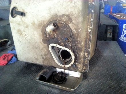

Top of the oil tank looks a bit messy as would be expected after years of collecting oil spills and grime. Probably not as bad as it could have been though. It will get a thorough cleaning on Saturday. Even though we are trying to tidy up for the dance, we still have a full day's work planned on the airplane. We will quit in time to go home, take a spit bath and put on some of that smell good water just in case some philly decides that one of us might make a good dance partner. Boogie Woogie dancing fool I am... uh.. I am good for at least once! :-) But ya gotta love that 40's music. Maybe I should wait for a slow song? Sorry, I got side tracked thinking about all those girls who are going to be there just dying to dance. Where was I? Oh, yes, the oil tank will be re-installed after JR's plan for the installation of some quick disconnects for the hydraulic system is finished. This will allow us to hook up the mule directly to the system without having to disconnect lines each time. We have a multitude of tests for the gear system and this would make it much quicker while lessening the risk of allowing air into the system. It will be so nice to get back to making gear swings and hook up the gear doors! The Other JR

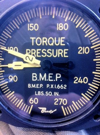

Our new torque gauge.. ain't it purty?? :-) The wet limits are 253 and the dry limits are 222. That's what the book says. Guess I need an interpreter, uh interpretor.. interpretur?? Oh what the heck, somebody who can explain what this means. Larry has to put new range markings on it before installation, but that should happen soon. The two new pressure transmitters are expected as we speak as the UPS truck has them out for delivery. Don't see this type of gauge on very many piston airplanes but it sure makes a lot of sense on these R2800's. JR

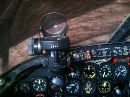

Go ahead and make my day!! Yep, the gunsight was installed for the tours tomorow night at the hangar dance. We put in the control yoke on the right side and both seats so this is your chance to come play Top Gun... sorta... :-) I suppose everybody knows that an A26 was credited with shooting down a Luftwaffe Me-262 in WWII?? JR
