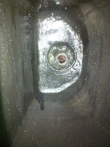

OK, this is my mood since the Aggies got beat by Ol Miss last night! Just kidding... it is the inside of the number 2 oil tank before cleaning. There was a lot of sludge in it. JR stuck a magnet down in the bottom and there were a few ferrous flakes, but nothing big enough to have part numbers on them. We suppose it may have been from the engine that ferried K from Macon to Billings that later was used on the A-26 "Always" movie filming although it could have been from the engine we sent to Idaho for overhaul. Either way, we hope everything gets fixed. JR and Brian cleaned the tank inside and out. Jim S painted the outside so now it looks really nice. Feelin Blue in the Republic, The Aggie JR

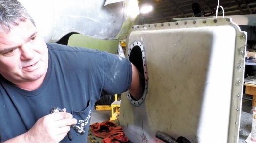

So how does one clean out the inside of an oil tank, well, it is sorta like noodlin for catfish along the bank of a stream or lake. Not quite sure whether there will be fish, water moccasin or snapping turtle in the hole so that is why one enters very carefully. Bryan did an excellent job finishing up the black hole as will be shown in the next shot. JR

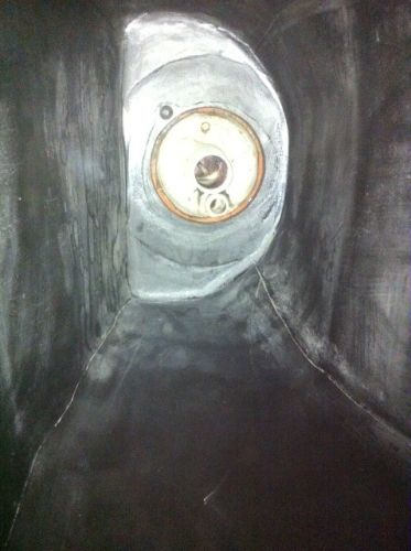

This is the after shot of the inside of the oil tank. By the way, it is normally serviced to 30 gallons of oil. We will use 60 wt mineral oil for the break in period on the new engine and then change to 60 wt AD after much consideration vrs multi viscosity. JR
