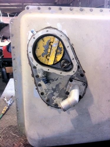

Here is a "before JR and company" got hold of the oil tank top and innards! The after shot will follow. But back to Airnutz, glad to see someone else is a connysewer of ZZ Top, that lil ol band from Texas. They have come up with some of my favorite tunes...like "LaGrange". I happened to be on the campus of A & M when the whole controversy about the "Chicken Ranch" was stirred up by that "publicity seeking ex deputry sheriff turned investigative reporter" for a TV station in Houston. There were some Aggies who wouldn't have minded if somebody had taken that fella for a little ride with Ted Kennedy over some bridge. Now, here is a good mystery question for ya, what was the significance of radio station WTAW? :-) The other JR

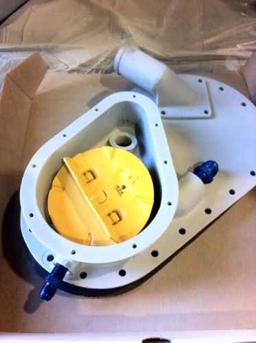

Now this is what I'm talking about. Good as new practically. Should last a long time now. There was a little bit of corrosion to clean up in the metal, but mostly it was a max effort with the elbow grease! They done good!!! JR is planning an extra work session this coming Friday for those of the team that can make it. We are trying to catch up the work needed to be done before the right engine is returned. We would also like to get as much done before the cold weather comes and slows us down some. Speaking of the engine, a brief report that JR got back from Anderson's recently indicated the supercharger was going back together and that seven of our cylinders were bad. Not too big of a surprise, but it sure runs the cost of the overhaul up. It is not too late to make a tax deductible donation using paypal or credit card at our sister non profit so that we can take advantage of the matching funds. Please go to http://www.a-26legacy.org and scroll down to the donate button at the bottom left of the page. The team would certainly appreciate anything you can do to help us get her flying. Oshkosh in 2015 is our goal!!! Help us get there!!! Thanks, The Other JR

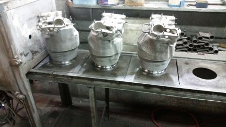

The latest report from Idaho shows seven bad cylinders however the heads appear to be serviceable. Four rear and 3 front cylinders will receive new barrels. Guess that is better than expected. Would not have been surprised to hear that all 18 were bad. Some of the guys will be working at the hangar tomorrow, Friday, to try and make sure we are ready when the engine comes back. Of course, Saturday will be regular work day for the team. Folks are always welcome to drop by and say hello. JR

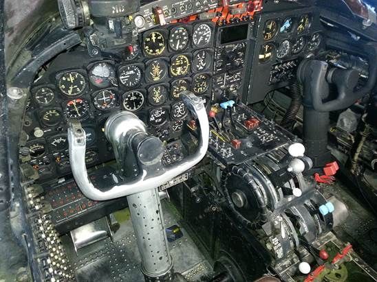

Friday's work team consisted of JR, Rand, Larry, Stan and Arnold. Here Larry has been sanding down the pilot's yoke to get it ready for paint. It will have to be done in place as it is very difficult to remove unlike the copilot's side. Both will go back with a semi-gloss black paint as the original had. Meanwhile, Arnold and Rand worked on installing the newly returned oil shutoff valve. It presented a problem though when tested. The motor was trying to run, but the valve didn't move. Back to the drawing board....a suspected case of perhaps the wiring being backwards?? They will figure it out before long. Larry got the new fuel flow gauge ready to install. It is exactly like the Dash One manual shows with two types of scales: pounds per hour and gallons per hour. No mental math required to convert pounds to gallons as a result. The old gauge just had pounds per hour so that wasn't the best for us slow minded pilot types! :-) Tomorrow should be a beautiful day to work on old airplanes so drop by. The EAA Ford Trimotor is on display at American Aero FBO just up the ramp. They are selling rides today and tomorrow, Saturday. It was a hoot to see it take off awhile ago just like back in 1928 when American Airlines flew them out of their home office, Meacham Field. The Other JR

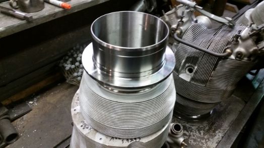

Seven cylinders got new barrels inserted for the right engine. The heads and fins are serviceable and cleaned up just fine. Can hardly wait to hear all 18 singing like a choir! A choir made up of Harley's maybe?? Work continues tomorrow with the team hitting a flap repair, nacelle prep, QEC work, cockpit clean up and finalizing the oil cooler installation. JR said the oil shutoff valve is gonna have to go back to the overhauler as the motor runs but the valve is stuck. It cost just over a $1000 to overhaul so we want it be right. The fuel flow gauge is not checking out either so that will have to be looked at some more. Again, simple little things that turn into projects it seems. Why should we expect anything different?? :-) A lady's makeover can't be rushed, but golly, a little more cooperation from her would be appreciated! Ever have that feeling while waiting for your gal to get dressed to go out?? I suppose the wait will be worth it... she will be a knockout!! :-) The Other JR
