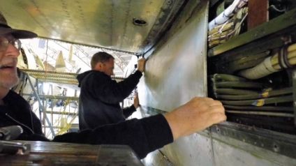

Airnutz, here is a shot of Stan and Alex hanging the armor plate over the wire run along the side of the fuselage. Maybe the edge will give you an idea of how thick this particular section is.
So Mark A, what kind of book would you like to see about this project? Documentary? Humorous? Story? History? Anybody else who would like to make suggestions for it, please join in. We think it would be a great idea. Regards, JR

Were the wood fairing strips original or an On-Mark add on?

Shrike: good question about the wood fairings. Gosh, that is hard to tell. I looked in the maintenance manual for A/B-26's from WWII and didn't find any reference to them. Ditto about the K model manual as well, but we know K has them. Many of the surviving A-26's have been modified to get rid of the fuselage armor plate to save weight. When the bomb bay doors were removed and the area converted to a passenger compartment, the sides of the fuselages were reskinned with flush aluminum sheet. Buba, for instance is all smooth down the fuselage. No evidence of armor plate left except on the bottom of the nacelles where it was an integral part. I have looked at a few pics of the original mil version and can see the fuselage plates on some, but not well enough to tell if there are any wood fairings. Perhaps our buddy Mark Allen M can provide some better shots which might show it. I noticed that even the Air Force Museum K model has some of the fairings missing. Haven't gotten a close look at the others yet, but will see if I can find some. The thing is that armor plate sticking out in the breeze would represent some drag that I would tend to think the AF would not want from the first versions on down. Fairings would help with that problem. Perhaps we can get some help from our WIXer's in the know who worked on the pre-K versions before any executive or air tanker conversions took place?? Regards, JR
