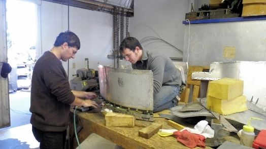

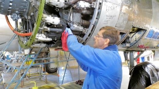

Who sez we don't have fun? Big Ed and Jim worked on the QEC prep while Clay and Denis did some sheetmetal work on the ring and the cowl flaps. Ray pounded on the nacelle to try and get it finished up for the engine mounting. JR had his hands full with the prep of the engine mounts on Mona. Larry continued the installation of the new 406 ELT so that it will get the lat/long from the GPS source plus have a on/off/test switch that will be mounted on the pilot's side subpanel. This leaves him one circuit breaker unused on the CB panel. So we need to come up with another piece of equipment for him to think about! :-) BTW, Kay is going to be fully ADS-B compliant right out of the hangar thanks to our avionics guys' diligence. Arnold, Rand and Alex worked on the installation of the ignition leads and coils on the left engine. David B and John filled in several places where needed. We had a great turnout yesterday with several old hands returning to help. Lots of detail work got done, but a lot more to go. We still have to fabricate the engine fire extinguishing system plumbing and research the autofeather system on the props some more, but the major airframe components are all in place. Sure could use some wiring diagrams for the autofeather system if anybody has them. Stay tuned for more. The Other JR

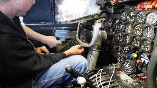

Larry and JR worked on the wiring for the ELT and the CB connection. The wires across the throttle quadrant run from the 406 ELT to the GPS receiver so it can get the position for reporting purposes if needed. Larry and Ray installed a switch for this new style ELT. Looks like it should have been there the whole time. Great restoration taking place of the instrument panel. The CB panel is about filled so we may have to slow down adding new equipment... not. There are a couple of things left that would be great for modern day navigation. More about those later. Another great Saturday in store for tomorrow. Be a great day to give your Valentines a visit to the museum! :-) The Other JR

Meanwhile, work continues on "Lisa" to finish up the ignition system. Rand, David B and Arnold have been hitting this hard the past couple of weeks. We received new Y leads and some new high tension leads from Precision Engines this week so those were all the parts we lacked to finish it up. Lisa should be ready to run. As soon as "Mona" catches up, we just have all those details to complete mentioned earlier, then Kay can be towed outside of the hangar and leak tested before engine runs. Hmmm, seems to be light at the end of the tunnel. JR

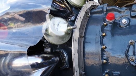

What's a sure sign that a round motor is ready to go? Miss Mona is marking her territory already! The B-29 left today for the west coast tour so all is ripe for an engine hangin' this weekend. Temps forecast near 78, but a little windy and maybe a spotty shower or two. Looking good for this big milestone. Wouldn't you know, I have to miss it?? :-( But maybe some of the guys will get some good pics or video. Sleepless in the Republic, JR

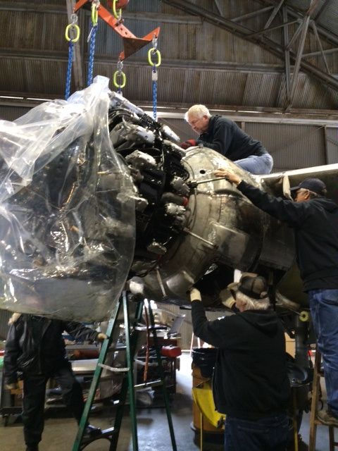

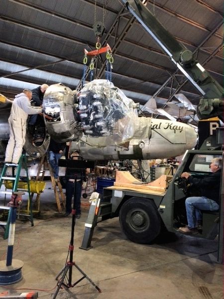

JR sent me this shot of the beginning of the delivery. It took about 4 hours of rasslin' with the alignment of the engine mount bolts to get them lined up on the top four and then the sling had to be adjusted to allow the other bolts to go thru. Big Ed is driving Ichabod Crane to deliver the goods. David A, Too Tall Tim, Larry and Stan rounded out the doctor's helpers. Everybody is very pleased with the newborn.... especially your's truly. Couldn't be prouder of the guys for getting this done. It is a super big milestone since now we can say the airframe is whole again. There are a lot of little details and systems checks to be done, but like the guys say, " All we lack is finishing up!" The Other JR

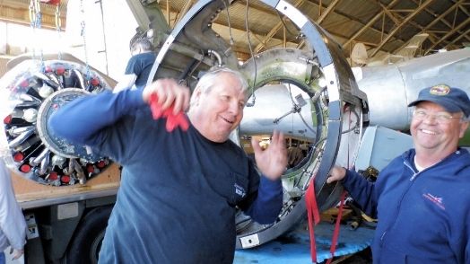

More of the unveiling of our newly overhauled engine, "Mona". The QEC mating to the nacelle took more time than expected. The alignment of the bolt holes is critical. The top four bolts went in ok but the last one at the bottom just refused to cooperate. After it was given a stern talking to by JR, it finally agreed to join the rest. :-) The Other JR

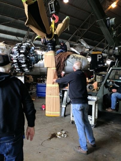

Wouldn't you know it, got the prop all ready to install and then found a glitch. Back to the hangar, Orville. Will get it straightened out hopefully by next weekend if the weather lets up a bit. We have been nearly shutdown for two days due to the ice storm which coated all the roads. There is a warm up on the way by Sunday, but Saturday will be in the 40's still. Not a particularly good day to be in the hangar. The team usually will gut it out though and show up, well, except maybe for Inu our floor mgr. Last time it got cold, he opted to stay in bed with the covers over his head. We shall see what he does this time. Stay tuned! JR
