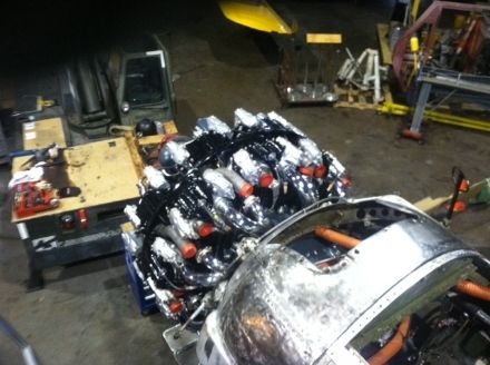

Hey Randy, how you like this angle of "Mona" in all her radiant beauty?? Sure wish Al Gore was around to make Ma Nature straighten up so we could get some work done. Too doggone cold in our unheated hangar even if we could get on the roads. Tomorrow will be nearly 70 degrees and then another Arctic blast hits on Wednesday with more ice and sleet on top of the ice that refreezes overnight. It couldn't be just plain ol' snow. Don't know what we did to irritate Mother Nature, but if anybody has any pull with her, please tell her we say " we give"! :-)
PostPosted: Mon Mar 02, 2015 2:06 pm
Posts: 329
Location: Loris, S.C.
Wow, that looks nice. Hope Hawkeye is going to capture the audio when she fires up. That should be awesome. Hope your weather improves. I know we're sure looking forward to Spring and Summer.
