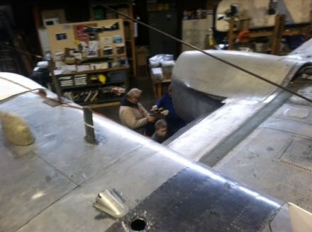

Some of the guys braved the cold on Sunday. The real JR led a crew to air up the left main strut some. With Mona's weight being gone so long, it shifted the balance over to left side. When Mona was installed, it rebalanced and then appeared to need some N2 to compensate. So Big Mike who has returned from FL and now lives in Mt. Pleasant came over to visit so naturally JR put him to work with this task. Happy to have him back. He gets to work on the MidAmerica Flying Museum's A-26 among a host of other aircraft. JR and Ray removed the nacelle end cap so that Ray can start building a shelf and support for our engine fire extinguisher bottles. Getting the system operational again is one of our larger remaining projects. Waiting in the wings so to speak is the prop autofeather system. If anyone has a wiring diagram for a Convair (R-2800) autofeather system, we could sure use a copy of it. We can't find the A-26 manual that describes the system parts and wiring for it so the Convair is the next best. Martin 404 has the same system we think. That would also do. Not sure whether the DC-6 had autofeather, but it did have about the same engine and prop. OnMark used DC-6 props and chopped off enough to leave about an 18 inch clearance on the A-26 to the ramp. Also want to congratulate one of our troops for getting on with L-3! Way to go CM!! The other JR

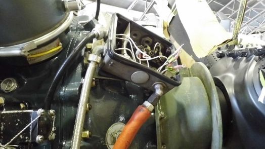

Hey Randy... Bob, thanks for those stories about NKP. Keep 'em coming!! While you are at it, could you please figure out the wiring in this junction box for the prop control?? It is different than the other side. Miss Mona must have a mind of her own. Good thing that Larry, Stan and Bob opened up the panels. Neither side had the wires actually connected. Bad things would have happened no doubt if this has not been caught. One side had the wires marked as to what they went to so the guys reverse engineered the system and thought they could apply it to the other side. Well, they are not alike so somewhere along the line, these must have been substituted because neither appear to be the correct ones. The other bad news this week is that the vacuum pump we sent for overhaul came back with a report of being uneconomical to repair. So now we have to find another and they are a rather uncommon part number. Not sure these were original to the engine either. More reseach and surprises to come no doubt, but the team made some good progress. JR and David A did a lot of spring cleaning and sorting of parts, etc. It sure needed it. Amid all the excitement, a Bonanza landing at Meacham had a gear problem and the trucks rolled. Surprisingly, it didn't take long to get some help to move it off the main runway. Yes, an exciting day indeed. Will see what tomorrow brings. Come see us at the VFM Hangar!! Opens at noon. The other JR

Still stumbling on our prop control circuits. Larry, Bob and Stan are creating their own wiring diagrams thru reverse engineering. If anyone has a Convair 340 / C131B or Martin 4-0-4 prop manual we'd sure like to see it. This is sure slowing us down.

Bob, thanks for the lead, but we found a source that had the manual with wiring diagrams & 4 new wiring harnesses. This was the good news today! Pursuing some other parts & hope to hear on these this week. Stay tuned! From the deserts of AZ, JR

While the aircraft commander is away on bizzness in the Copper State the team continues its forward progress. The No 2 prop circuit is coming together nicely. The brain trust continues to bug wires and develop plans so the props do their thing when the driver flips those switches and pushes those buttons. Helped today by a long sought after wiring diagram from a Martin 4-0-4. Big Tim and Co. brought the No 2 prop feathering line almost all the way home. Prop slip rings and adapter are all installed too. Our noisy crane aka Ichabod has toned it down a bit thanks to a new muffler. The other half of the team continue to support the DC3 Southern Cross. Overhauled No 1 1820 was filled with oil, ships battery is all charged just waiting for the signal. Just may finally turn oil into smoke sometine tomorrow. While she's been down, master metalsmith Ray waved his magic wand over her air stair. Looks like the master plan is finally coming together! Chef Hawkeye flipped his famous burgers for the team today. Well done sir! And who stole that ear of corn?

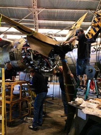

This is the "before picture". The right prop is actually hung and with some help from Joe over at Byam's Propeller Service, we are just about done with it. Just need to install the hub on Saturday. Larry and friends got a Martin 404 prop wiring diagram and are pursuing all of the in's and out's of that part of the project. We obtained a Flightstream 210 for the avionics gang to ponder and figure out where to hide it up in the nose. The wiring harness is pretty much done so it will connect to our 650. We plan to do flight planning on our IPad and then transfer all that to the 650 via Bluetooth. Ain't technology grand?? We are also thinking of upgrading our GDL 39 to a 3D version so we can take advantage of the 210's AHRS function with flight instruments and synthetic vision. With a back up hand held Nav/Com, we shouldn't be too bad off if instruments or radios start protesting the working conditions. :-) Lots of things going on in the hangar this weekend. This would be a great time to visit before the weather gets too hot. Come see us. VFM Hangar at Meacham Field in Ft Worth is where we call home. JR

The team was very productive today even though we were short a few people who left for the holiday. Both props were finalized and are now ready to go. This is a big milestone as it is getting us just that much closer to the first engine start. One of the things we are waiting on is the engine fire extinguisher system. Ray got side tracked on the DC-3 side of the house but is back now working on this. He has to use his magic to fabricate a lot of the plumbing that was missing. We do have fire bottles to mount, but really need to get the plumbing in place first. Tim, Ed and David B did a number on Mona's generator as the end cap was not positioned properly during overhaul to allow the scat tube to be at the correct angle to fit in the dish pan behind the engine. All fixed now. Alex started mounting the engine cowl ring on Mona so that is nearly done. There was a lot of detail work done by JR and of course, he kept everybody on task with good things to do. David A, Arnold and Denis prepped the DC-3 for engine runs and leak checks. They were all good so the DC-3 was flown for about an hour today to break in the new engine. More flights are planned. This would be a good time to join Greatest Generation Aircraft Non Profit and get a ride on her. Ck out the website. http://www.gga1.org and the facebook page link down at the bottom for more information.
