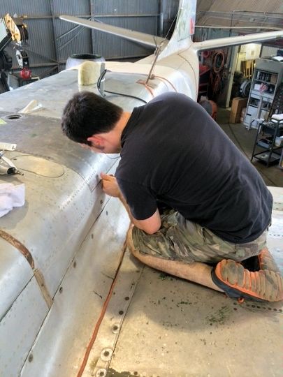

PostPosted: Thu May 28, 2015 7:48 pm

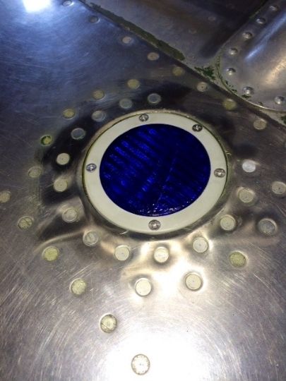

PostPosted: Mon Jun 15, 2015 8:00 pm
Posts: 2563
And here is the last formation light installed on the top of the fuselage by JR and company. Larry and Bob tested the circuits on all of the formation lights and waaa laaaa, they work!! Joy! JR drilled out the old nut plates and eliminated the old wood screws that were used to mount the light. Got it put back proper now, but it took the better part of the day. Little details like this eat up so much time. BTW, we posted this picture on our Facebook page and asked "Whazzit?" Got some interesting replies, but so far nobody has suggested "Sun Tracker". The B-29 that crashed into Lake Meade had one since it supposedly was testing an early design for the tracker for air to air heat seeking missiles. Check out our FB page as we post other pics or news over there usually of our progress. http://www.facebook.com/a26specialkay
Regards, The Other JR PS: Thanks everybody for helping us go over the 300,000 views mark. We really appreciate the interest shown by that.
PostPosted: Wed Jun 17, 2015 5:06 pm
Posts: 2997
C-130's use the exact same formation light...9 of them (313 bulb). Go gentle with the screws (easy to crack the lens). The nut-plates on the nut-plate ring tend to corrode and strip out over time...

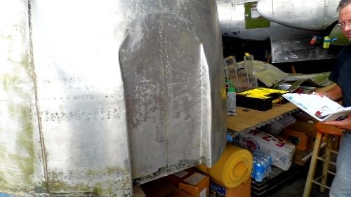

Posts: 2563
At some point, A-26A cowlings were modified so that carb air was taken in at the top rear section. This is the notch in the top of the cowl shown here. Why and when was this done? Yep, new mystery question of the week!!! JR is really pounding on getting these cowlings fitted again. When they fit, we will send out the carburetors for rework. They had been overhauled, but have since dried out. The one we thought was good came back from Anderson's with a bad report. Didn't get along with "Mona". These are about the only things standing between us pulling her outside and putting some fuel in her for the first engine start. Oh what a glorious day that will be! Does it sound like we are getting anxious?? :-) The Other JR
PostPosted: Mon Jun 22, 2015 7:22 am
Joined: Thu Jul 05, 2012 10:54 am
Posts: 93
Location: Florida/California
It seems to me I recall reading somewhere that modifications for the carbs were made because of the heat in Southeast Asia. I think this indeed had something to do with the intakes. I don't know if this is the same as what you see on the cowl... but perhaps this is the answer.

PostPosted: Tue Jun 23, 2015 9:49 am
Posts: 2563
Hi Bob, good to hear from you! You hit the nail on the head as to the why. The original air intake for the carb went thru the upper lip of the cowling for streamlining and speed. The heat from the engine though caused the air to be too hot with a subsequent reduction in engine output and other problems in the hotter climates. This was discovered not in SEA, but in the Congo in '64 when the CIA was using the A-26's in that conflict. The CIA "borrowed" five of the new K models from the USAF after several older 26's got too worn out. Hence, the conversion to the "notch" on top of the cowling feeding the carb air intake was developed. It greatly improved the engine performance and solved the problem. And that's why it is called the "Congo Conversion". JR
