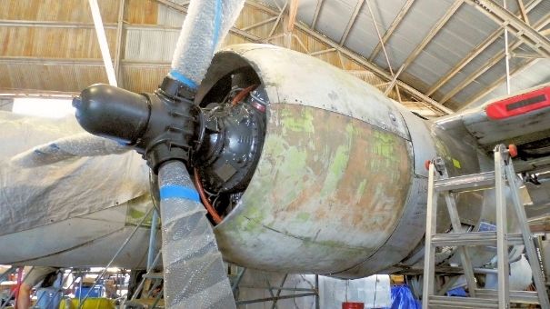

The team was a little thin this weekend as several members went off to Indiana with the DC-3 for a swar-ray up there. But we soldiered on and got several things accomplished. Alex continued working on the cowl ring mounts. He is having to engineer new ones and fabricate since so many were cracked. JR and Ray continued working on the sheetmetal of the nacelle upper covers over the vent lines and for the oil tanks. Tim assisted as needed on several projects. Stan assisted Larry in finishing the installation of the Flightstream 210 which will allow us to upload flight plans from the IPad (Bluetooth) directly to the GTN 650. The new 406 ELT was also installed and wired in to the GPS. It will broadcast N number and GPS position should something really bad happen. Just need to finish up the ELT antenna installation. Can't wait to give all those new radios and instruments the "smoke" test!! By the way, see that big empty space on top of the nacelle behind "Mona"? That is where the carburetor goes. We are just waiting to make sure the cowlings all fit before we send the carbs out for rework again. Once that is done, we should be able to put some fuel on board and pull her outside for a test run. No, we are not getting anxious..... but it is kinda like wanting to take your 9 months, 25 days, expectant wife for a ride over a bunch of rough railroad crossings.. if you know what I mean! Old wives' tale says that may get things started! :-)

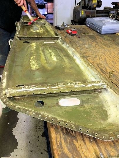

We have said before that it seems like miracles keep happening with Kay. The right person or part just shows up when needed the most. It happened again today!! JR was working on the nose gear doors which had been bent in an earlier incident. He was deskinning the door when a fella walked up and offered to help. Before long, he had the door straightened right up and just about ready to reskin. JR plans to put a little bit thicker skin back on it for stiffening. It was a great day in the hangar!!! Kudos to JR and Duke for pulling this miracle off. Doing the Happy Dance in the Republic, The Other JR

Lisa got fitted for a new prom dress today. Needs a stitch and a tuck here and there, but should be no problem for the guys to get 'er dun. Getting closer to sending those carbs off for rework and engine starts. Looks pretty good if I do say so myself. Mona got her newly overhauled oil tank filled with 120 oil today and the prop feather pump was tested. Was sweet when that baby started moving the blades and the little red light in the feather button lit up just like Larry said it would!! JR continued working on cleaning up the nose gear door. Arnold is picking up some sheet metal for the outer panel replacements. Lots going on in the hangar this weekend. The DC-3 flew a load this morning and the visiting B-17 sold some rides and tours thru the day. Will be there again tomorrow. The CAF A-26 may fly about 10 am or so for training purposes. More warbirds than you can shake a stick at. Great day to come visit the Vintage Flying Museum in Ft Worth!

Hmmmm, another gawdawful hot day in the hangar today, too. In spite of that fact, we had a new member join the team who used to serve in the AF with our avionics guys. They spent the day running the wiring from the cockpit to the right side cowl flap motor. It turned out that the motor was misbehaving and needed a stern talking to. We will figure this one out soon just as we seem to always do.... knock on wood. Yesterday was a great day as well. Lots of detail work got done. The top of the right nacelle cover is coming along nicely. The right prop feather pump runs as advertised. The cowling fitting continues so that means we are getting close to finding the right combination to unlock the keys to the engine starters. Can't wait to convert oil into blue smoke. It has a magic perfume smell all it's own. Maybe we can start on the canopies soon. Seems like that is the last big hurdle now. Keep wishing us luck to make Oshkosh next summer!!! :-)
