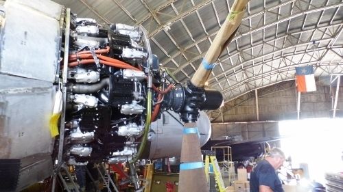

Always good to look at "Mona" but in this case, the right prop has been exercised by the prop feather pump. That's always a good thing. It means a lot of things are working and the new oil that was put in is getting to the right places. Work continues on the cowlings. Arnold worked really hard on the fabrication of attach fittings Saturday and Sunday. Most of the old ones were cracked. Might be he can get those finished soon... three left to go I think he said and we can see how everything lines up for putting the cowling on and "Mona" will have her new dress. We had an outstanding visit with two of the Nimrods, Ken Yancey and Leon Poteet...and their wives on Saturday. Demonstrated the bomb bay doors in operation for them. They were impressed with all of our progress compared to a few years ago. Hawkeye grilled some burgers and chicken for lunch for everybody and that is always enjoyed. Cold iced tea and watermelon sure were good for a nice hot July day. We hope the guys come back soon and tell us more stories. Meanwhile, we want to give a shout out to Tim Savage and crew with "Silver Dragon" at Oshkosh. Got a picture of the nose art this morning. Looking good!! Wouldn't it be grand if we could have a three ship at Oshkosh with the Dragon, Buba and Kay representing the three wars the A-26 fought in? Yes, there were many other conflicts it was used in like the Bay of Pigs in Cuba or the Congo, but those were not major US events compared to WWII, Korea and Vietnam. If you would like to see more pics of our Nimrod visit, check out our Facebook pages. http://www.facebook.com/a26specialkay and http://www.facebook.com/invadersquadron Thanks, JR

Big day for Kay. Rand, Larry, Arnold, Ed, Bryan, Inu, Chiquito, yours truly and the other JR. Started out with the new cowl flap motor on No 2 courtesy of Hayes Intl in Dothan, Alabama. Ran cowl flaps on both Mona and Lisa. Great stuff to see and hear. We felt so good about that we juiced up Lisa with about 30 gallons of W120 and ran the feathering pump. Great results there. No leaks! Prop moved. To top it off before the other JR rang the dinner bell we pre-oiled and cranked Lisa over using the starter! First time in 5 years. Woo Hoo! We are on a roll. After lunch we did the same for Mona. Film at eleven. Arnold and Larry cranked on Mona's cowl supports all day. They are getting close. To close out for beer-thirty, Bryan loaded both PR58's for a trip back to Vintage Carburetor's flow bench. The team is doing all it can to ensure we are ready to run the girls come October. The VFM October Hangar dance is a great opportunity for us to take Kay out for a much needed spa treatment. Stay tuned.
