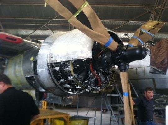

We made a little more progress yesterday. Still fabricating/installing and adjusting the No 2 cowling supports. The aft ring is complete, almost there on the forward side. Problem is if we find one needs some repositioning or adjusting we have to take several other positions off. Blower drain line is finally completed. We had the aft cowl ring off three times yesterday just to get the drain fitting properly positioned. We should finally fit the No 2 cowling next week.
FIFI was outside this past week so that means the hangar doors were wide open = wind tunnel. Spent quite a bit yesterday just cleaning up and putting things back in place.
Both carburetors are out at Vintage Carburetors awaiting a final bench / flow check. So their Reno prep activities will likely delay us some there. The plan was to install the carbs, have Kay outside for the VFM hangar dance and maybe start engines. That's not going to happen. I still have to install canopies and wind screens. Almost complete on both canopy frames, but some work just remains.
Ray and yours truly finally hung one of the repaired nose gear doors last Sunday. Hinges lined up perfectly. We need to jack the aircraft up ensure a good fit, and before we trim the new skin. Jacks are in the north hangar, and may need servicing.
Larry and Stan are starting to close up certain areas of the cockpit. Starting to look like an aircraft. We had a little guy, five years old visit us yesterday. What a treat for he and his Dad who photographed. The little guy sat in the cockpit, Larry flipped on power, lit the cockpit up. I had the young aviator flip the interphone switches at the same time so he thought he was lighting Kay up. Its all bout remembering the past but also clearing a path for the future. All the kids visiting Kay get a little A26 stamp on their hands.

Here is "Mona" getting her skirt, aka cowling, on!! We posted a shot of "Lisa" all decked out in hers on our Facebook page and asked if anybody could see any difference in the airplane. So far, nobody has seemed to notice that the cowling is finally back in place. They have guessed all around it at things that were done several weeks or months ago like the cowl flaps being operational or oil in the tanks. Speaking of FB, we just posted a video of "Mona" and the crew fitting the lower cowl to the upper. This side is still slightly off kilter and will need some adjustments. Arnold will bring a bigger hammer next week! :-) http://www.facebook.com/a26specialkay. Meanwhile, JR and Ray have the jacks in place to raise the airplane for the gear swings and fitting of the nose gear doors. JR continues to prep the canopy frames for the new glass. We are planning to have the nice folks over in Breckenridge do the honors to actually drill the glass and install it. It can be tricky plus we are trying to speed things up so we can get to engine starts soon. The report back from Vintage Carbs is that one of our carbs is ready to come back and the other is lacking one small part which should be there soon. These are the big items left to get Kay ready to clear her throat. Don't forget to tune into Warbird Radio online Tuesday (tomorrow night) for Zane Adams' interview with some of our restoration team members. Check the website for the time in your location. http://www.warbirdradio.com The Other JR

Whoa, what a day!! The gear swing was accomplished after much delay with fixing jacks and moving airplanes around for the hangar dance prep for Oct 3. The entire crew pitched in to jack up the airplane and then watched carefully as the gear was slowly pumped up with the hand pump in the cockpit by Larry. As the nose gear cleared and the uplock engaged, Ray, JR and several others went in for the nose gear door measurements for proper fit before trimming the new outside skins. Ray spent the rest of the day doing just that and prepped for shooting rivets on the skin. The cockpit canopy frames are now ready for the new glass but it will be awhile before Ezell's can do them since they are busying getting ready for the Reno Air Races. Larry and the other JR set up the new IPad to check the Flightstream 210 and GDL39 for connectivity. The very first flight plan transfer from the IPad to the 650 was accomplished! Also, the IPad properly displayed the instrument panel as generated by the combination. This is a back up to the original steam gauges since it is powered optionally by the battery pack or the ship's power. We are looking for a mount to place the IPad on the center stack of old military radios in the panel. It would be removeable on display. The lower half of the right cowling was removed and it looks like some more engineering will be necessary to get it to fit. Overall, a great day in the neighborhood. The team will be working again tomorrow if you would like to drop by before it gets too hot. BUBA and the T-6 made it back from the Lancaster show so there are other airplanes to see. The T-33 just came out of the paint shop and has been delivered to Alliance for the show there next weekend. Be sure to go see that as well. Some outfit called the Blue Angels is also going to be there to fill in during times when the warbirds are not flying. :-) The Other JR in Texas

Kay's crew has thinned out a bit, but that's ok. Can really only accommodate one person in the cockpit right now. Sunday Larry pulled the curtain back to gave me a preview of the new cockpit sidewall panels! OMG it looks like "factory" @ VNY. Lots of things going on behind the scenes and all around Kay. Arnold is pulling out all the stops to get the No 2 cowling mounts aligned properly. As it stood Sunday - really close. The fwd and aft rings have to be aligned while maintaining parallel dimension to fit the top and bottom cowling panels. Its kinda like using a Hula-Hoop for a belt, but each loop in a different trajectory. Move one, throws the rest off kilter. No doubt he will overcome and that cowling will fit like a Rolex. Carbs are on hiatus while a certain event is going on outside Reno. Some of our colleagues are attending. Good luck to all, as Rand says, "fly safe."

Nice rain in Ft Worth this morning, but the humidity in the hangar could be cut with a knife this afternoon. Nevertheless, the guys made the cowling fit on "Mona's" side. Just needs some adjustments to a couple of more brackets and it should be signed off. That was the big news this morning. Lunch was next with some good BBQ ribs and chopped brisket. This is the standard fare in most places here in the Republic. Then the guys continued prepping the cockpit for paint. Several components of the electrical system behind the pilot's seat were mounted like the Generator Controls and voltage regulators. Rand found the missing mounting plate for one of the voltage regulators so that made our "Sparky's" very happy. There are a number of wire bundles that go to the center console radios which are inoperative. So we made the decision to wrap these up and move under the platform they were mounted on coming out of the console so that we could use it to set a portable air conditioner on. Yep, it gets very hot under that greenhouse canopy so we are designing an ice chest with a blower that will blow cool air into the area for on the ground use. Texans just got to have AC in the summer, ya know? Overall, the airplane is coming right along. The cockpit may be painted and ready for display at the VFM Hangar Dance on Oct 3. The team is planning to have a reserved table next to Kay for the enjoyment of all, but you are welcome to drop by and visit. We would be happy to show everybody all the hard work that has gone into this restoration and introduce you to the people who have made it possible. The Other JR, live and direct from the Republic
