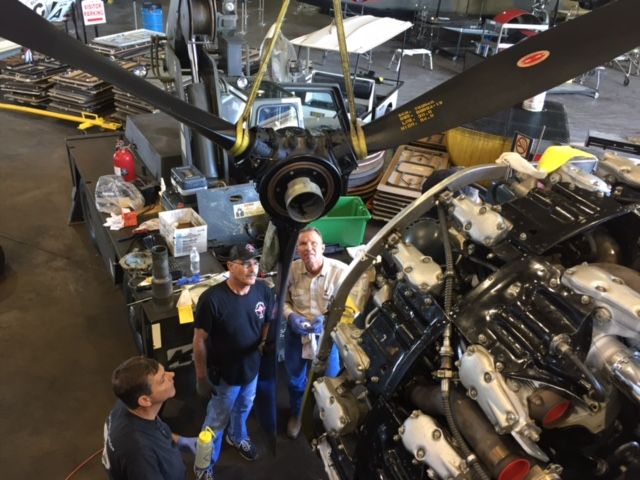

This is how "Lisa" got her groove back.....OK, so it is a prop. Close enough! "Ichabod Crane" lifted the engine and the prop with ease. Anyway, except for one part that didn't get included in the shipment of the engine back to Ft Worth, everything will be completed when it arrives....the cone for the prop shaft. A new retaining nut was found for the prop still in the original 1957 packaging and preservation. It was pristine. Should be ready to test run when the B-29 leaves the hangar to go to New Orleans in a few weeks. We have two major systems to finish before taxi trials: the emergency brakes and the engine fire extinguisher system. We are really starting to see the light at the end of the tunnel, but we are reluctant to set a hard date for the first flight. Every time we do that, Kay finds something else for us to do. Let's just say that we are hoping for a early 2017 date. We want to get it painted and then start marketing to airshows. Oshkosh is back on the drawing board. If there are any airshow directors who are interested in having Kay come visit, please PM with some dates and details. Thanks!

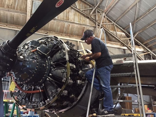

Here is "Lisa" our right engine that we just got back from the shop firing up for our test runs. She made some oil smoke for us and that was a beautiful thing. Crew Chief JR is on the headset giving pilot JR and Larry a play by play. We keep the ladder handy in case we need to get up on top with the fire extinguisher or the crew needs an escape path. We can go out of the bomb bay or swing off the wing, but that is a far drop for this old guy. Larry, on the other hand, climbs all over the airplane like a monkey. He used to work on F-16's so is used to it. We wrote up a few squawks on things that were not working quite right. Chuck and Larry have been working those off during the week as the Day Shift. The Weekend Shift will finish up anything left and we plan to run engines again while the B-29 is out of the hangar to New Orleans. Then it will be back to making ready for taxi trials since we still lack the emergency air brake system and engine fire extinguishing system. Stay tuned. JR
