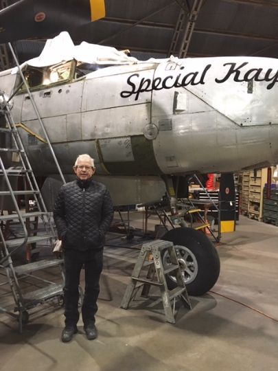

We had a very nice visit from the last man to fly Kay. Al Maxwell helped prepare and then fly the airplane from Billings, MT to Ft Worth, TX. He was impressed with what we have done to fix 'er up since he nursed it home. Al flies the other former Lynch Air Tanker, "Fire Eaters" in the Houston area. You may recall it was used in making the movie "Always". Kay contributed her engines and props which were stock for the B model at the time so that the airplane that ruined its engines making all those retakes of the out of gas landing could finish the picture. Kay later got R-2800 CB-3's and 43E60 props out of the deal which put her back closer to the original. The CB-3 just doesn't have high blower like the CB-16 for the most part. Anyway, we were happy to see Al and hope he comes back again. He helped get us started on the project. We very much appreciate that. JR
