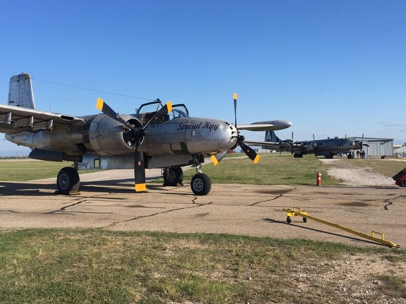

Today, Kay and FIFI had good maintenance runs. We have a couple of minor write ups. All in all the cockpit was thumbs up. Of course Kay was her stubborn self. We had liquid locks on No 1 and No 2. That will go away as we contemplate more frequent runs. FIFI has traded places with Diamond Lil. Once FIFI is on the road Kay will have easy access out of the hangar. Back tomorrow to adjust No 2 carb and clean plugs on No 1. Film at eleven.

Just posted a picture of our A-26 running up on the same ramp as the B-29. Wonder how long it has been since that happened in the military setting? FiFi will probably leave out for the west coast tour the latter part of the week! We wish our hangar mates well! JR

Next to flying, today was Kay's greatest day since she's been in Fort Worth. Taxied all the way to the approach end of 16, the North end of Meacham) and did a run up. Very satisfied with the outcome. Kay wanted to jump those brakes. So I think she eager to take to the air. A little tweaking still to do on the left carb, and we'll try it again tomorrow morning. We also had a nice visit with Bob S, (N917Y) from Salt lake City. Bob and I have been communicating for several years. Was great to compare notes with him and Grandson Boston, as Bob has an On Mark A-26.
