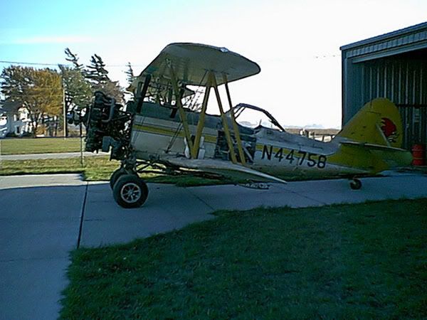

Thanks for the pics. Do you know where the Ebay one went to and how much it sold for? A friend invited me to his EAA Chapter meeting in a couple of weeks and they are doing a presentation on the N3N. Apparently someone in middle Tenneseee has bought one that is airworthy.
I know it's a "pipe dream" but the one's still set up as crop dusters interest me because I have a farm and grass strip and could actually get some use out of it in that configuration. A Stearman would be a good choice also but the N3N is way more cool.
