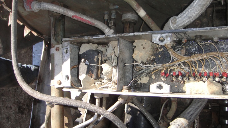

Here are a few shots from the work we were doing to get her ready for the flight home
It is interesting when you open up one electrical box to find it pretty crusty and loaded with mud dauber nests. The induction vibrator was packed pretty good with them...

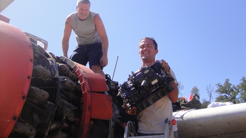

This is Cade who is working on pulling the left carb for overhaul about a month ago.

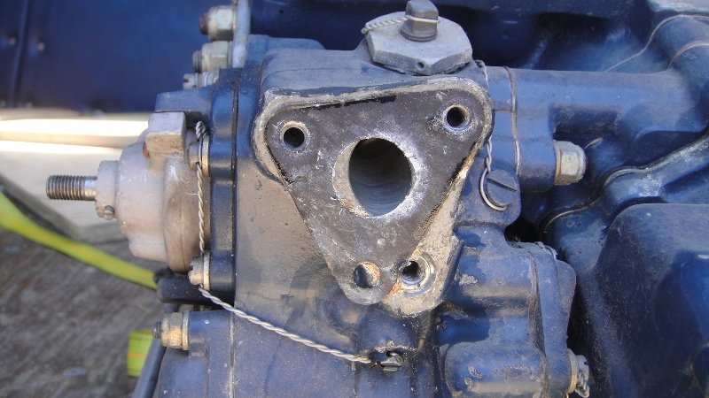

When we were pulling the carburetors we found that the gasket for the left main fuel feed tube (from the carb to the blower housing) was installed incorrectly and was restricting the fuel flow.
Steve asked me to take the carburetor from him. I said wait a minute while I take a picture, Funny how he can cuss me out and at the same time smile for the camera! :lol:
