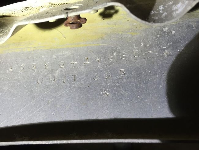

More B-29 tail data is coming in! This time for B-29A-60-BN 44-62022, Craft Number 11499, produced at Boeing Renton Washington, "Peachy", Pueblo Weibrod Aircraft Museum, Colorado. Recovered from China Lake.
Note: Per the Pueblo Weibrod Aircraft Museum, the tail on their aircraft, as it is displayed, IS NOT the original tail, but they still have the original tail in their collection. The original tail was too far damaged, so they replaced it.
B-29A-60-BN 44-62022 was the 813th B-29A Boeing, Renton Washington during the 60th Block of production:
Craft Number 11487 B-29A-60-BN 44-62010 to Craft Number 11586 B-29A-60-BN 44-62109 (900 B-29A's produced, total, at this point in production at Boeing, Renton Washington).
The tail currently mounted on B-29A-60-BN 44-62022 "Peachy" is marked ASSY 3-14335-13 UNIT 940 (not her original tail), photo taken February 19th 2015:
The original tail (not currently mounted) for B-29A-60-BN 44-62022 "Peachy" is marked ASSY 3-14335-13 UNIT 813, which is EXACTLY number for number in line with the production data I have collected here so far, photo taken February 19th 2015:
B-29A-60-BN 44-62022 "Peachy" at the Pueblo Weibrod Aircraft Museum, Colorado:
B-29A-60-BN 44-62022 "Peachy" Tail Enclosure at the Pueblo Weibrod Aircraft Museum, Colorado:
So, B-29A-60-BN 44-62022 "Peachy" was the 813th B-29A Boeing, Renton Washington and her original Tail Enclosure is ASSY 3-14335-13 UNIT 813. The linear production UNIT number for her tail IS the linear production number of the aircraft. Perfect! :)
As for the tail currently mounted on the B-29A-60-BN 44-62022 "Peachy", ASSY 3-14335-13 UNIT 940, this tail is probably from a B-29A that was produced in the Block 65 of Boeing, Renton Washington.

It is time to resurrect this thread with some recent findings to prove the identification of the “Silver” B-29 tail in my collection.
The purpose of this thread was to document and identify the B-29 Tail Enclosure Unit Numbers to prove that they can be used to identify the history of the exact B-29 that they went to. The findings in this thread have been very fun to unravel and it has proven that the Assembly (part) number and Unit Number do in fact directly correlate to linear production of the tail enclosure at the two Boeing B-29 Factories. The the UNIT NUMBER is in fact the linear production number of the B-29 Tail Assembly.
First, I have to document some known data, before I come to the conclusion of my recent findings.

Tail Enclosure Part Number 3-14335-10 was used on:
C/N 7231 B-29A-1-BN 42-93824 to C/N 7250 B-29A-1-BN 42-93843 = 20 Aircraft
C/N 7251 B-29A-5-BN 42-93844 to C/N 7280 B-29A-5-BN 42-93873 = 30 Aircraft
Tail Enclosure Part Number 3-14335-12 was used on:
C/N 7281 B-29A-10-BN 42-93874 to C/N unknown end number
Tail Enclosure Part ASSY 3-14335-13 UNIT 813 was found on B-29A-60-BN 44-62022 “Peachy”, Craft Number 11499 (Pueblo Weibrod Aircraft Museum, Colorado). This was the 813th linearly produced B-29A Boeing, Renton Washington.
So now for the conclusion: The “Silver” Tail Enclosure in my collection is marked: ASSY 3-14335-13 UNIT 998, with all of these finding in this thread, this tail should have been built in the last part of the Boeing, Renton Production Block 65. I had the aircraft data card pulled from the Air Force Historical Research Agency at Maxwell AFB, Alabama for C/N 11685 B-29A-65-BN 44-62208 the 999th B-29A produced at Boeing, Renton - which fit closely to which aircraft could have come from. And this is the service history of the aircraft:
Manufactured by Boeing Aircraft, Renton WA, accepted August 31st 1945 and delivered to the USAAF on September 4th 1945.

More B-29 tail data surfaced. This is the tail data from Nick V's tail:
ASSY 3-14335-13 UNIT 335
The Assembly Number with -13 (dash13) appears to have only been used on B-29A's built at Boeing's plant at Renton, Washington plant. This tail would have been installed on a B-29A in the Renton Block 35 of production:
C/N 10987 B-29A-35-BN 44-61510 to C/N 11086 B-29A-35-BN 44-61609
Linearly the 335th B-29A built at Boeing, Renton was C/N 11022 B-29A-35-BN 44-61545.
So, giving a plus one/minus one approach in production, this tail could have been delivered on one of these B-29A's:
B-29A-35-BN 44-61544 Assigned to 611BU, Off Inventory 7/14/1954 Salvaged at Davis-Monthan
B-29A-35-BN 44-61545 Assigned to 4141BU, Off Inventory 9/15/1953 Reclaimed Pyote
B-29A-35-BN 44-61546 “Hun-Da-Gee” Triangle N 20 (2) 444BG, Off Inventory 9/27/1954 Reclaimed McClellan
