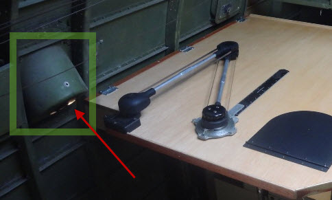

Question, sir.
What was this part of the aircraft for?
A 'relief tube' for the exceptionally endowed? :shock: :wink:

Flare gun port?

That's where the fuel line attaches for the fuel tank which sits under the Nav. table...if memory serves it held an additional 200 gals or so(don't quote me on that) And that project looks great!! Flare gun tube goes above that table and the larger flare tube mounts behind the radar operator :D

Dave gets the Pony, of course since he is a fellow PV-2 nut. It is the filler neck for the fuselage fuel tank, a future project. There is a 165 gallon self sealing rubber fuel tank that sits in that big cavity under the navigators table. Military aircraft, in their fighting trim, rarely have spare room and the Harpoon is no different. Imagine a massive rubber fuel tank right under your nav table. There isn't even any room for your legs under the table as the tank butts right up against the raised center floor board. The navigator, when seated, would have to spread his legs so to speak to be at his table.
The Harpoon was a long range patrol aircraft and they put fuel wherever they could; outer wings, inboard wings, drop tanks, fuselage tank, forward and aft bomb bay.
I have been fabricating the parts needed to install the fuselage tank and I am close. The plan is when the nav table comes out for final finish then the fuselage tank goes in. Just getting it through the door and into place will be a chore. I think Larry was the one to first ask how was I going to get the tank in past the radar station that I was making at the time and I had that goofy look on my face with the question mark parked over my head that said good question. A few measurements later determined that the only thing to be removed is the Radar seat and it should slide by the racks. We will see!
Yesterday Cade welded up one of the parts we needed to fabricate for the fuselage tank and we have a couple of others to do and then we will be ready to install it. The parts are for the flanges that attach the filler neck to the tank and other fittings. Imagine a big 3 inch filler tube from the part you asked about to the tank under the table. Hopefully soon I will be able to show you that installation in photos as we are getting close.

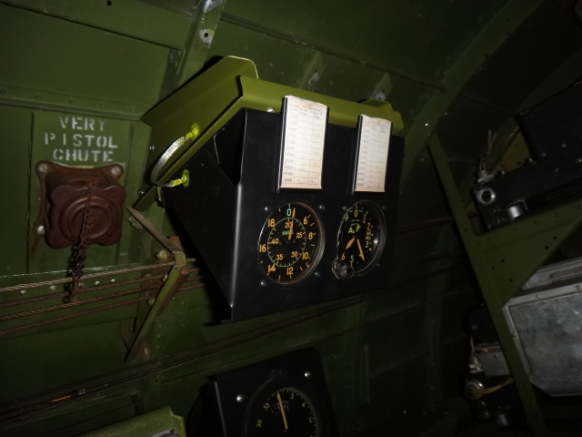

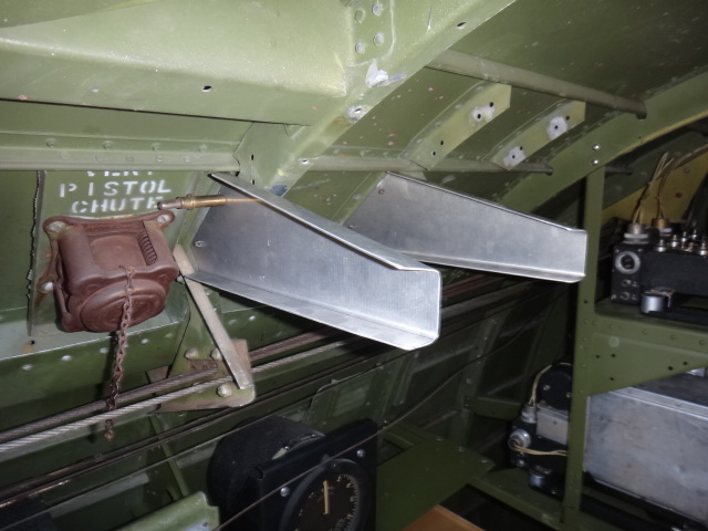

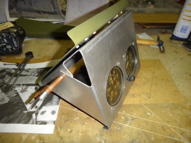

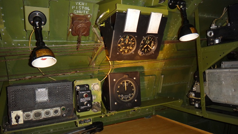

Above the flux gate shelf is an instrument panel with an airspeed indicator and an altimeter. I have noticed that there are a lot of variations from early to late Harpoons and there isn't much information on this late style panel so I had to scale it up from a few photos. Using existing mount holes, witness marks and photos you can scale the parts pretty accurately.
Starting with the mounting brackets
Incidentally the rusty thing is the flare gun mount. It was/is still installed and needs some work like everything else!

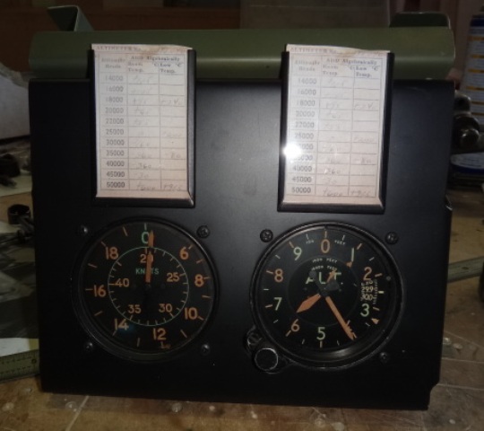

Sometimes when I am on a roll I seem forget to take photos so I have to jump to finishing up the instrument panel.

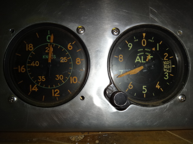

I found a near matching set of Navy instruments with the munsell green finish commonly found in the Harpoon. It looks like the altimeter is vertically challenged and is in need of some serious care. It's only reading about 6,640 feet high. Isn't that in tolerance? Looks good anyway until I can get it repaired. The cutout for the Kollsman knob is right to the spec's in the AN drawing but it sure has a gap. Another altimeter fits the cut out better but this Navy altimeter is the one to use.
Some paint, correction card holders and cards added and in it goes. I need to find an airspeed correction card.

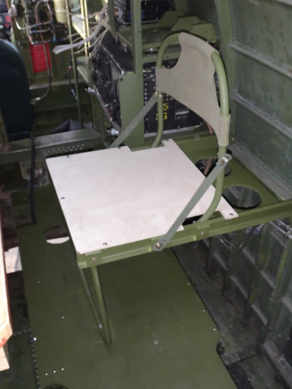

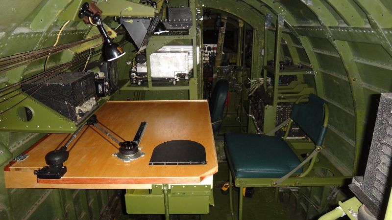

Next is the nav seat. Once again a lack of photos happens during jam sessions, sorry about the spotty coverage on some of these projects.
A board for the base and the cushion is fabricated and sealed then the seat is fit in place with bushings and hardware.
Then the seat comes back out for upholstery
The Navigators lights are the next project and brackets are fabricated and new old stock lights are fitted along with a rheostat.
With the seat upholstered, installed and the lights in place the Navigators station is becoming more complete.
Before:
and earlier today:
