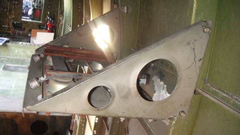

Stainless steel muzzle flash panels for the turret installation.
Fly low. Fly slow, Fly safe.

Are the panels stainless or just thicker aluminum? The PV-2 has them for the top turret as well as for the two .50 guns on the top of the nose section...

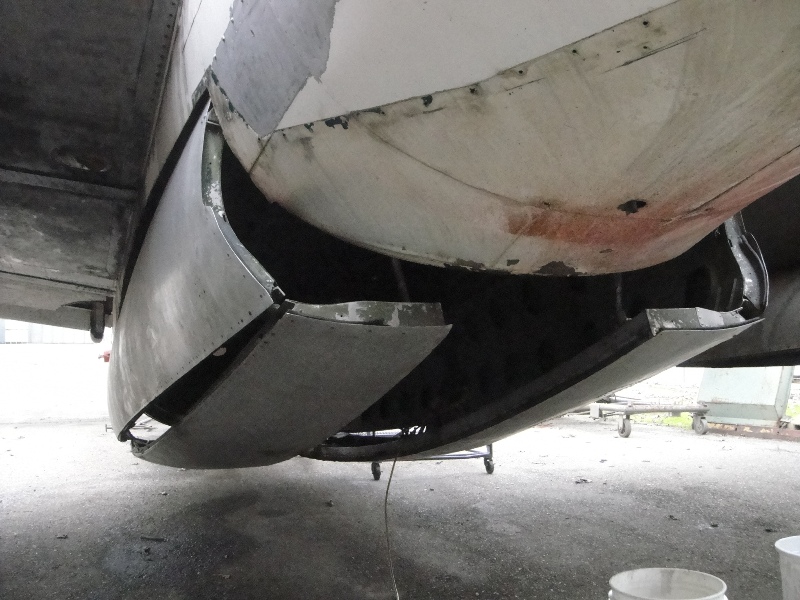

You got me, we did get her up and running and off to her first air show. I'm sorry for the lack of updates as we have been crazy busy lately but better late than never, right?

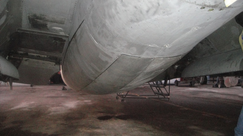

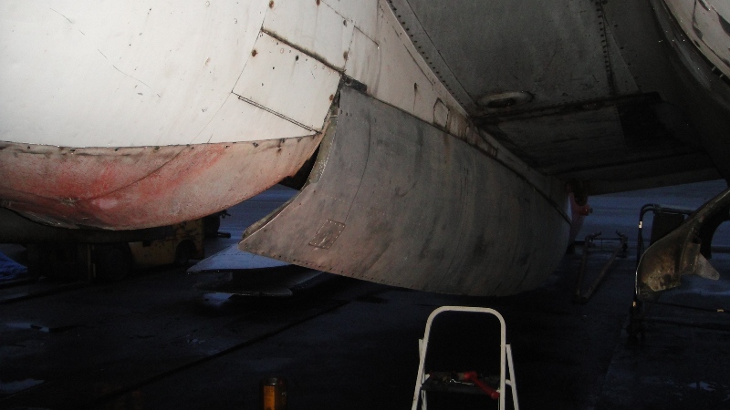

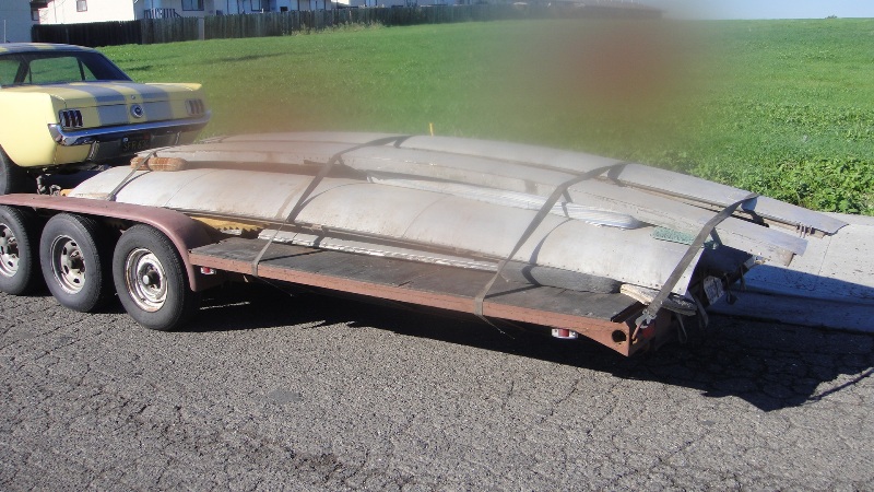

After our last flight back on Veterans day we dropped the retardant tank out of the bomb bay and made the commitment to finding the bomb bay doors before we could fly again. Thanks to several very kind folks (especially you Fred!) we were able to acquire the set of doors that actually came with our Harpoon when she flew to California. I do not think that these doors are the very doors that actually came from our specific aircraft but they were sold with her and were trucked from Pennsylvania along with a bunch of engines. Even though they were likely from another Harpoon the doors fit great. They are beat up a bit inside and have some of the channels cut and reinforced and they still need some work to be all beautiful again but beggars cannot be choosers where Harpoon doors are concerned. We are all giddy just to have a set :D
Aren't they beautiful? Sorry for the poor picture, it must have been the drool fowling the lens!
The next step was to hang the doors and get them operational. Finding the doors is one thing but to track down all of the parts needed to hang them and make them work is quite another thing. Once again we were fortunate in that most of the hard to find parts were stored in the back of the Harpoon when we first looked inside. The cylinders, hinges, plumbing and links were all present except for one cylinder mount and a rod bracket which we fabricated until we can find the originals.
There is a learning curve with the doors, as with any new project, and even though you have two of the fittings that look correct you can find out that you might just have two rights and no lefts. This was the case with several of our parts like the center hinge castings. They look identical and also have the same casting number but the differences are subtle. Here is a shot to show what I mean. The angle of the main hinge bolt is machined several degrees off on two axes for the right and the left.
Thankfully, we had some spares that came with the doors and were able to come up with a right and a left. Once again the Harpoon Gods are smiling down upon us.
Here is the first door, the left hand upper, being fitted. Check out the mud or fire retardant that was splattered under the tank fairing. This stuff is corrosive I am told but it didn't eat up our Harpoon at all. Amazing :shock:
Man is this a fun project. Gotta love bomb bay doors and these are big!
And then all four doors are in place, but will they fit when closed?
After rigging the cylinders and door rods we pumped the doors closed with the hydraulic hand pump and amazingly enough the doors fit beautifully!

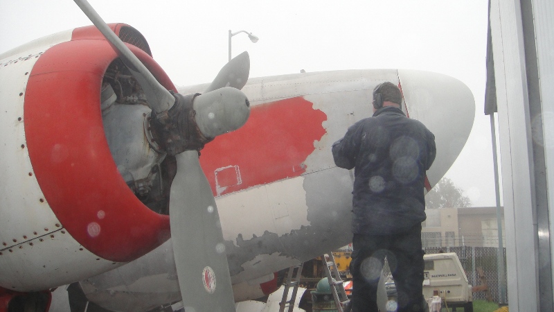

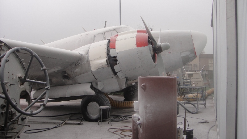

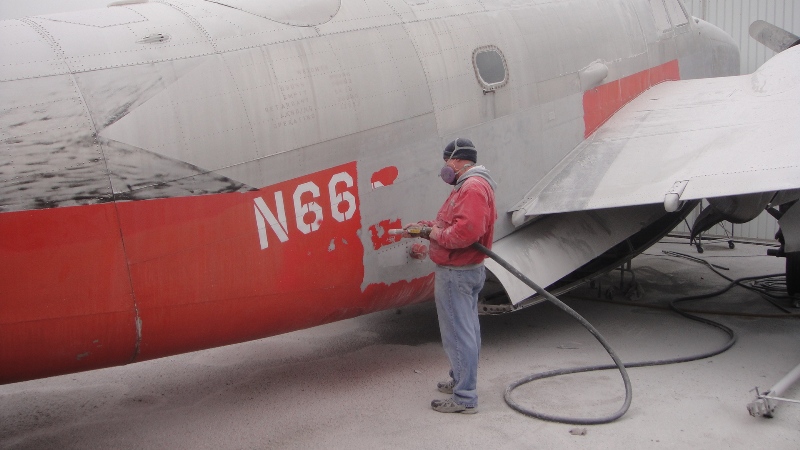

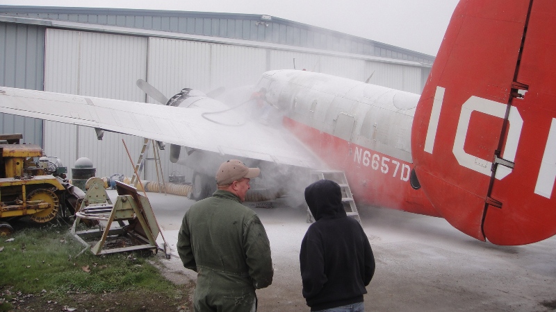

The next project was to strip the paint. We have been exploring all the different methods and decided to gear up for sodium bicarbonate or soda blasting. There are many benefits to using baking soda as a blast media and the number one is that it is non toxic and earth friendly. I like the fact that it is not supposed to alter the substrate or skin of the aircraft. I find that it does slightly roughen up the finish which would make polishing the aircraft more difficult but is perfect for a painted finish. They even say that if you blast an anodized finish it will not hurt the anodize which I find to be true.
The major draw back to soda blasting is the residue is pretty much like leaving salt on your aircraft so it is imperative to remove the dust by air and washing with plenty of water. You can also neutralise the baking soda with vinegar if necessary. I believe that this method is better in the long run as the amount of toxic waist is dramatically reduced and the possibility of leaving chemical stripper in the lap joints and other hidden places in the aircraft is also dramatically reduced since the baking soda is so water soluble. We even chemically tested the paint for lead and chromate to be sure that wasn't going to be an issue as well and thankfully none were found.
The blasting begins:
We built up our own soda blast rig as it was cheaper for us by a long shot. Its a great rig and I am very happy with the results. We did turn the Harpoon ramp into a winter wonderland though. The soda does vacuum up nicely. We provided positive air inside the airframe to keep the dust out and that worked beautifully.
Here is Cade working on the aft fuselage. So long tanker 101 paint. We even found some of the original factory blue paint under the retardant tank fairing and in other nooks and crannies.
Ken and Mike supervise to be sure Cade is doing it right!

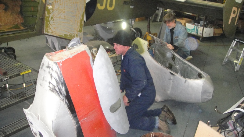

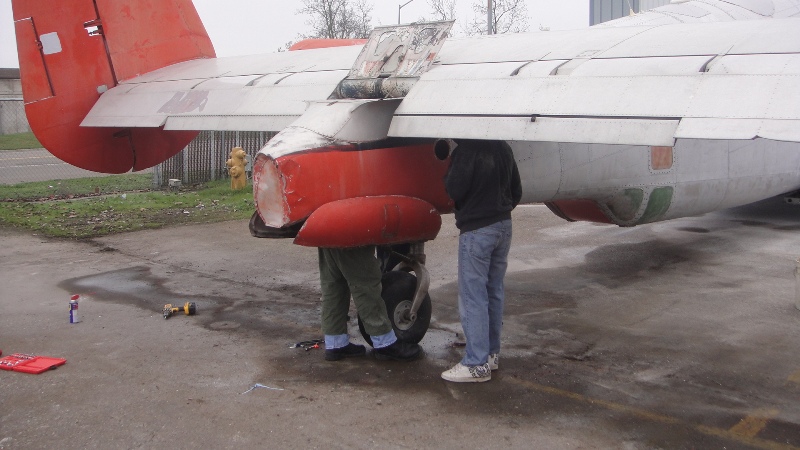

Then Ken and Mike take on the tail cone problem. Our tail cone was punched in and had a pretty crude patch put on sometime when she was in tanker service so I bought another tail cone from Carl Scholl at Aerotrader to swap ours out. The one from Carl had some heavy corrosion in the areas typically found in Harpoons caused by the mud collecting. Ricky ground out the bad spots and made a patch to repair the damaged areas. We hope to fully repair our tail cone as it has no corrosion at all and replace it some day. The tail cone is spot welded together with large stampings inside so it will be a long term project. In the mean time we have a serviceable one that will do for now.
Ken sure gets into his work. Here he is inside the tail cone as seen through the elevator gap flap.
Here is Ricky and Mike reworking the two tail cone assemblies. They look so serious!
A lot better than what we had which is pretty much our motto on this project: You should have seen her before we started!
She may not be the prettiest Bell at the Ball but were making progress!
