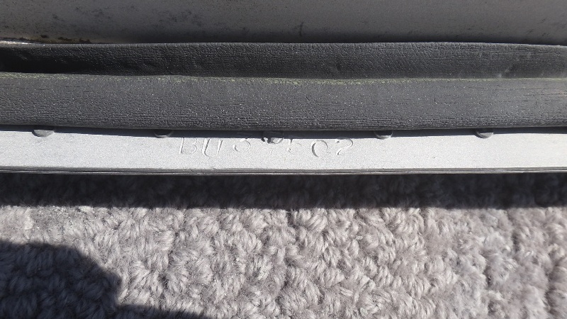

On one of the pictures I posted via the dad-blamed photobucket, you can see on an inner wing rib located at the production break between the center section and the outer wing panel, there is a painted on set of four numbers, that have appeared on every PV-2 that I have ever seen, when the wings are removed. These numbers are the last four of the Lockheed production number. My bird is Lockheed 15-1200, so the four numbers painted on the ribs are 1200...in this case 1468 which is 15-1468.
If you look back in some of my earlier posts, you can see these numbers on Pooners PV N7257C, and the two PV's that I took pictures of in Louisianna.
I have also heard of the path of this particular PV, as it made it's way from Wisconsin, to Borrego Spgs., Ca., to Branson. I just could not confirm, as all the console data plates were removed, and I couldn't find any trace of N-numbers beneath the paint, or any other means of identification.
This ole girl has been a brain strain for me for too long, and it's good to know my obsession has closure.

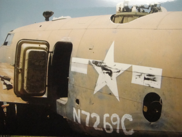

A little history on 1468-37502-N7269C: This was one of the few PV-2's that was never modified for tanker or other civil use. I first saw it in 1979 or so at Falcon Field when I worked at the Pima Air Museum. At that time it was sitting on its gear without outer wing panels and the nose was off at the production break just forward of the windshield. I remember crawling inside the fuselage through the original door and wondering why the door was so thick. Bob Johnson, the director of restoration at Pima, said it held a raft and emergency supplies. I was amazed that it was so complete inside with all of the crew stations and equipment still in place. This PV-2 and the one at Pima were very complete and pretty much the only surviving Harpoons that were untouched from when they left the service.

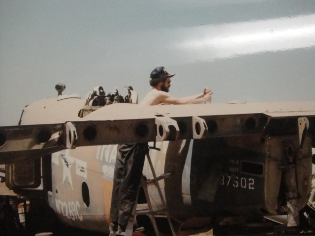

Probably not long after I was at Falcon Field, the CAF in Wisconsin decided to build a PV-2 and they chose an ex air tanker and made a deal with the what I think was Gene Packard's outfit (Globe?) to get it ferriable. The CAF also bought the fuselage of 37502 for its interior fittings.

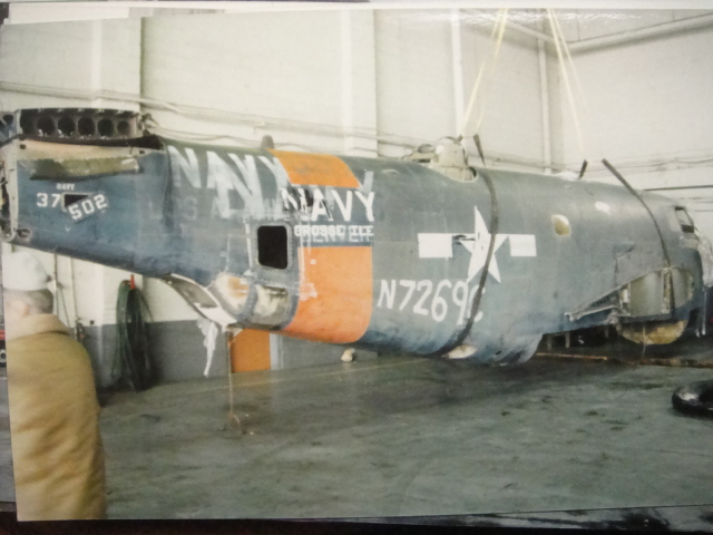

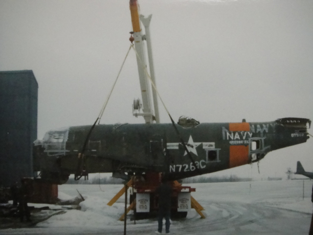

The CAF had the wings cut off at at the fuselage and the horizontal was similarly cut. The remaining fuselage, sans nacelles, were transported to Wisconsin where they stripped the interior.
I was told by the CAF that the remains of the fuselage was scrapped a long time ago. I guess not but since the wings were cut off it would certainly explain why the aircraft came apart so readily in the storm.

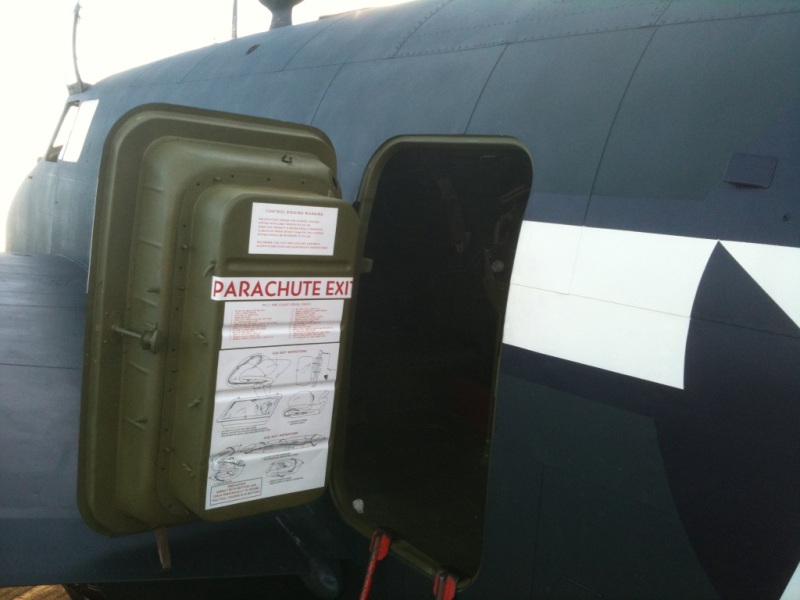

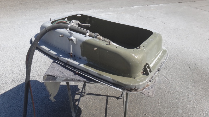

The door of 37502 that I mentioned going through as a youngster in 1979, pictured below, was one of the things I tracked down. It was a lot better than the original door on 062 so it has been fixed up and installed on 062. I know it sounds silly but it gives me a good feeling to have this door, that I have some personal old history with, flying again on 062. The other parts I have come across from 37502 are finding their way back on to flight status inside 062 so at least some of the old gal will continue on.

Thanks for another angle on this PV's shady past! The Pics are very cool also. There were several Harpoons that went hither and yon over the years. I have heard that John Hirth had bought a couple of PV-2's and had them trucked around the states. I have heard of one from Louisiana, and another one or two from Arizona. The one from La. went to Columbus, Nebraska and has since disappeared ...
Kurt "Grasso" told me that 1468's wings were cut by Carl, where Grasso had it hauled to Branson, where he engineered the spar patch to attach the wings back on as well as the steel structure inside the bomb/torpedo bay.
The cut was made in between the fuselage and the engine nacelle, approx. 20" wide. The top and bottom "C" caps were braced with steel straps bolted on each side of the cut...straps were about 40" wide. The aluminum web between the spar caps was constructed out of two thicker aluminum plates...one to the front and one on the back, approx. 20"X24", and bolts ran thru both plates as well as what was left of the original spar web....a very sound connection.
