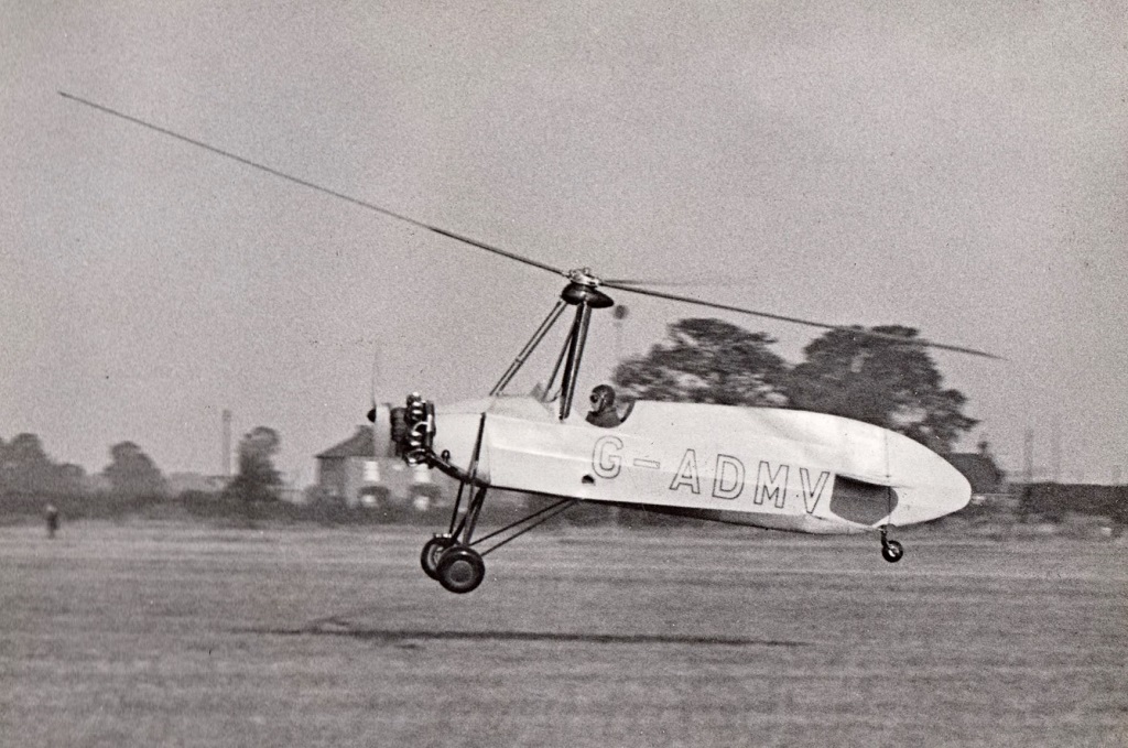

September 1935 saw the Hafner AR III autogyro fly for the first time. It wasn't the first autogyro to fly but it was the first to fly using cyclic control of the rotor, it was the first to have collective control allowing it to perform what its builder called a 'towering take-off, ie a vertical one. The use of both cyclic and collective control made the AR III the first rotorcraft to fly successfully using the method of control now common to all helicopters. Incidentally Hafner's earlier attempt at rotary flight the Revoplane II of 1931 was an experimental helicopter that also had the combination of cyclic and collective control but lack of power (and a tail rotor) means I can't award it 'a first'.
Hafner saw the concept of the autogyro as a way to develop his ideas for helicopters free from torque reaction and post war his method of rotor control flew successfully on a number of British helicopters namely Sycamore, Belvedere, Scout/Wasp and Lynx.

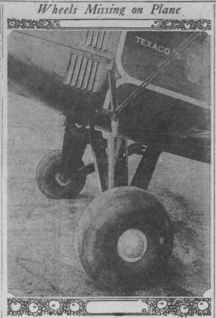

A radar altimeter, called a "terrain clearance indicator", was first tested in a United Airlines aircraft on 8 and 9 October 1938.[1][2] Unfortunately, while finding news about the event was easy, determining what the specific aircraft was has proved difficult. (In the process, I found a story that mentioned an "automatic direction finder" was tested on an American Airlines DC-3 around the same time.) While a picture on page 5 of the 25 October 1938 of the Kansas City Times shows the interior of the aircraft, but does not name it, an article on page 4 of the 10 October 1938 Daily News states that: "United Air Lines used its famous "White Tail" Boeing flying laboratory for the test flight." Although the specific model is not stated, based on the aforementioned picture it seems to be a Boeing 247.
EDIT (21-08-02): An article in the January 1939 issue of Popular Aviation provides a bit more detail about the invention of both the radar altimeter and the automatic direction finder.
Warbird Philosophy Webmaster

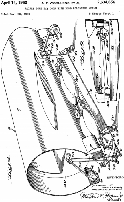

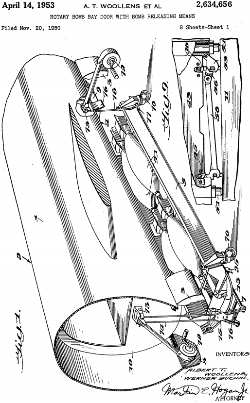

Another first I recently thought of was the first aircraft with a rotary bomb bay. In the process of trying to find the answer, I learned there is a distinction between a "rotary bomb bay" or "rotary bomb bay door" and a "rotary bomb bay dispenser".
The first aircraft with a rotary bomb bay door was apparently the XB-51.[1] Patent number 2,634,656 for the "Rotary Bomb Bay Door with Bomb Releasing Means" was filed on 20 November 1950:
2,634,656 - Rotary Bomb Bay Door with Bomb Releasing Means.png [ 187.71 KiB | Viewed 6818 times ]
(Source: United States Patent and Trademark Office)

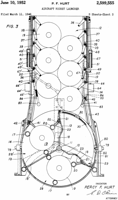

Apparently, in its early days the concept was popular as an application for launching rockets, not bombs, as many early patents for the concept mention rockets by name:

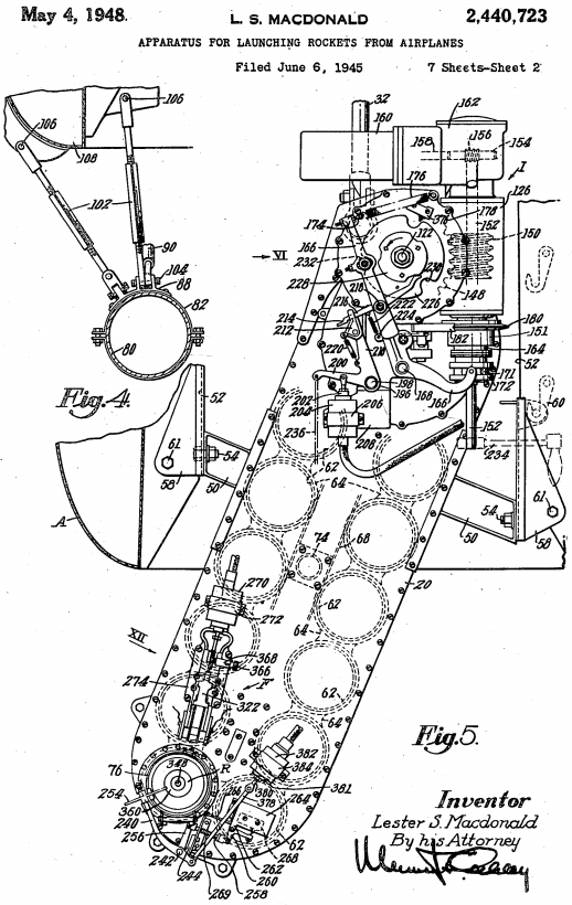

  • Apparatus for Launching Rockets from Airplanes (2,440,723) filed by United Shoe Machinery Corporation on 6 June 1945:
    2,440,723 - Apparatus for Launching Rockets from Airplanes.png [ 182.81 KiB | Viewed 6818 times ]

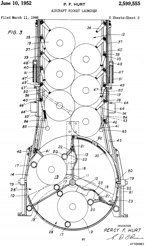

  • Aircraft Rocket Launcher (2,599,555) filed by the Department of the Navy on 11 March 1946:

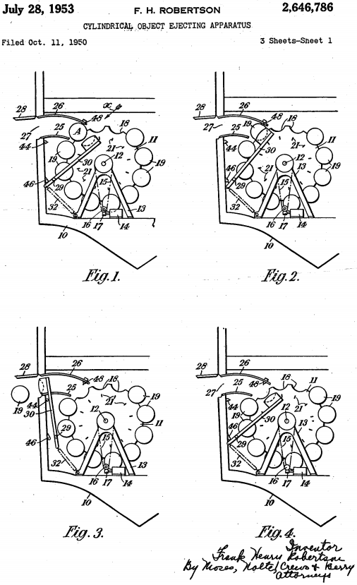

  • Cylindrical Object Ejecting Apparatus (2,646,786) filed by Saunders-Roe Limited on 11 October 1950:
    2,646,786 - Cylindrical Object Ejecting Apparatus.png [ 121.88 KiB | Viewed 6818 times ]

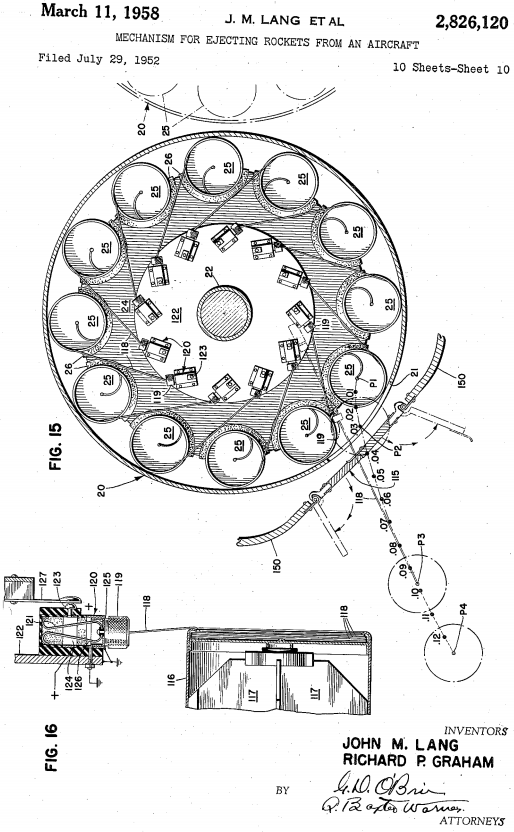

  • Mechanism for Ejecting Rockets from an Aircraft (2,826,120) filed by Chance Vought Aircraft on 29 July 1952:
    2,826,120 - Mechanism for Ejecting Rockets from an Aircraft.png [ 161.87 KiB | Viewed 6818 times ]
I have to wonder if the Navy patent may have been related to the 5-inch rocket launcher that was tested in the nose of PBJ-1J, BuNo 35849, at China Lake in the late 1940s:

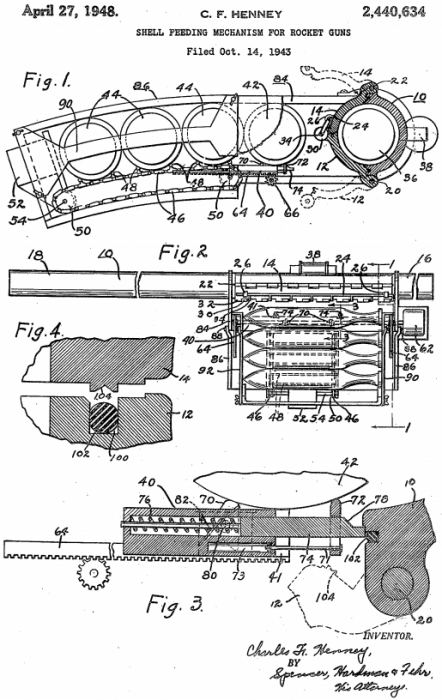

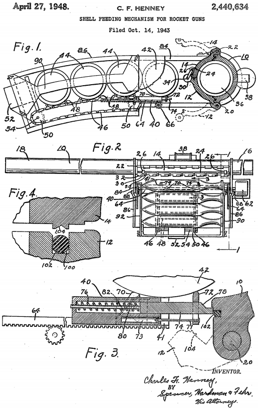

  • Shell Feeding Mechanism for Rocket Guns (2,440,634) filed by General Motors Corporation on 14 October 1943:
    2,440,634 - Shell Feeding Mechanism for Rocket Guns.png [ 199.57 KiB | Viewed 6817 times ]

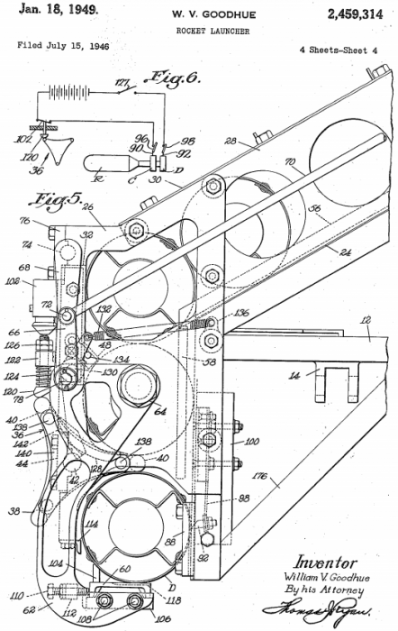

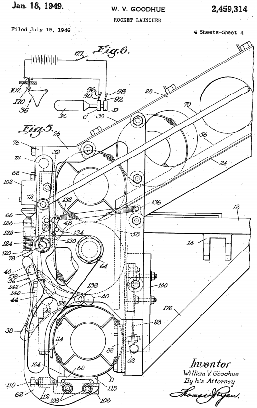

  • Rocket Launcher (2,459,314) filed by United Shoe Machinery Corporation on 15 July 1946:

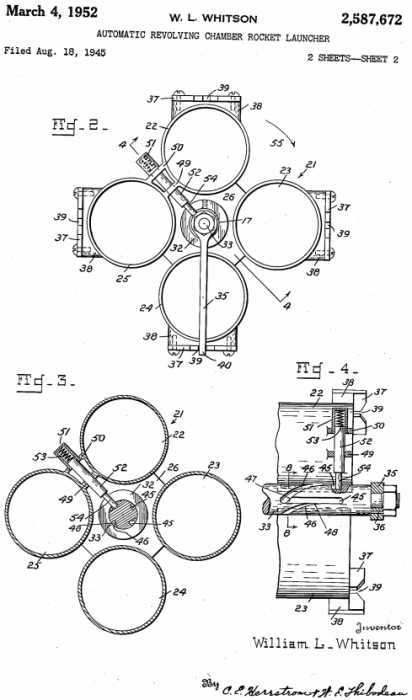

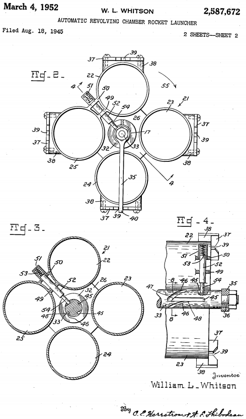

  • Automatic Chamber Revolving Rocket Launcher (2,587,672) filed by William L. Whitson on 18 August 1945:
    2,587,672 - Automatic Revolving Chamber Rocket Launcher.png [ 112.43 KiB | Viewed 6817 times ]

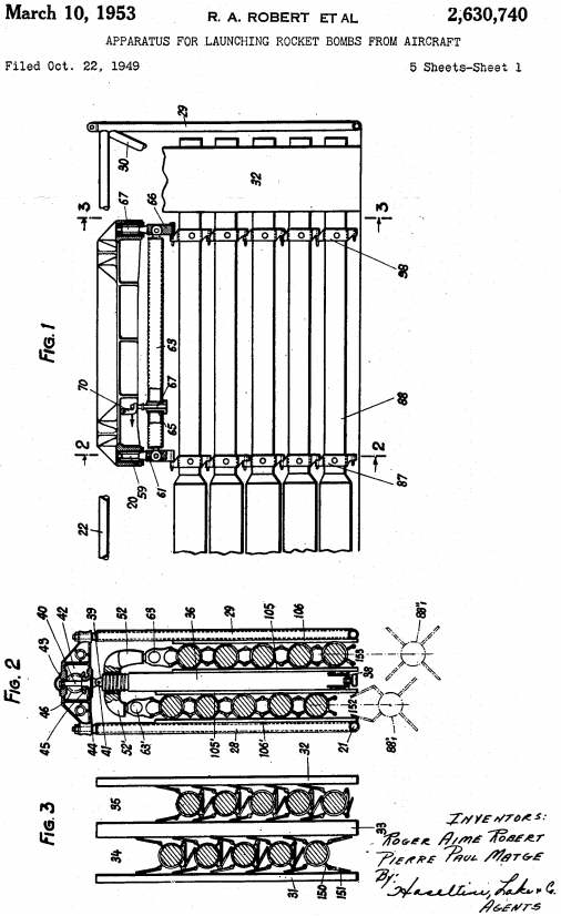

  • Apparatus for Launching Rocket Bombs from Aircraft (2,630,740) filed by Robert Roger Aime on 22 October 1949:
    2,630,740 - Apparatus for Launching Rockets Bombs from Aircraft.png [ 121.02 KiB | Viewed 6817 times ]

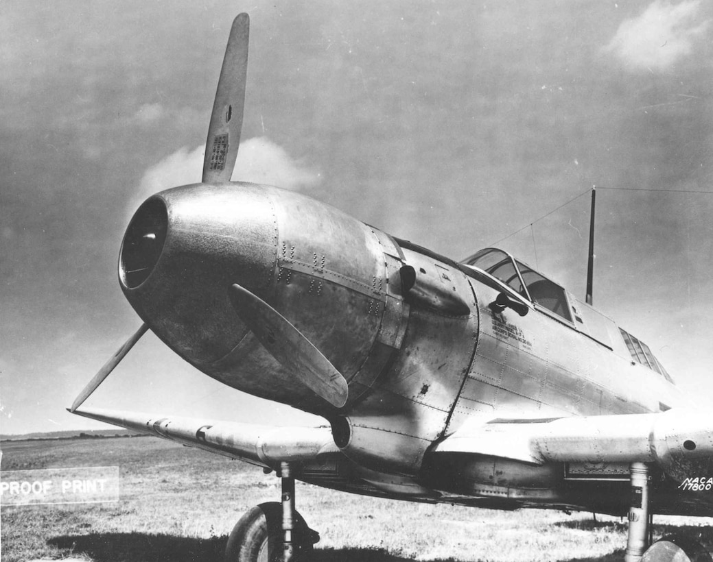

PostPosted: Mon Feb 01, 2021 10:16 pm
Posts: 2011
Location: Cincinnati, Ohio
The first airplane to have a ducted spinner is a very close race. A modified A-17A (36-184) tested by NACA, the Fw 190 V1, and the Me 209 V4 all used ducted spinners around 1939.[1] The Fw 190 V1 first flew on 1 June 1939, so that date is firmly established.

The A-17 was supposedly in use by NACA by 1939, but the caption for a photo depicting the A-17 with the wing root ducts installed states it was taken 3 April 1940 and the ducted spinner was supposedly installed after the wing root ducts.[2][3]
(Source: National Museum of the United States Air Force)
Unless the ducted spinner was not installed from the start, the winner appears to be the Me 209 V4, which first flew on 12 May 1939.[4]
EDIT (24-05-06): More information on NACA testing with ducted spinners can be found in reports titled Development of Cowling for Long-nose Air-cooled Engine in the NACA Full-scale Wind Tunnel and Review of Flight Tests of NACA C and D Cowlings on the XP-42 Airplane.

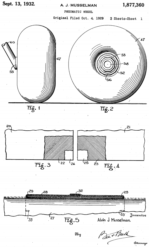

A patent for tundra tires was filed by Alvin J. Musselman in 1929:
At the time, he was working for Goodyear, having been employed there since 1928 when he "walked in" with his design. The company would go on to market it as the "Airwheel". The book The House of Goodyear goes on to state that "[t]he company bought two airplanes, put the tire on test". Unfortunately, it does not state what model the airplanes were.
However, the first airplane "on the Pacific Coast" to be equipped with the tires was the Great Lakes T-2-1A, NR842K, "Texaco No. 6" flown by Larry Cooper. It apparently arrived along with a delivery of first production batch by the Goodyear blimp Volunteer to Sanders Air Service at Clover Field in Santa Monica on 5 October 1929:[1][2][3][4][5]
(Source: Newspapers.com)
