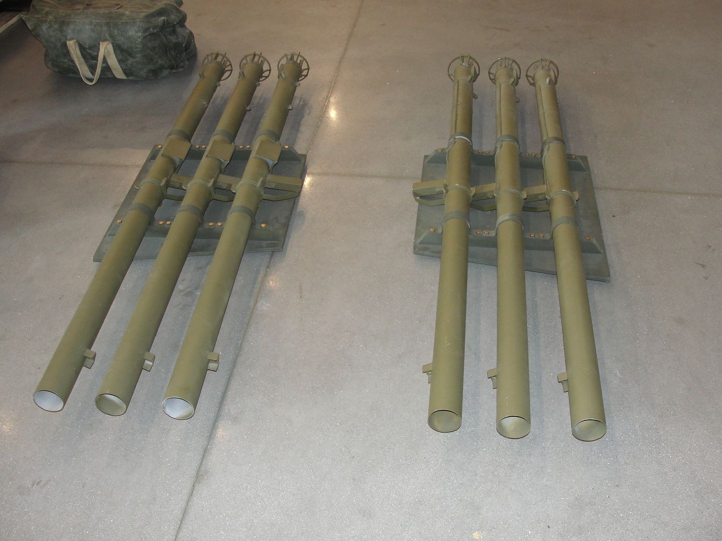

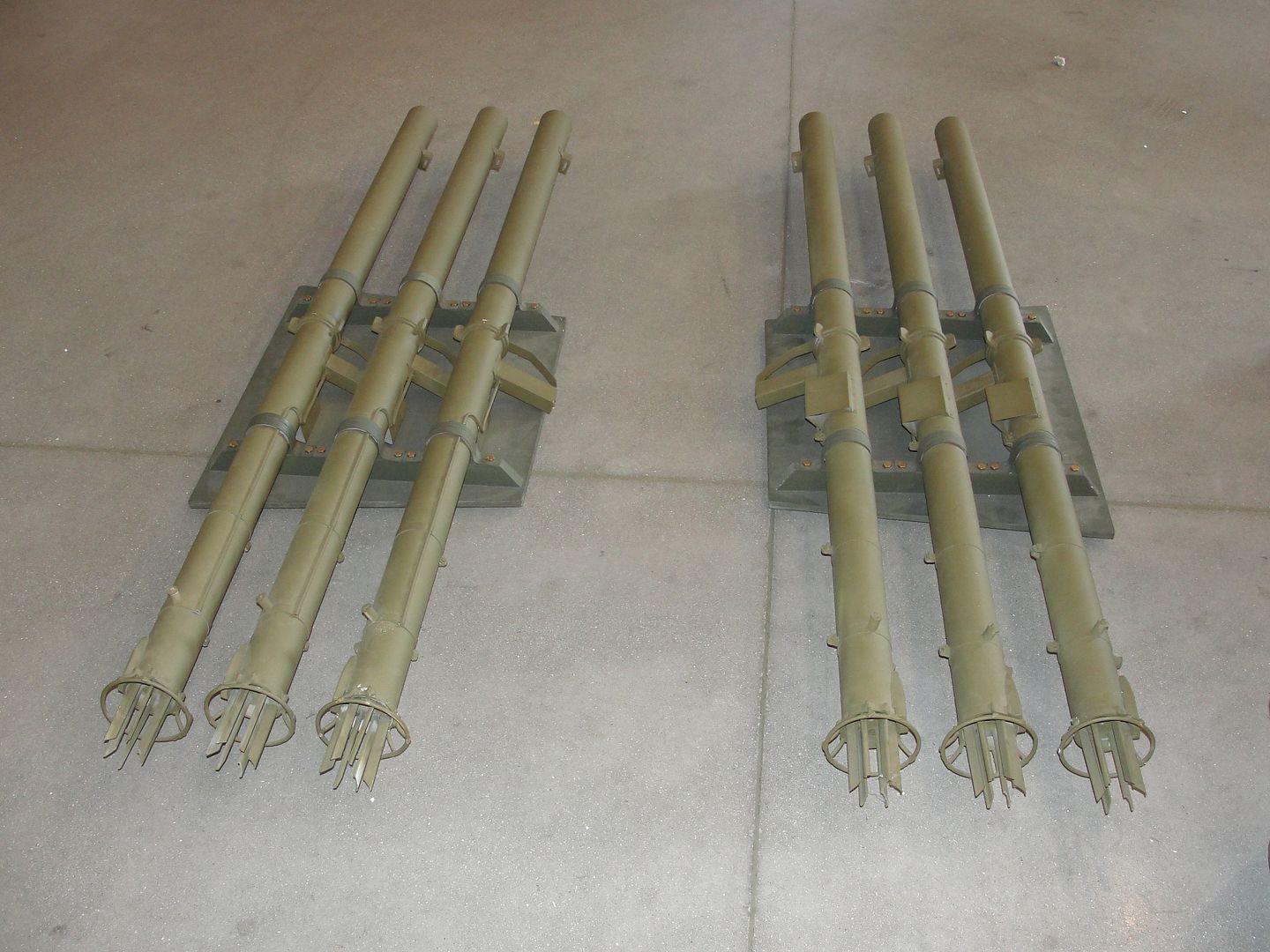

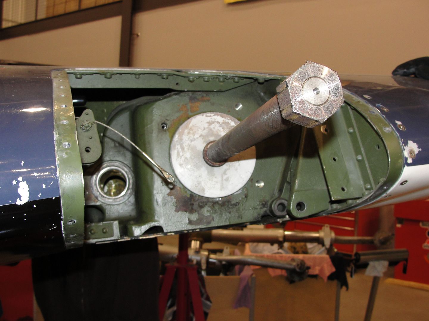

We got a big box of L-4 stuff delivered today-
Among other things were these replica Bazooka tubes as were mounted in the field.
My kids couldn't resist some of the items that came with-

The Bazookas are cool. I'm looking at doing the same to the L-5 in the future. L-5s had them mounted in a triangle wedged between the main struts and the juries. Makes the little birds look pretty mean. Did the previous owner say where he acquired/ how he made the bazookas?

I believe they were made by William James who restored the L-4.
There were photos of other L-4s with them installed along with some how I made them photos that are part of the stuff we got.
I don't know much about them other than that.
Rich

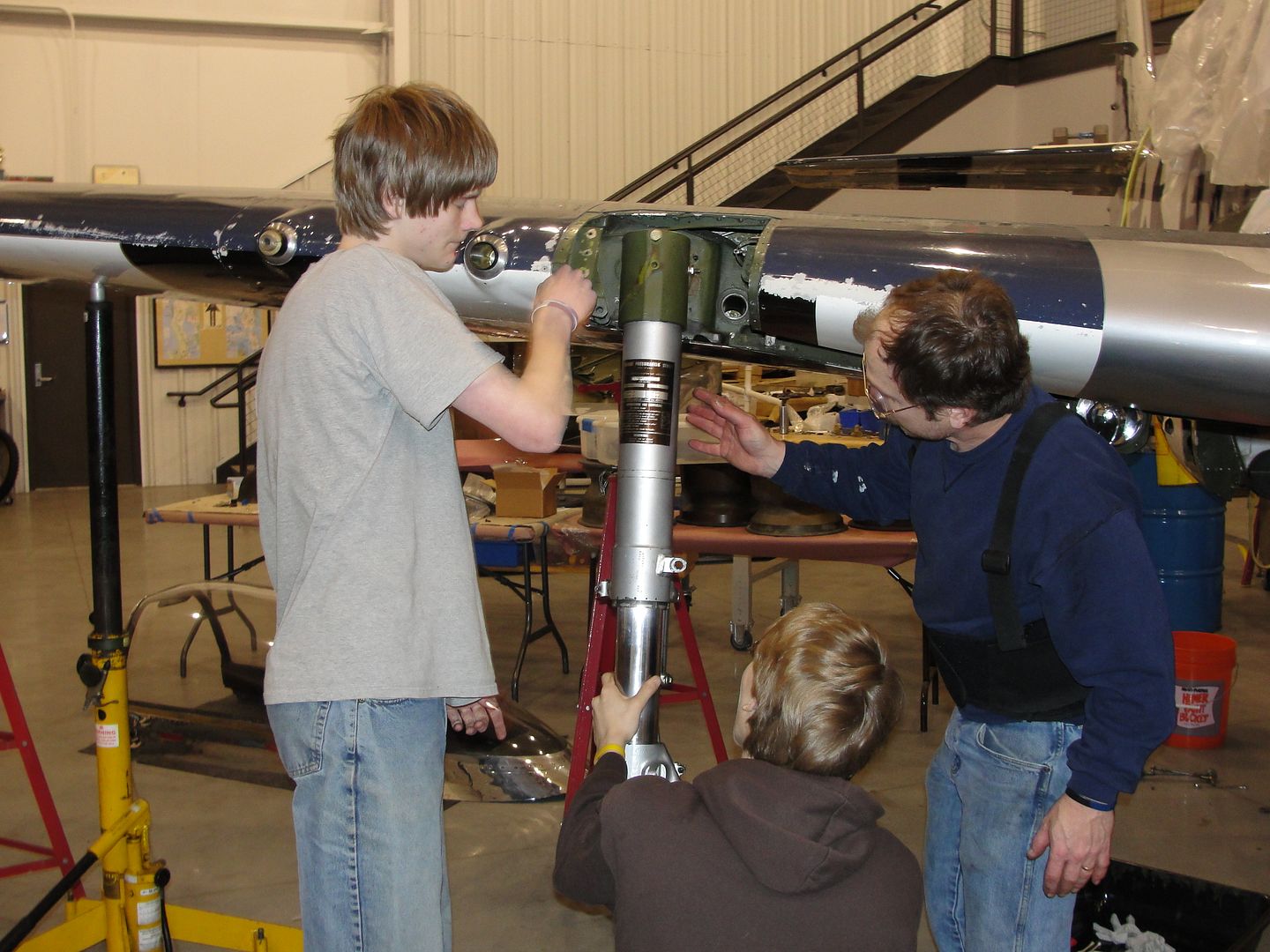

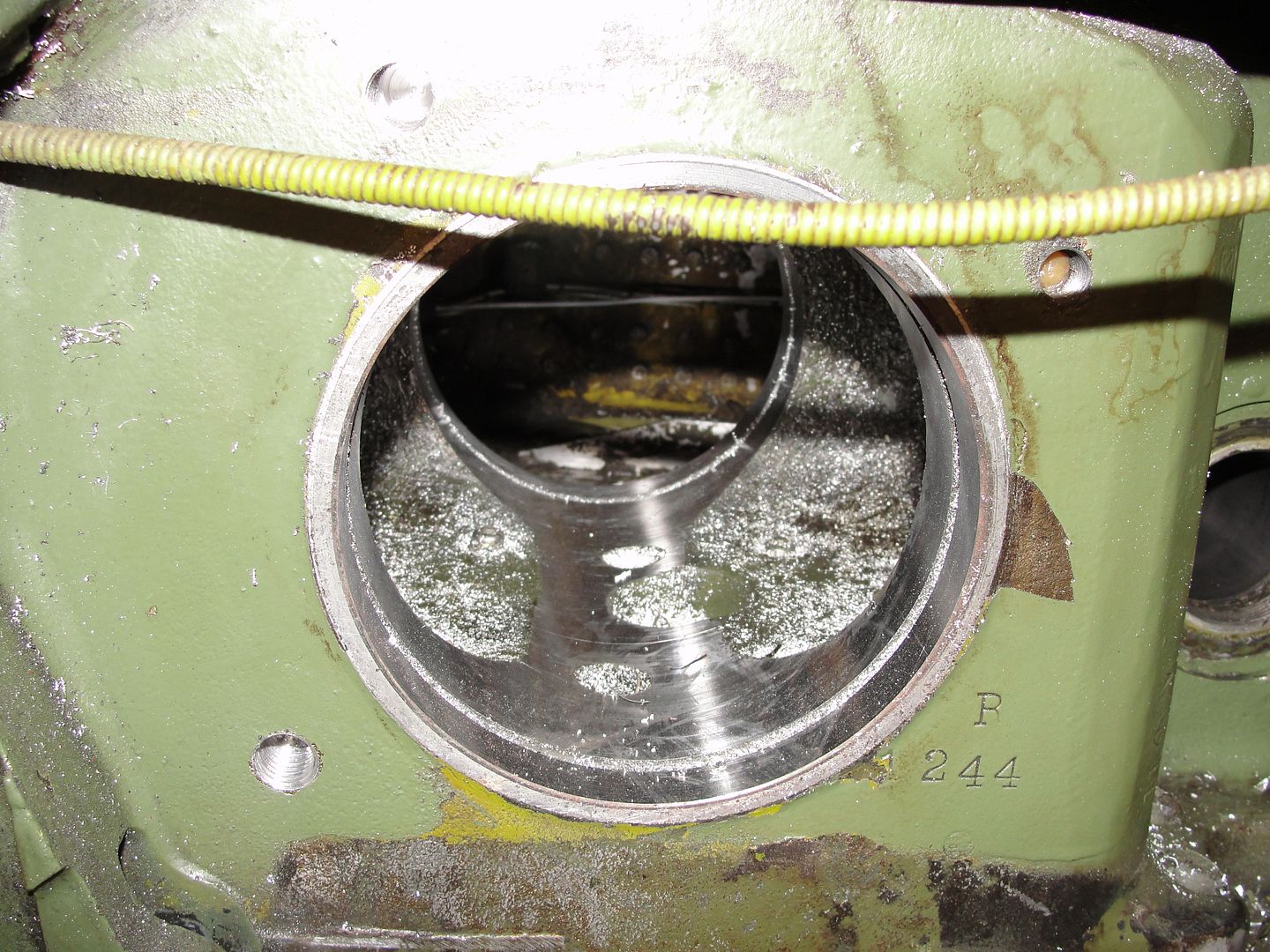

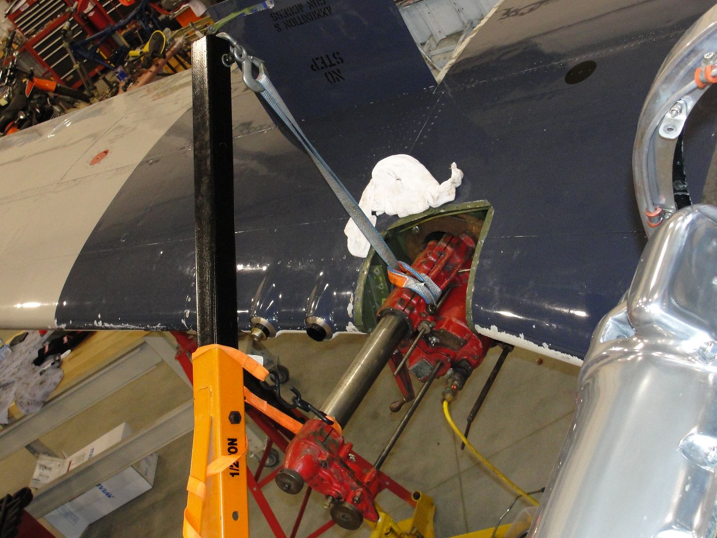

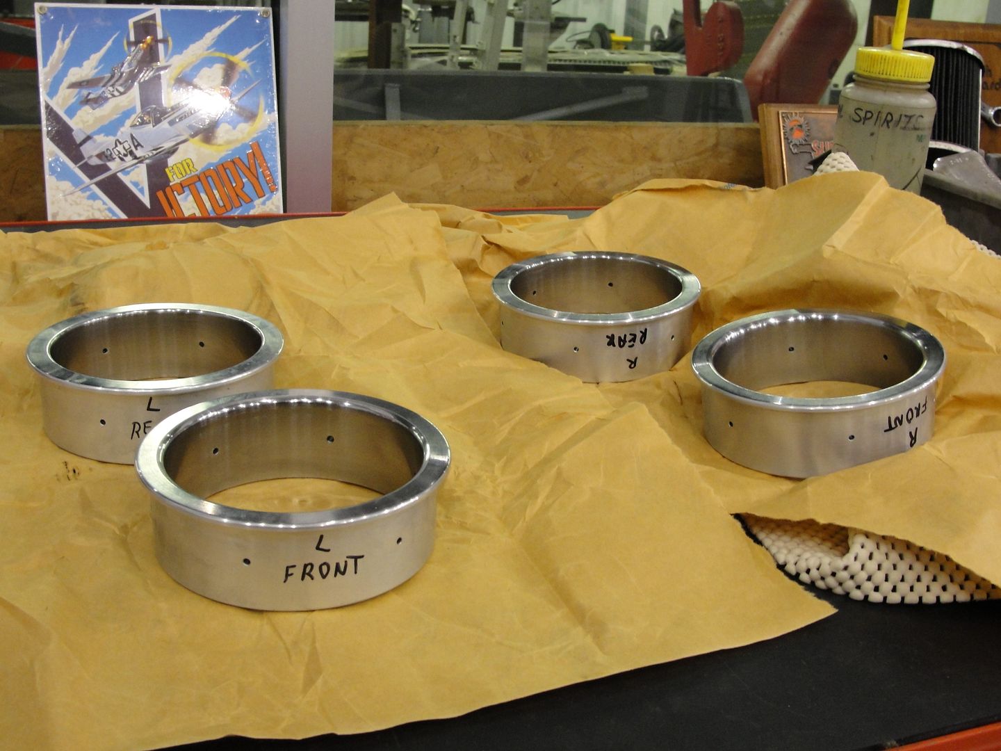

One of the issues we have found with the Mustang is the bushings the MLG rotate in were moving a bit rather than pressed into the trunion castings.
Only one of four didn't fall out on their own.
This series of pics shows the puller being used to remove the last bushing.
Ashley Ezell from American Aero Services drove up from FL with tooling and equipment to fix our gear issues.
This is the Van Norman Boring Bar he brought-
This is the tooling plate that gets attached to the trunion. The Boring unit attaches to the plate and after aligning with the hole the machine clamps tightly in place.
This shows the Van Norman in place-
At this point the Van Norman decided to turn into a fireworks display and render itself useless. I located another boring bar unit near Vincentown NJ after searching through Craigslist at 7pm last night. By 10 pm Ashley had picked up the replacement which is a Kwik Way model.
This morning he had tried it out and we bolted it up on the tooling plate-
A couple shots of the finished bore on the R/H side. Material is mag.
Mounted up on the L/H wing.
Now to get bushings made up to fit the new bore sizes. Than will be a job for Glen Wegman.

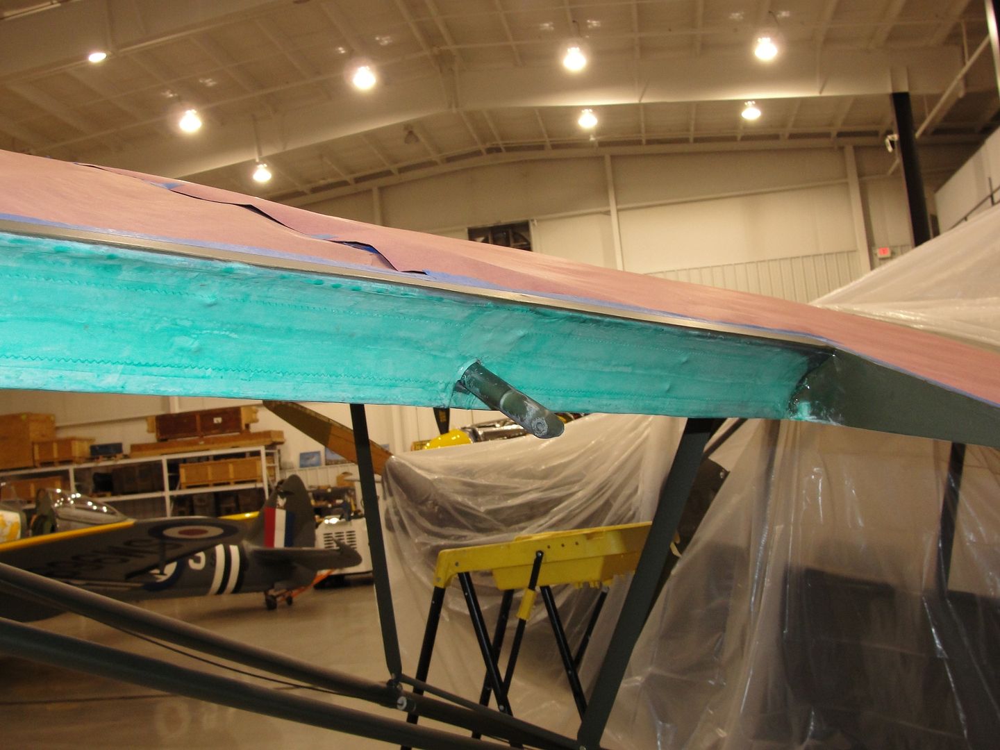

I had an area of fabric I had to repair on the L-4.
About 4 feet was unglued from the false spar fwd of the L/H aileron.

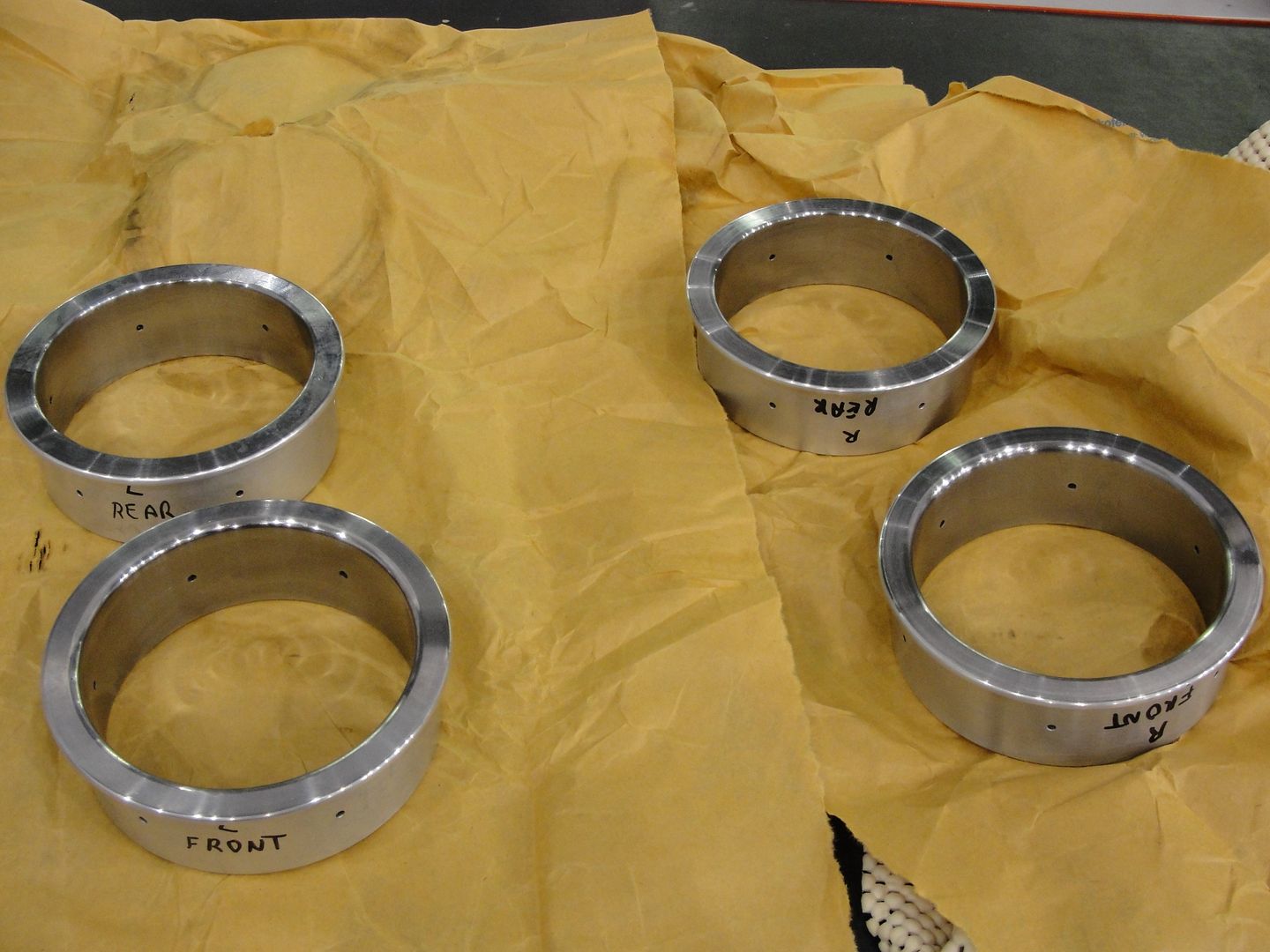

We received the new bushings for Bald Eagle's MLG.
I packed them in Dry Ice for hours and then installed 1 at a time.
1st one pulled in place. The rear L/H side.
Looking aft at the installed rear bushing with driver in place.
Front bushing in place on the driver tool for installation.
Installed.
Secure and shiny.
We then test fit the MLG to check that everything lines up and it does.
Ashley Ezell and Glen Wegman did great work.
