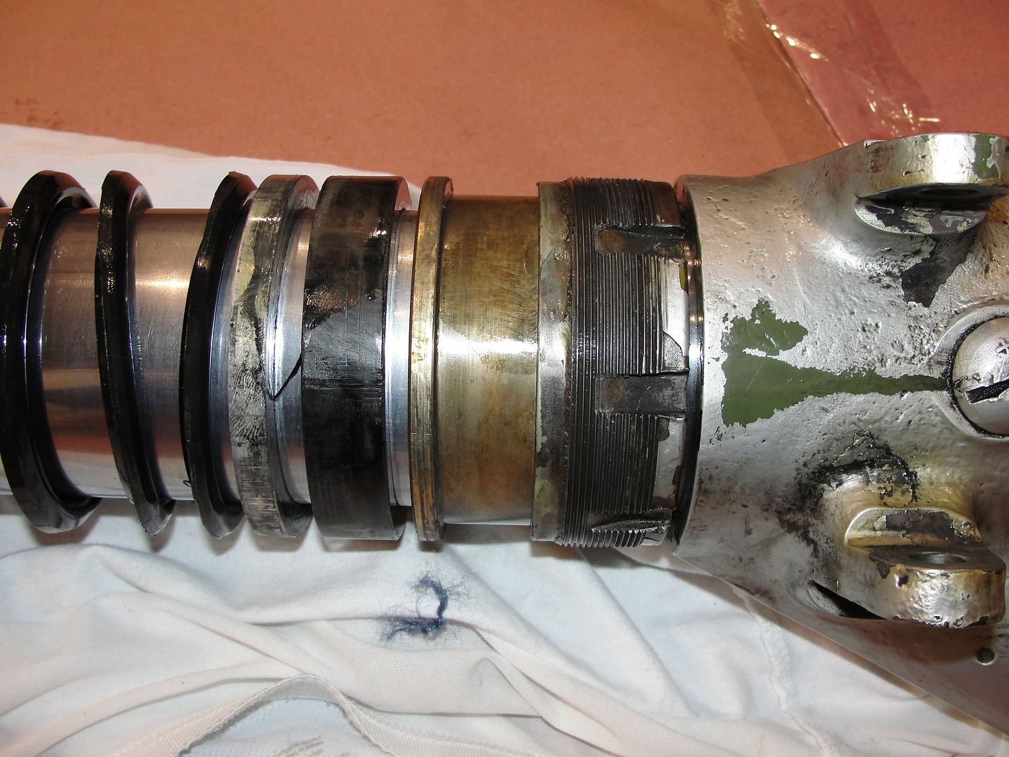

Some shots of the P-51 MLG disassembly-
Scissors separated.
Upper Bearing and shuttle ring on top of lower strut.
Lower bearing, retaining nut and seals on lower strut.
Detail shot of V ring seals.
Upper bearing unthreaded.
Upper end of lower strut where upper bearing threads on.
Pile of parts that hide inside the strut.
Inside of upper strut.

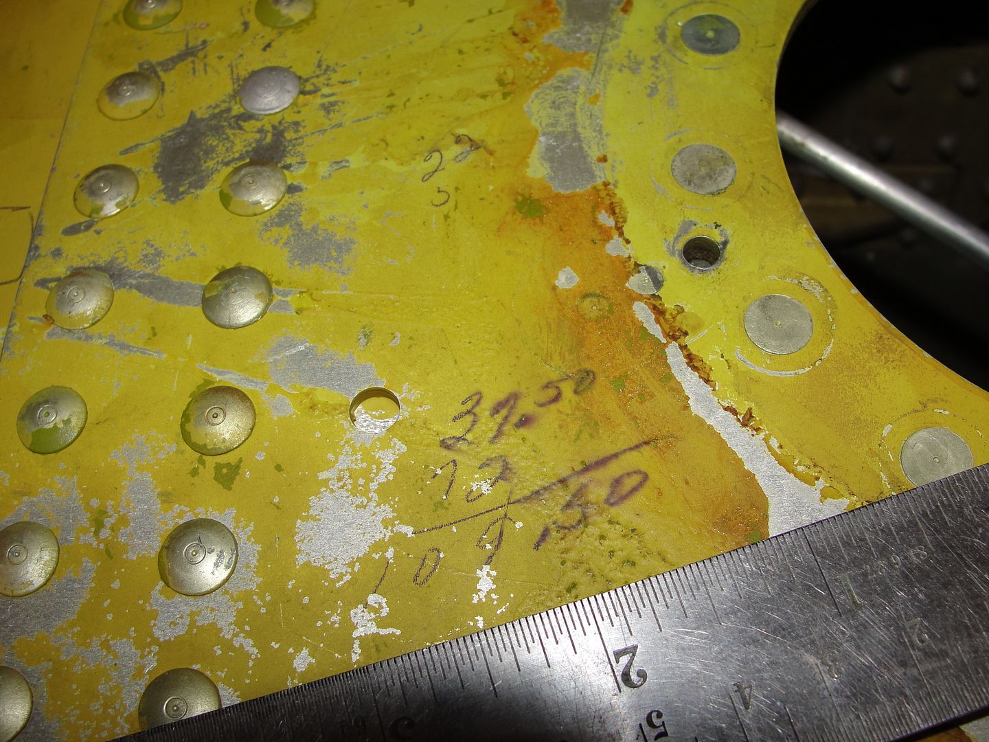

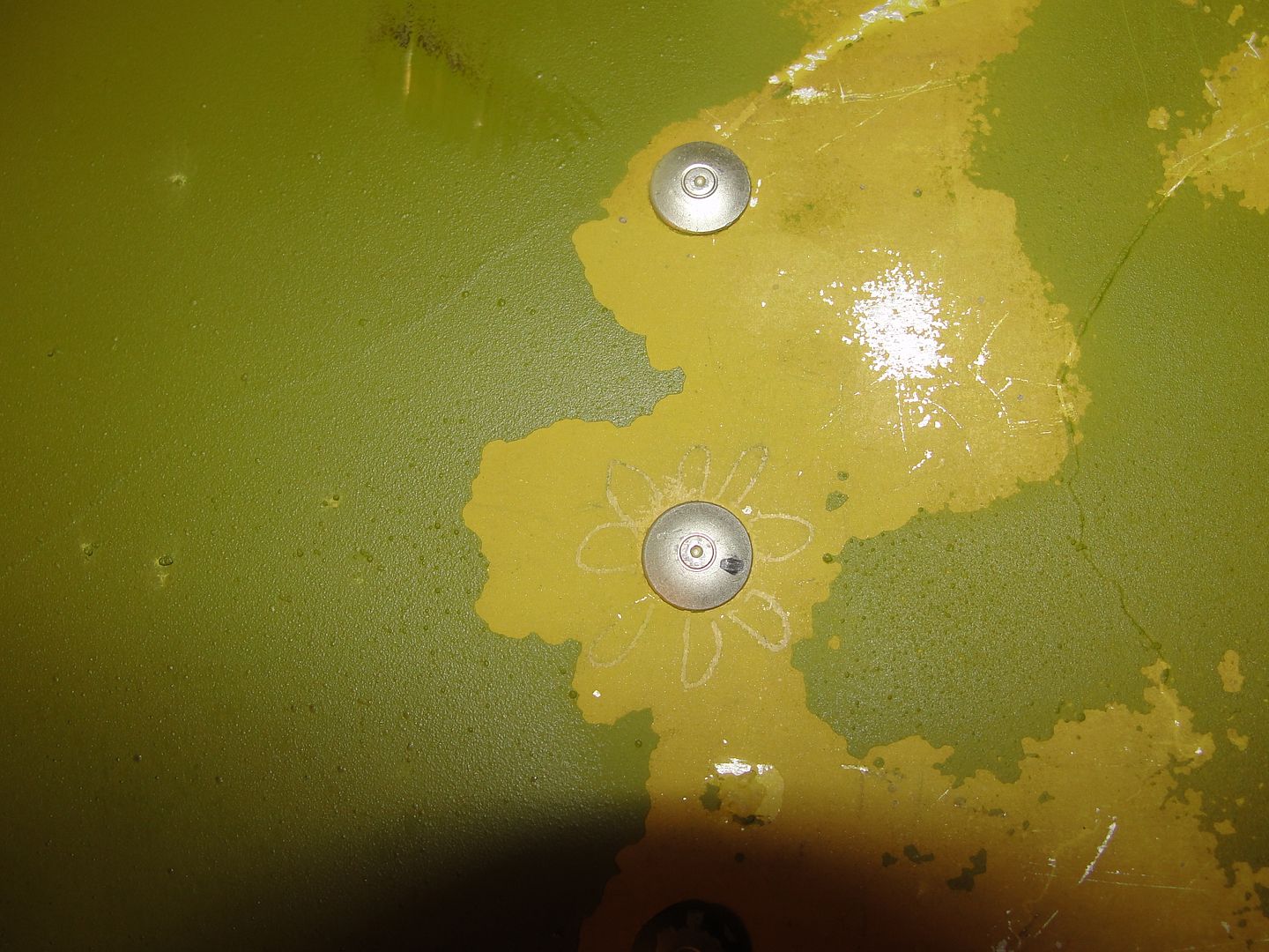

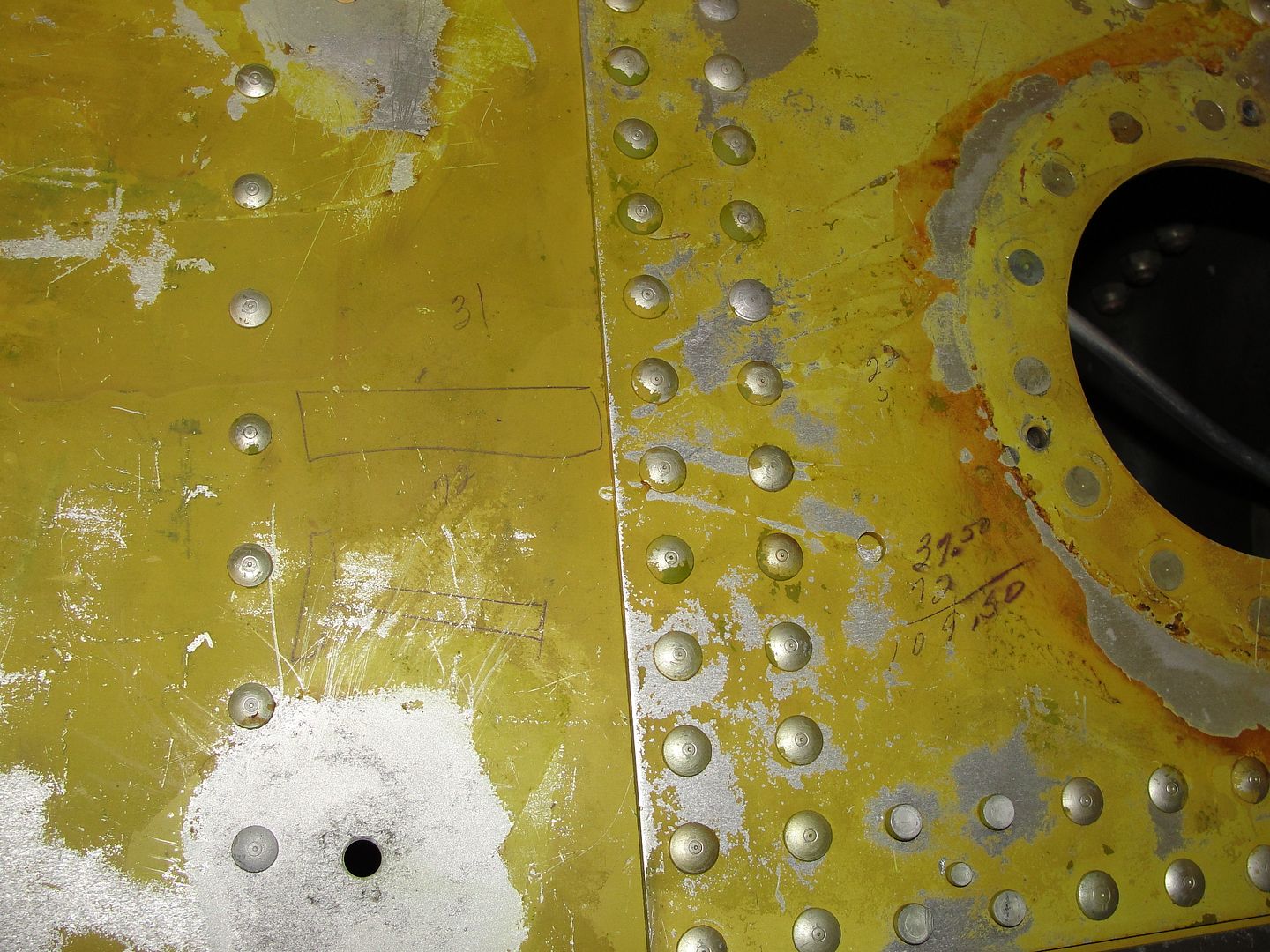

While removing some of the Green paint applied back in 1980 during a rehab of Bald Eagle we found some workers artwork-
This is the back side of the main spar in the R/H fuel cell compartment.
I've heard of Flower Power, but here is the Flower Rivet-

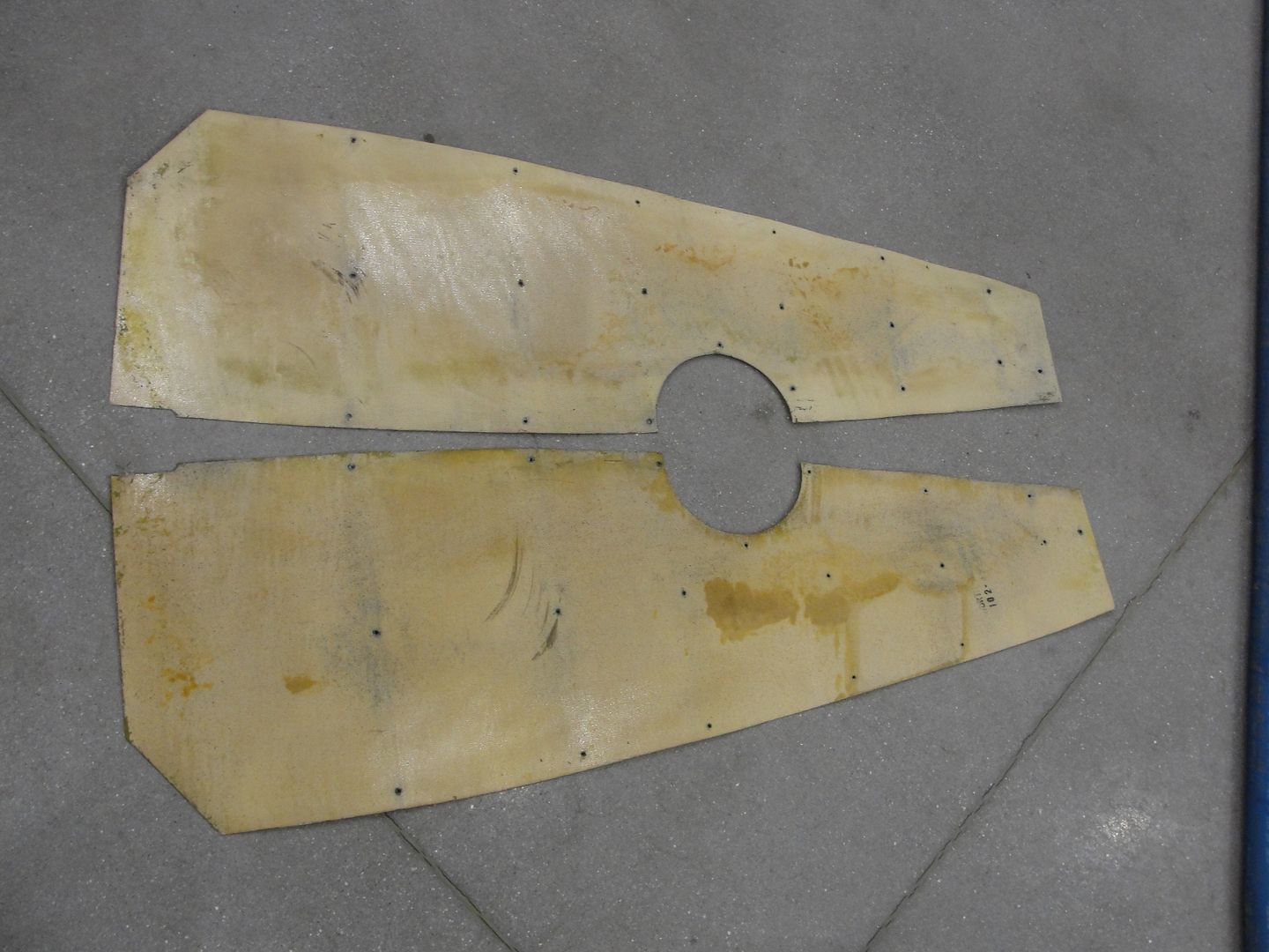

P-51 fuel bay liners. These are an early resin/fiberglass material made in sheets.They had green overspray on them which I used the low pressure blast method to remove.
It didn't seem to erode the liners but did remove the overspray.
I already did one in the pic.
Both done.
