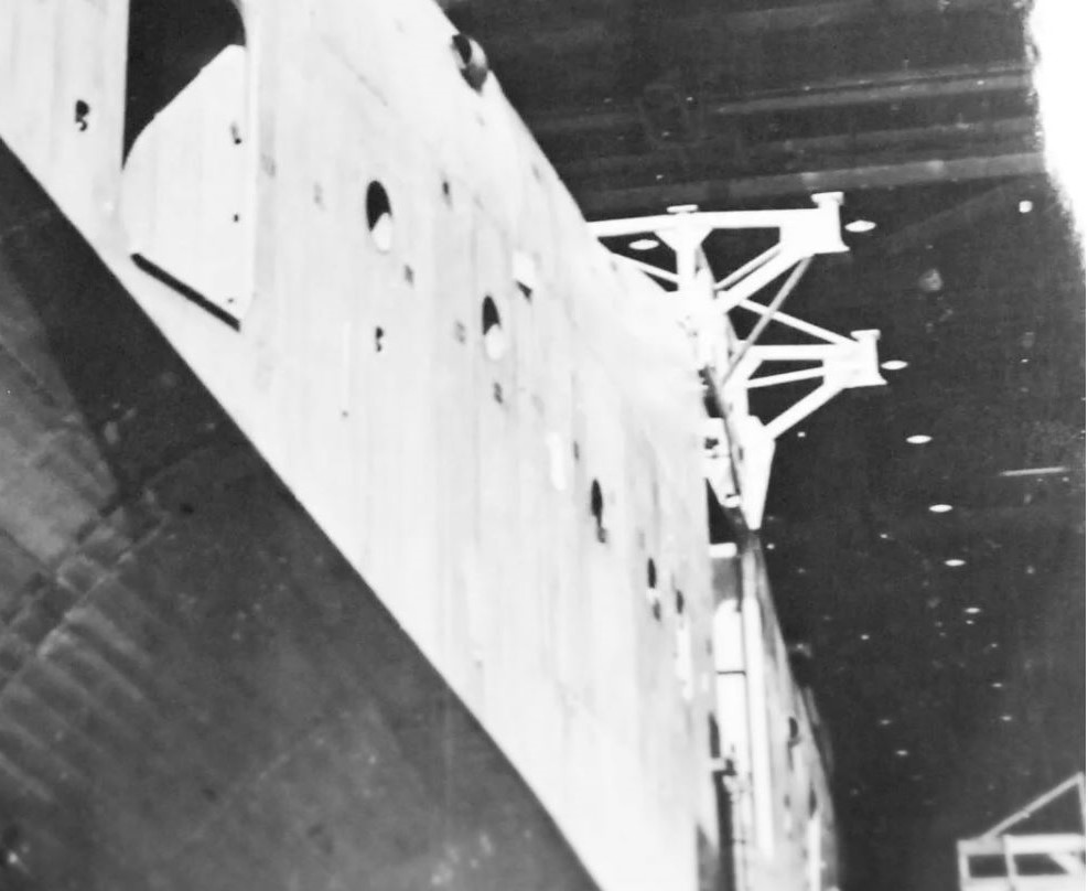

It looks like when the wing center section is removed, a supporting structure will need to be fabricated to support the fore and aft fuselage. No matter how they do it, it will be a substantial undertaking. Good lick to Pima!
C2j
