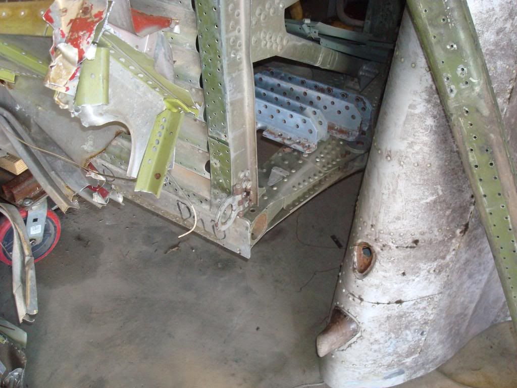

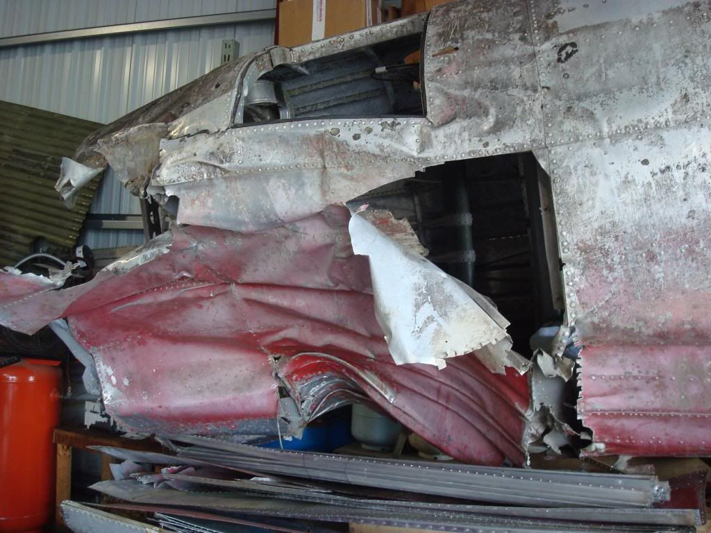

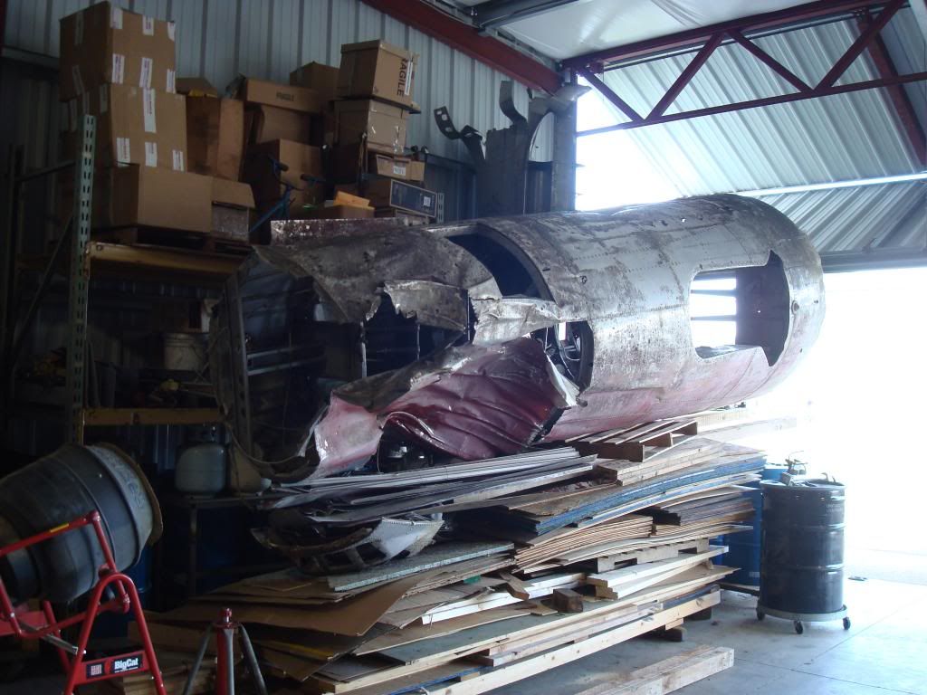

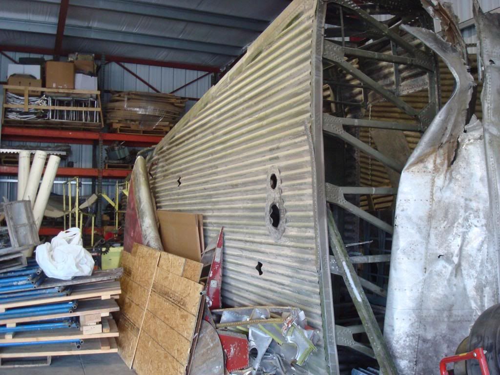

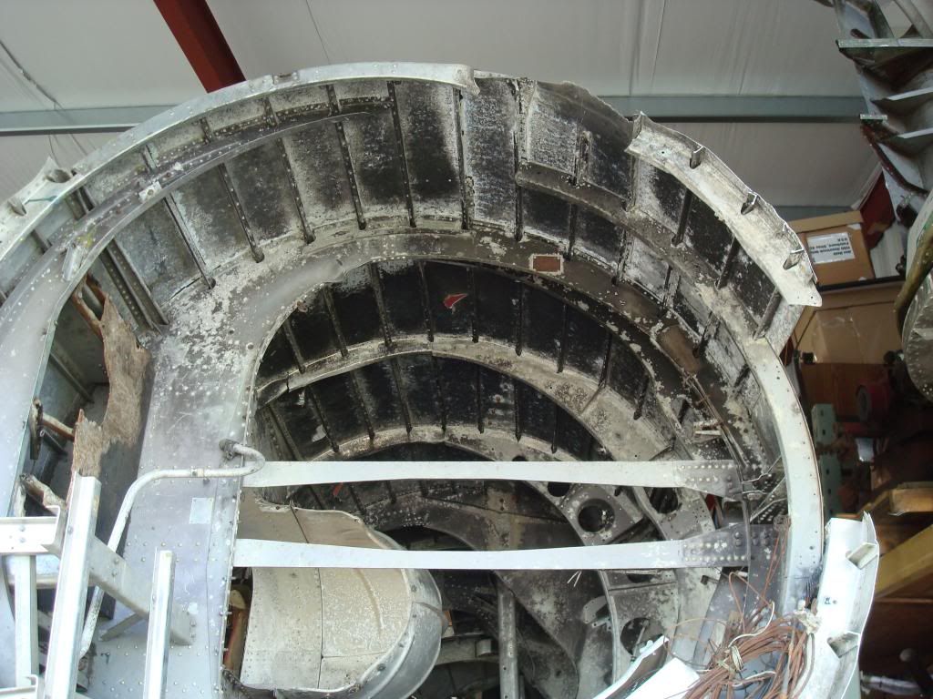

The museum also has a T-hangar at the other end of the field, and stores parts not being worked on there. The left wing and also the remains of 44-85505 recovered from Alaska are there. During the 70th Raider reunion it was open and i snapped a few pics. (I have been lazy about updating photos to my Photobucket account.)
44-85505`s tail:

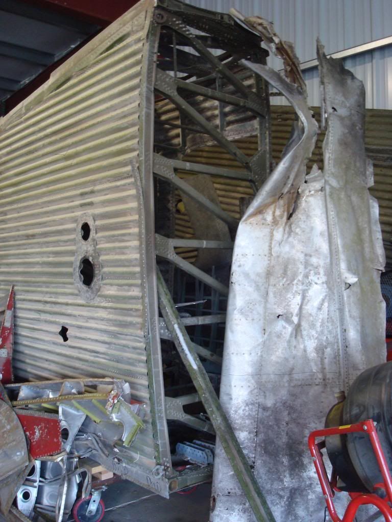

44-85813`s (Champaign Lady`s) Left wing. Outer skin has been removed. Red or mangled aluminum is from 44-85505.
Detail of lifting eye. This would be aft inboard. The attaching clevis would be in the hole directly below it.

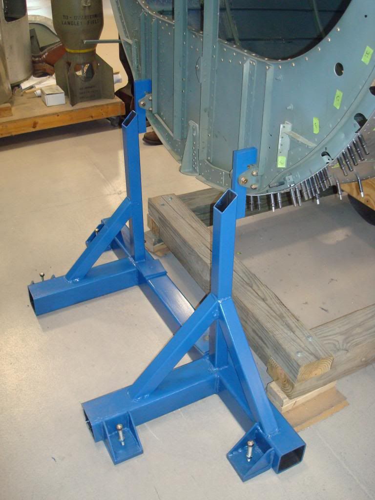

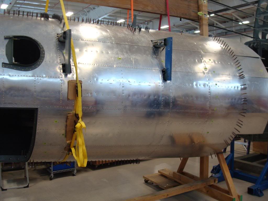

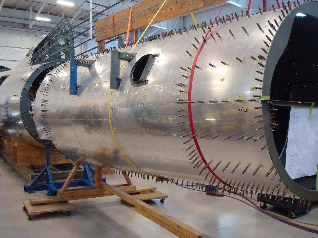

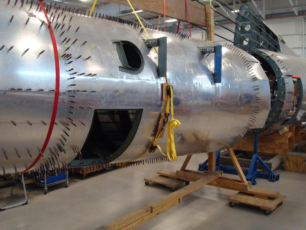

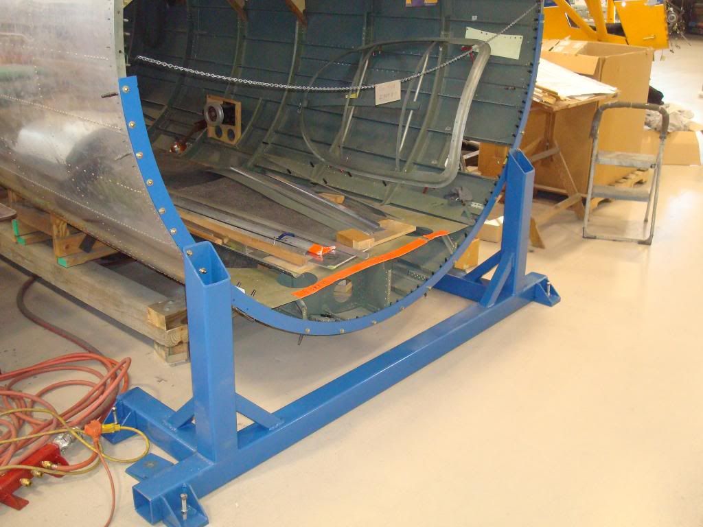

New update from Urbana. The two major aft sections are still apart, but the skin is almost entirely riveted on. It is easier to do it now rather than later with the tailwheel boot, support structure, etc to work around.
There has also been a new support fixture built for the aft end. The front indexes off the fore / aft attach points and the rear off the tailwheel mechanism.

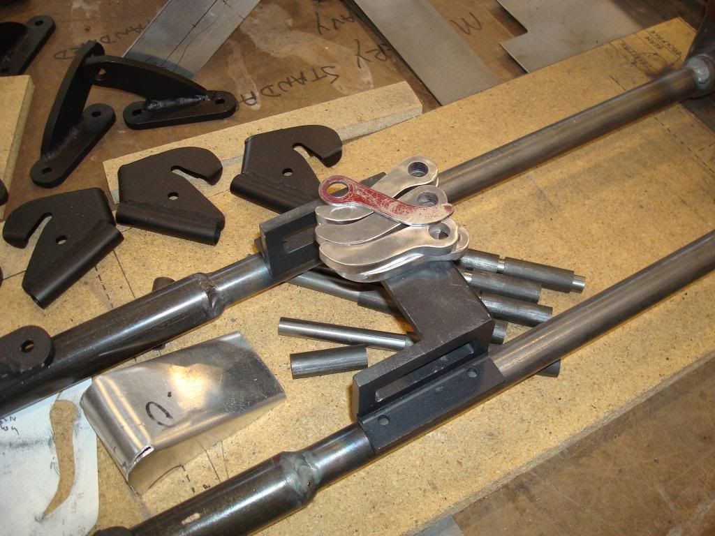

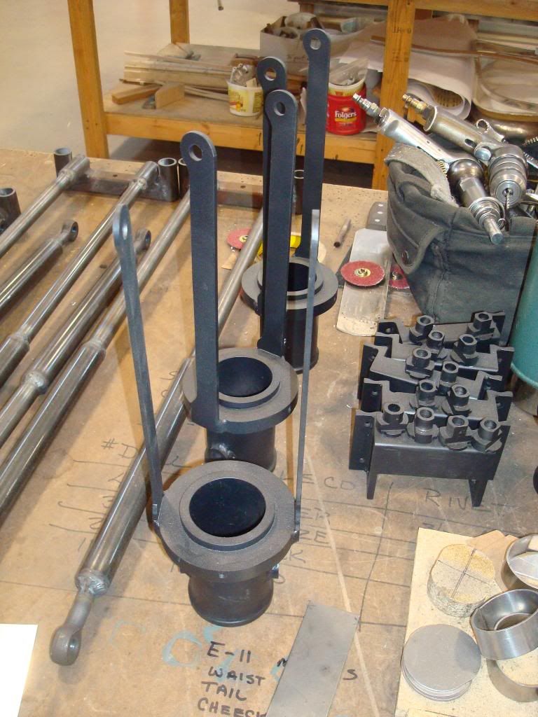

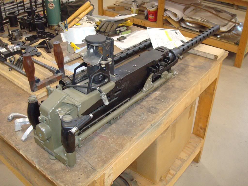

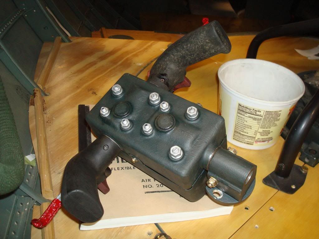

And an E-11 recoil adapter assembly line. A genuine one off the museum`s B-25 served as a pattern.

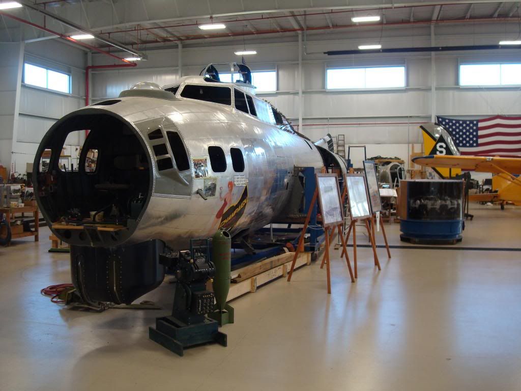

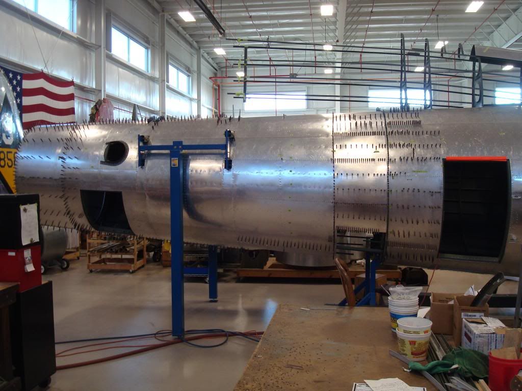

January 9 - fuselage sections come together for last? time.

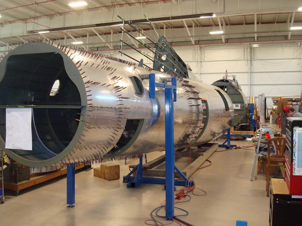

From the looks of things, the tail has come together once and for all.
Nose to tail shot:

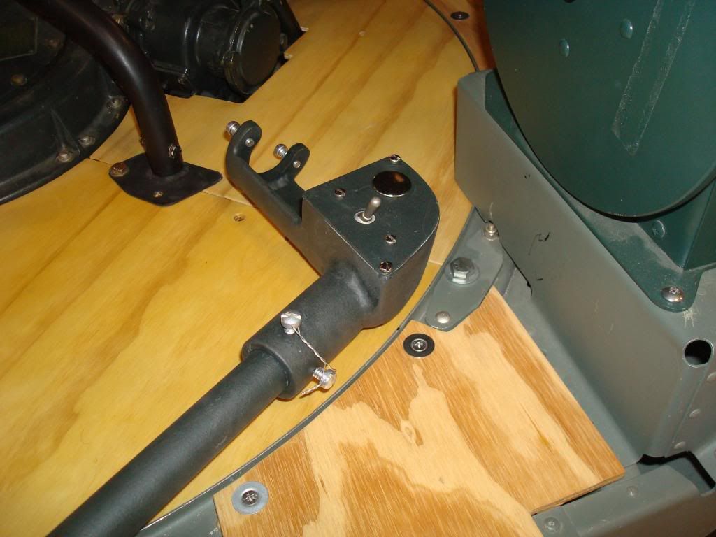

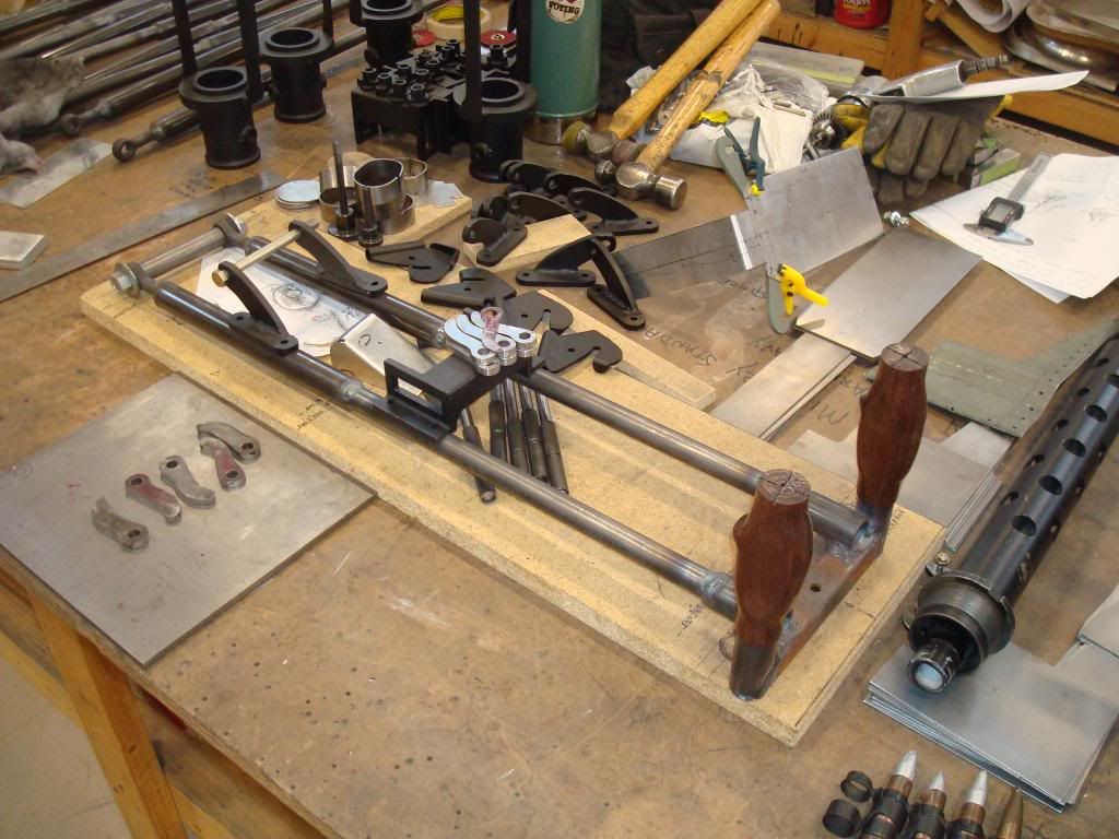

Controls for the chin turret:

Ready for action!
