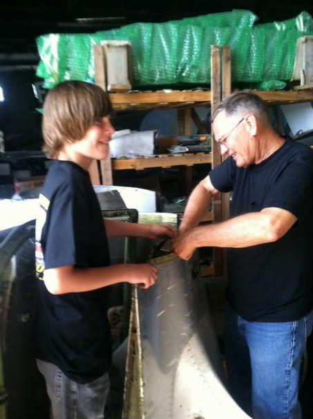

Posts: 2563
Dave L. and grandson are cleaning up the tailcone and getting it ready to go back on. I like that part. Going back together is the best part!! First, we have to finish the repairs to the vertical stab and horizontals, the base of the tail below the rudder and then we can hang all of these, the rudder and gap seals, then the elevators. Ahhh, light at the end of the tunnel. :-) JR

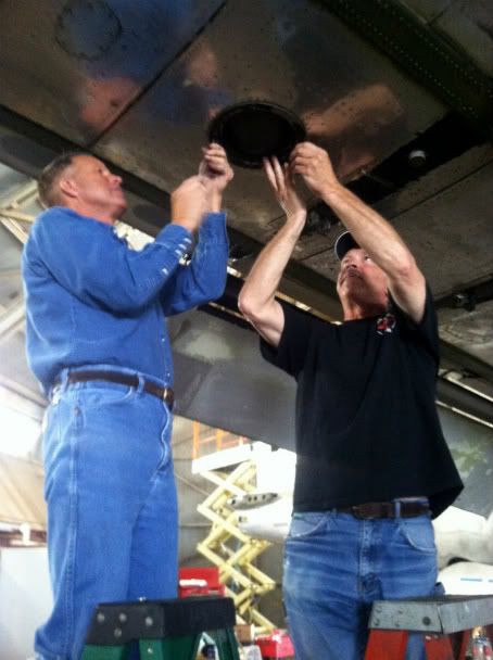

Posts: 2563
David A on the left and Tim on the right cuss and discuss that danged ol landing light that won't cooperate. It will extend and then not retract. Don't you just hate that?? Maybe with the rewiring and clean up of some of the parts, it will decide to cooperate. We need to find a bulb to go in the unit as well, but won't give it to the guys until they are thru banging on it for obvious reasons!! JR

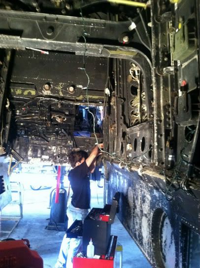

Posts: 2563
Here is our very own Amy trying to convince the last bracket on the forward hinge of the bomb bay door to cooperate. I guess it does not realize that she passed her o and P's this week at TCC. We congratulate Amy on her grand accomplishment. Mark is up to bat next week and we have no doubt he will also do well on his exams. BTW, ever wonder why the A-26 bomb bay is so long?? Seems the Navy suggested that the new WWII bomber should be capable of carrying two torpedoes. It never did that we can find a record of so far. Anybody know of an instance? Also note the cutouts in the doors on each side. These were for camera ports. All but one of them has a sheet metal cover installed to cover it. Would like to find at least one original camera to install in the bomb bay. That would be kewl. JR

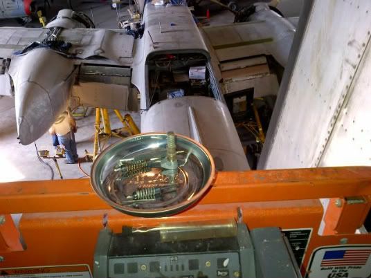

Mystery Part - Hopper associated with the Oil Tank........you have one too??????? I had one in my car yesterday morning (sometimes things need to be fixed offsite)....but thankfully it's back where it should be in the plane.
Oh wow, Duck Drivin Lady, you are so very close. Yes, we have one, but the picture is of the one that came out of the big black airplane that you love and hold dear. But the name is... well, not quite there. Perhaps if you explained what it does in the oil tank, we could name you the winner!! :-) JR

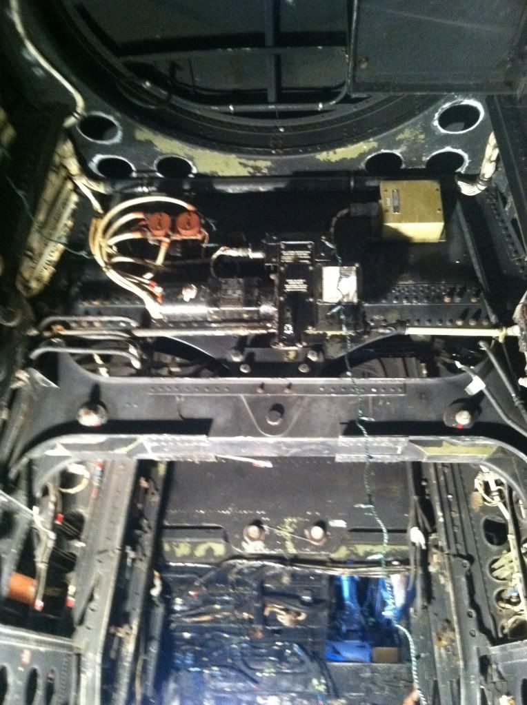

Posts: 2563
Another shot of the bomb bay looking foward... can see the two wing spar carry through structures. The aft spar in the foreground is what OnMark and others changed to a ring spar so the bomb bay could be made into an executive cabin. That was a difficult piece of engineering back in the day without fancy computers or even hand held calculators!! Hats off to Mr. Denny and company! JR

Location: way down South
The hopper or hopper assembly aids in warming the oil when starting cold IIRC. As the little black plane has the opposite problem with oil temps, I was happy to bring the "stove pipe" back to the big black one.... :lol:
Oh so you had the "inside" information, as it were. Yep, this little jewel recirculates warmed oil back to the engine after start until the rest of the oil in the big, huge oil tank can be warmed. It sorta speeds up getting the engine going while waiting for the other oil to catch up. Just about all the big radials have this situation. The B-25 for example, we have to wait until we see 40 deg C on the oil temp gauge before bringing up the power even a little bit for taxi. It sometimes is a race to see if the oil temps can come up before the cylinder head temps get too hot on a warm Phoenix day. Anyway, it takes quite awhile to warm up 30 gallons or more of 60 wt oil per engine. Just remember if it ain't drippin oil on the ground, it is out of oil!! :-) JR
