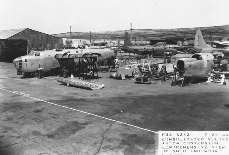

Another one of the obvious external differences besides the shorter nose section is the engine cowlings. The early B-24A's had round cowlings where as D models and later had the eliptical cowlings with the intakes on either side. Also, the D had the upper and lower gun turrets where the A had the gun positions that Gary has been showing us as he creates it for 'Lil.

Weren't the Lil cowlings - make due at the time - PBY cowlings?
A couple of questions...
Where was this photo taken? ( great photo! )
and what is the airplane in the back ground?
I'm not 100% sure, but it looks like the one and only R2Y Liberator Liner.

It looks like a long Privateer with no turrets, OD paint, and an early model (no nose turret) nose. Did they make transport Privateers?

Airdales I think you may have it!

The OD Privateer without turrets is an interesting piece too.

That OD Privateer IS interesting. Even the XB-24K which was a B-24D model with a B-23 tail grafted to it to start the Privateer line had the nose turret on it, as well as the typical D model engine cowlings.

AHHHH found what that one is. Is the RY-3 Liberator Express. It is the transport version of the PB4Y-2 Privateer.

Sasnak wrote:
Connery,
Actually, I think it's actually this one: http://upload.wikimedia.org/wikipedia/e ... ed_R2Y.jpg
hahnej and I were talking about the OD Green Privateer without any armament that is in the center of the photo.

I actually remember the R2Y because I think it was available as a model kit in the 1970's from Matchbox, unless my mind is slipping.

Matchbox did the PB4Y-2, the only actual kit of it made, not sure about the RY-2 though.
