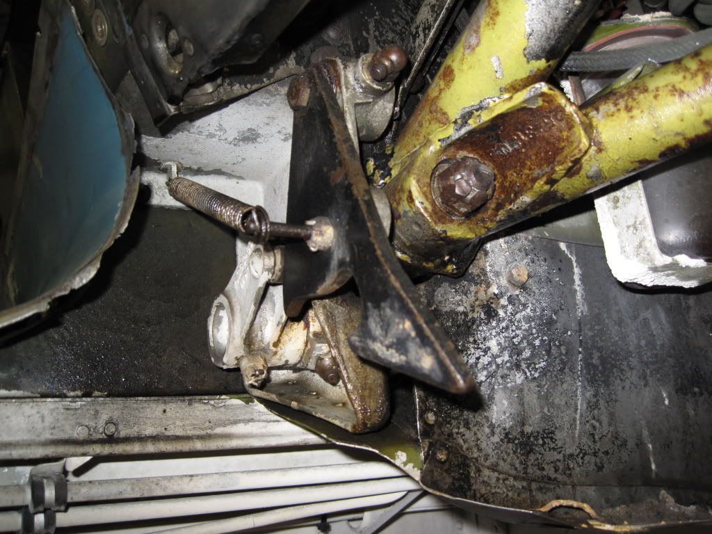

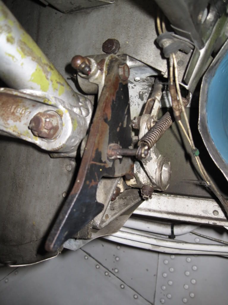

PostPosted: Thu Mar 12, 2009 6:07 pm
Posts: 11332
The uplock hook is made from steel plate, the uplock arm torque-tube support trunnion and arm castings are aluminum.
The SNJ-2 has the uplock hook pivot bolt farther foward (maybe 1-1/2") than the traditional T6/SNJ configuration, as well as the odd link from the arm to the uplock hook. The traditional T6/SNJ configuration has a roller in the arm that rolls directly on the uplock hook.
I had to dig into my photo reference archive for this and never noticed the difference before! Now I'm curious which style the Wirriway has- or if it is yet another variation.
SNJ-2:
SNJ-4:
