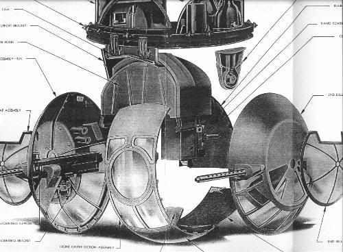

I'm almost certain this is the ball turret owned by the Stockton Field Aviation Museum. If memory serves me correct the museum managed to find this complete NOS turret still in the original crate. :shock: They made a support frame and mounted it to a tow trailer which is exactly like the ones used by AAF gunnery schools. Where they found it is anyone's guess.
As for my project...it will be a number of years yet before I'm even close to what these guys have. I have most of the internal components except for some gear assemblies, etc. The main problem I have is trying to find those darn shell pieces which are virtually non-existant. Since they were made of aluminum alloy they were highly prized by the scrappers after the war. The shell parts I acquired from Ed Kaleta were pretty much beyond salvage except for a few items like the armored gunners seat. If anyone out there comes across any you know who to call! :wink:

I think in order to make a ball turret shell, you need to know how to cast aluminum.....which really has nothing to do with what Gary has been doing. It would be nice if it were a simple sheetmetal structure, but I think the majority of the shell is cast aluminum.
Ah, but sand casting aluminum is yet another neat skill that can be done fairly easily on a small scale run. Make wood positives of the shells, make a large wood casting box and purchase some casting sand.
Little study here and there and it is possible to do it, and would make a great home project.
PostPosted: Tue Feb 13, 2007 9:08 pm
Posts: 1493
Correct...the shell components are made of cast aluminum. It can be done and has been done before by at least one turret restorer. The problem you run into is the shrinkage factor with aluminum. It you have a recast turret shell and try to mix in other original parts they won't fit due to the shrinkage problem. There's also the problem of convincing a museum or somebody with a complete turret shell to disassemble it and have bucks made for a mold. :?

HE HE :wink: Harlan Aveezie has had a few cast but its not cheap. To try and cast them yourself is a bit of a challenge. #1 Sand casting takes a special type of sand, correct moisture is a must, too dry it will crumble ,too wet it will explode :shock: #2 These are large castings you must be able to melt enough aluminum to make it in one pour. You have to melt at least 15% more and have a furnace and crusable large enough for the job. #3 Do'nt make your cope and drag [the box for the mold] out of wood if you have a leak and molten aluminum contacts the wood you have a instant fire. #4 Protective gear is a must,it will burn through your clothes , shoes, or skin in an instant. To sum it up leave it to the pro's you will get a better job and the money you spend will be way less than doing it yourself :idea:

Hey Mike...you guessed the right person. :wink: I believe Harland had two castings made but unfortunately the molds were never saved. :cry: I remember asking him how much it ran to have the castings made and if I remember correctly it was about $7,000. :shock:
Here are some pics of the turret items I currently have. As you can see I have most of the internal power unit complete. The electric motor is missing but one is arriving shortly along with an armored bottom section which will go perfectly with the armored seat I currently have. You can also see how thick the aluminum shell pieces are in the close-up. The shell is 1/4 thick aluminum!
